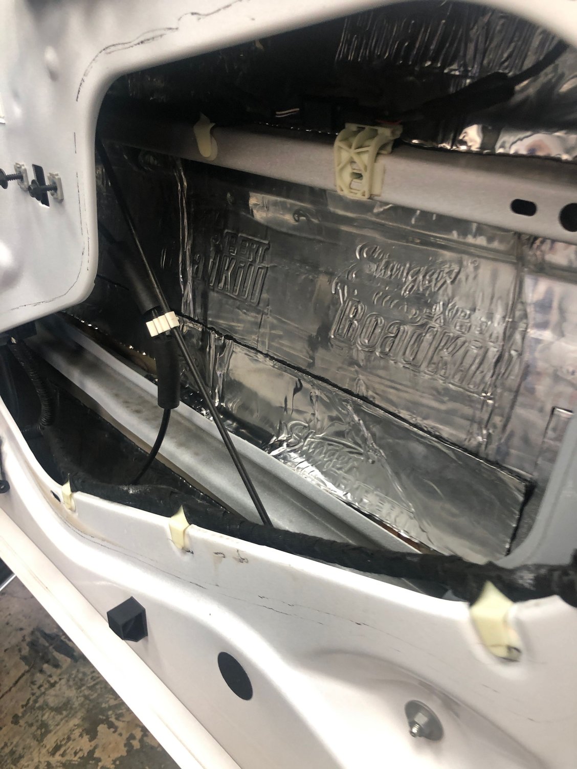

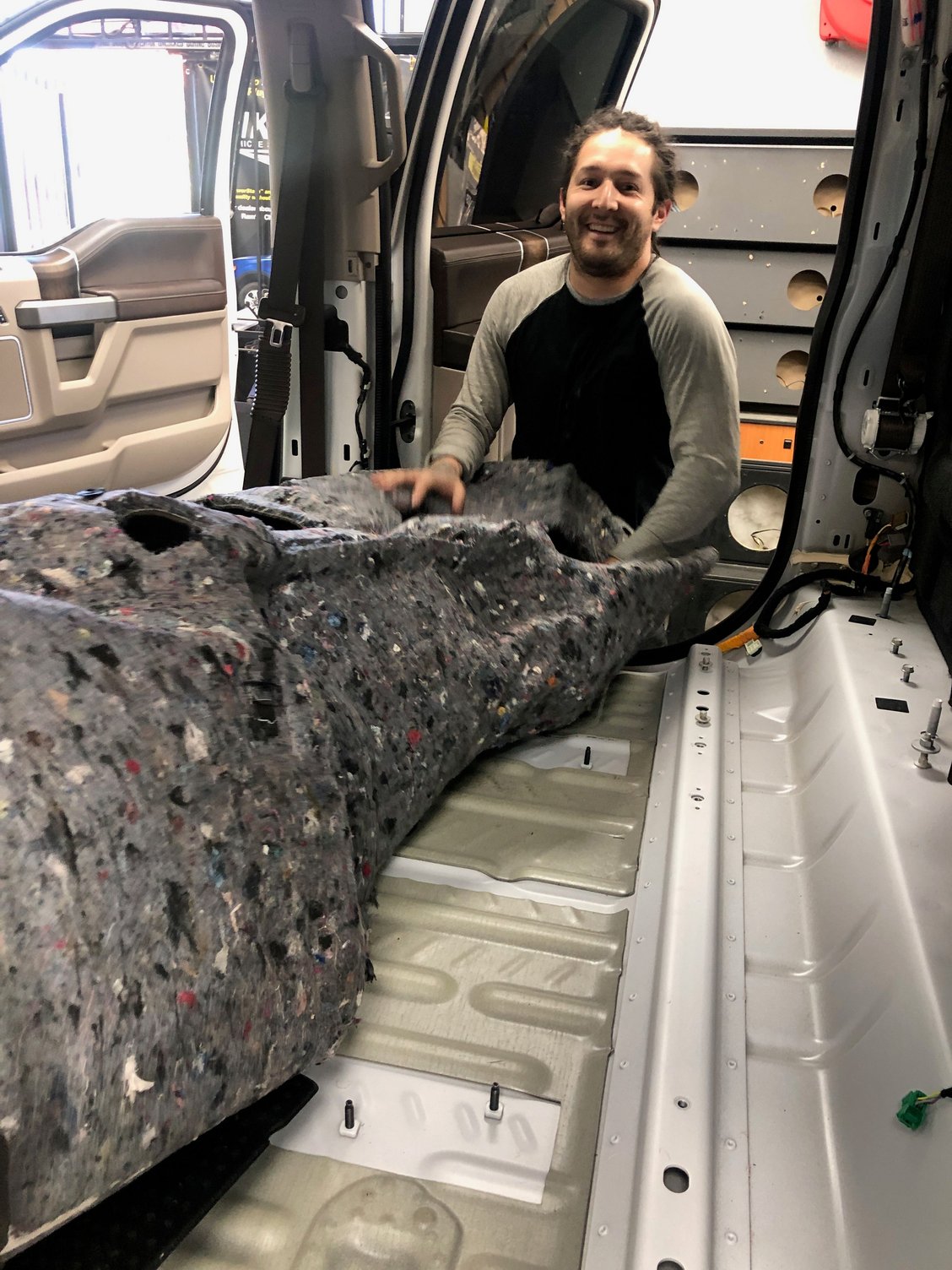

Here are a few initial pictures of the sound insulation/vibration reducing layers being applied. WIll update as I get more pics.
Front door
Rear door
Old Nov 12, 2019 | 10:12 PM

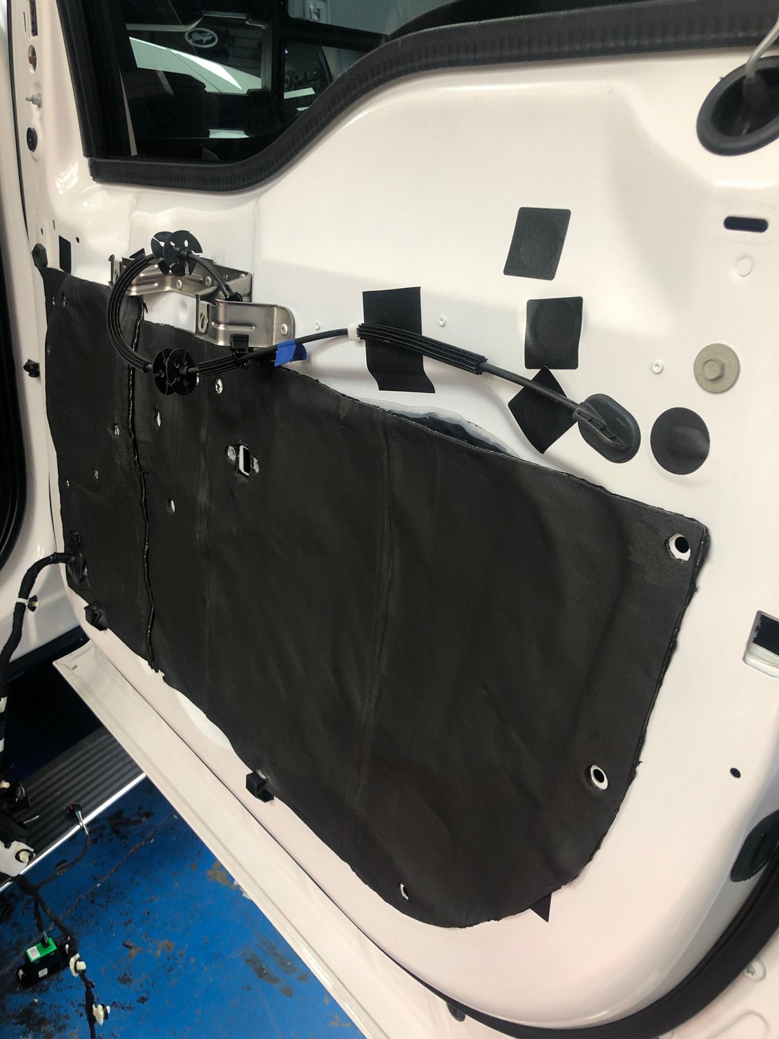

Best advice I can give you is make sure they replace and seal the vapor barriers on the doors completely around with butyl sealer or you will have water leaks into the cab.
Thanks for the advice. Absolutely. They were aware, and told me that there were some adhesive gaps in the original factory vapor barrier seal that were corrected when they rebuilt the doors. This truck originally had a leak because the drainage tubes for the moonroof on the driver’s side hadn’t been connected at the factory. I was nervous about having the whole truck broken down, but I’m also half convinced they’re more likely to put it together with more care than was done at the factory. So far, so good.

Vapor barrier reinstalled and door sealed for better mid bass etc.

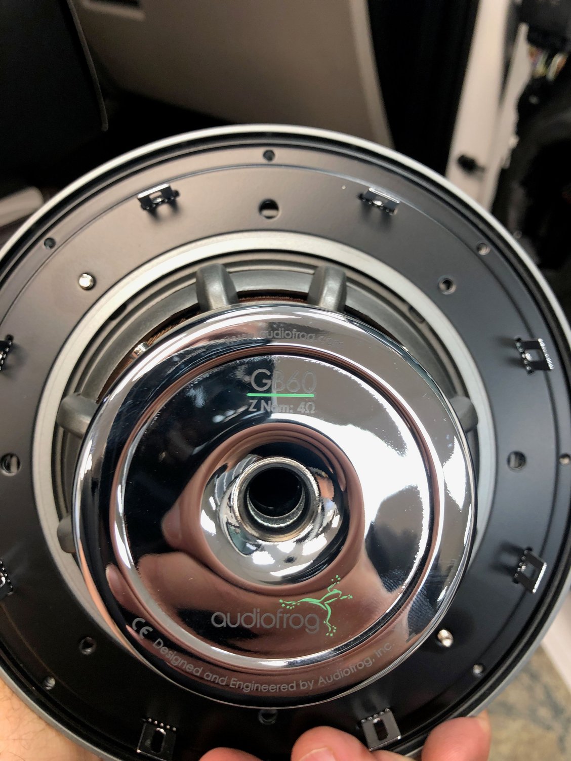

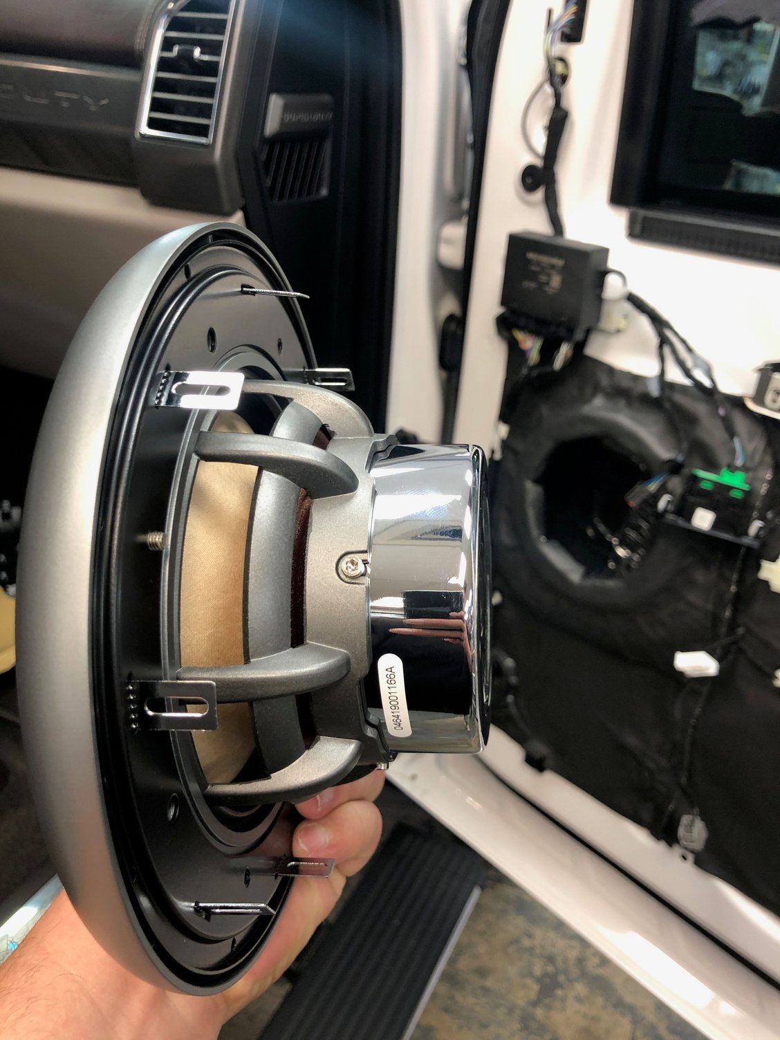

Front Door GBs going in ....

Doors done .. now time to take everything out and treat the floors firewall and rear, and install power, subs, and amps ....
