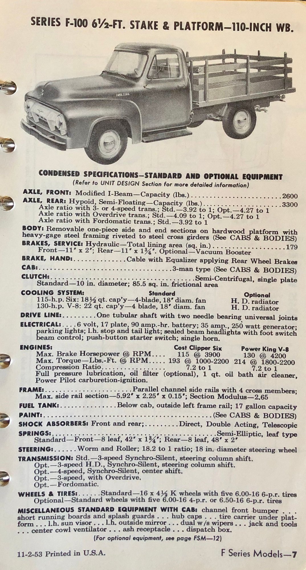

Did Ford offer a factory flatbed or stakebed for 1953-1956 F100? If so, what were the basic dimensions of the bed?

Here are the pages for the F-100 stake and platform from the 1954 Dealer’s Truck Handbook.
Edit - come to think of it, I have one of these beds if you are interested. Stu

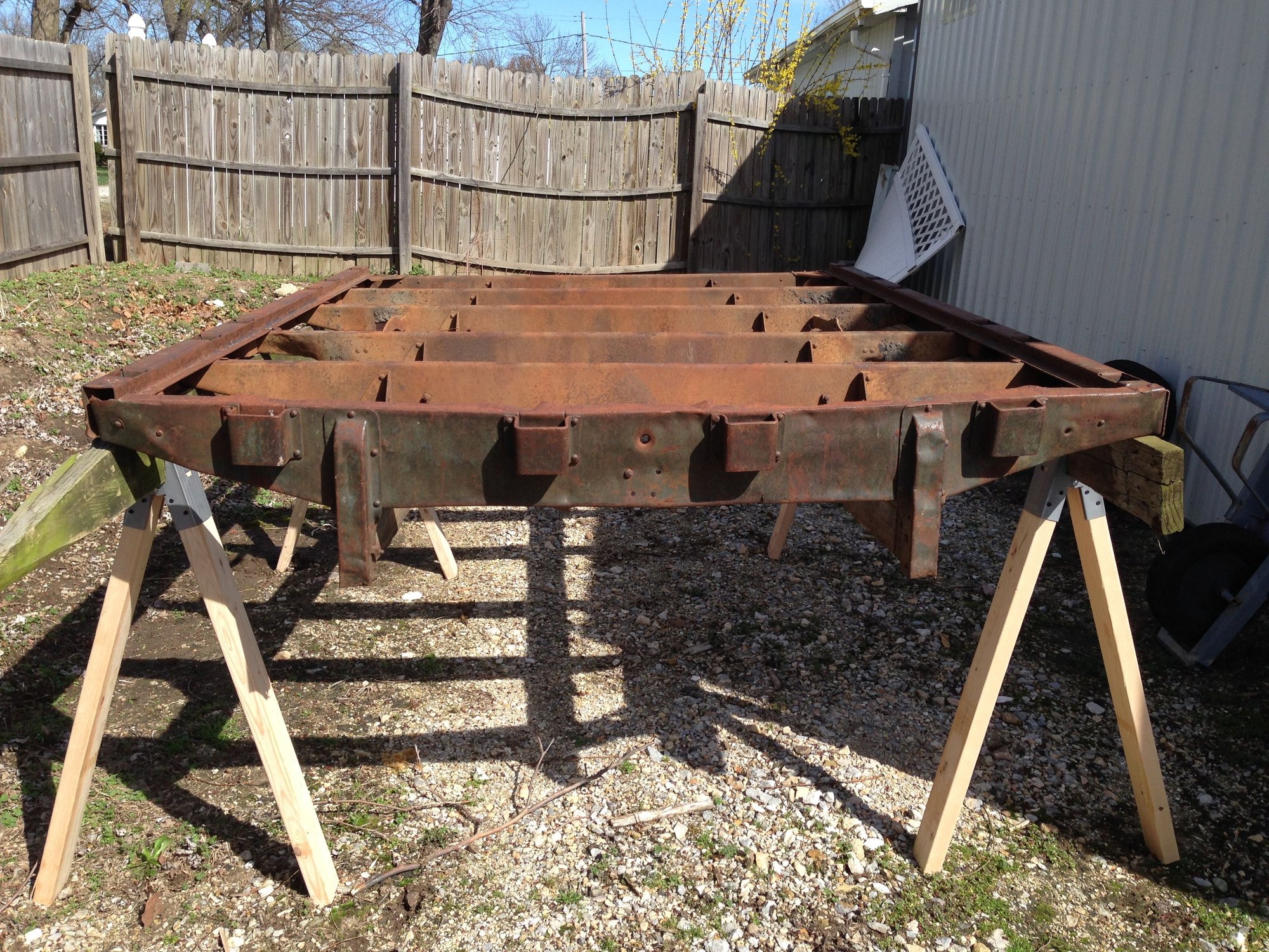

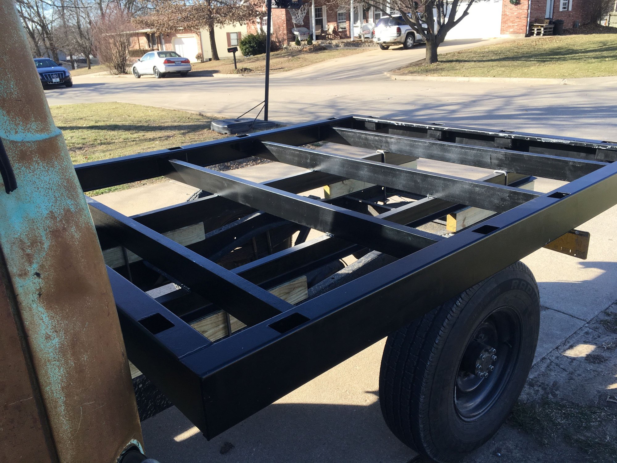

That reminds me. I have an older flatbed that I need to pull out and sell. I started to fix it up and had the opportunity for my son to build one for me.
I figured one built by my son would have much more meaning to my truck.
For my bed I got the side rails from here: https://flemingmetal.com/truck-body-...k-pocket-rails
We used C channel for everything else. So, it's heavy.but standard C channel was much cheaper that lighter gauge stuff.
Here is a link to my flatbed thread. https://www.ford-trucks.com/forums/1...l-project.html
It looks like I didn't finish out that thread. But it does have links to Bob's pdf files for 48-52 flatbeds.

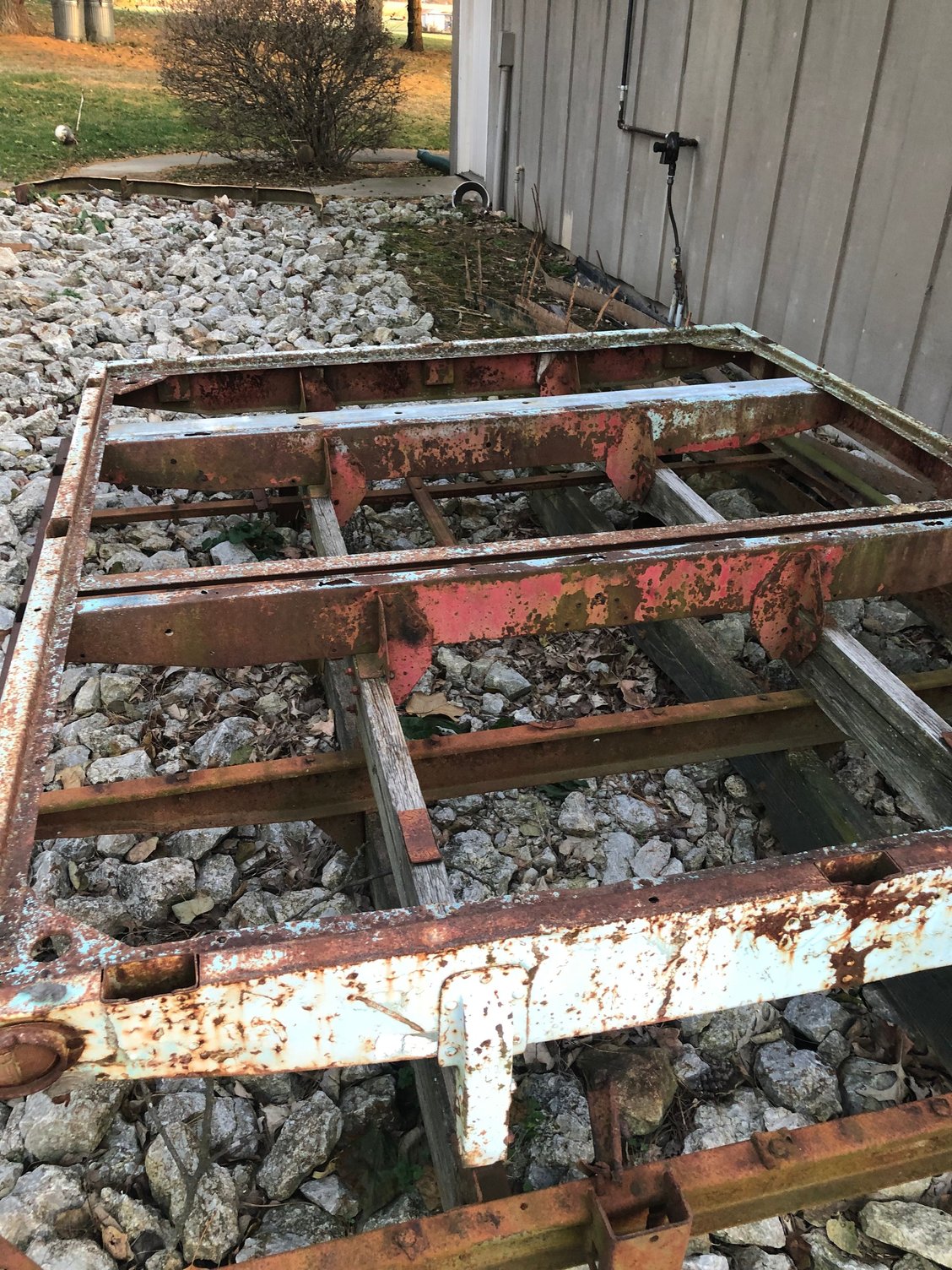

Oh here is a picture of my bed before wood was installed.

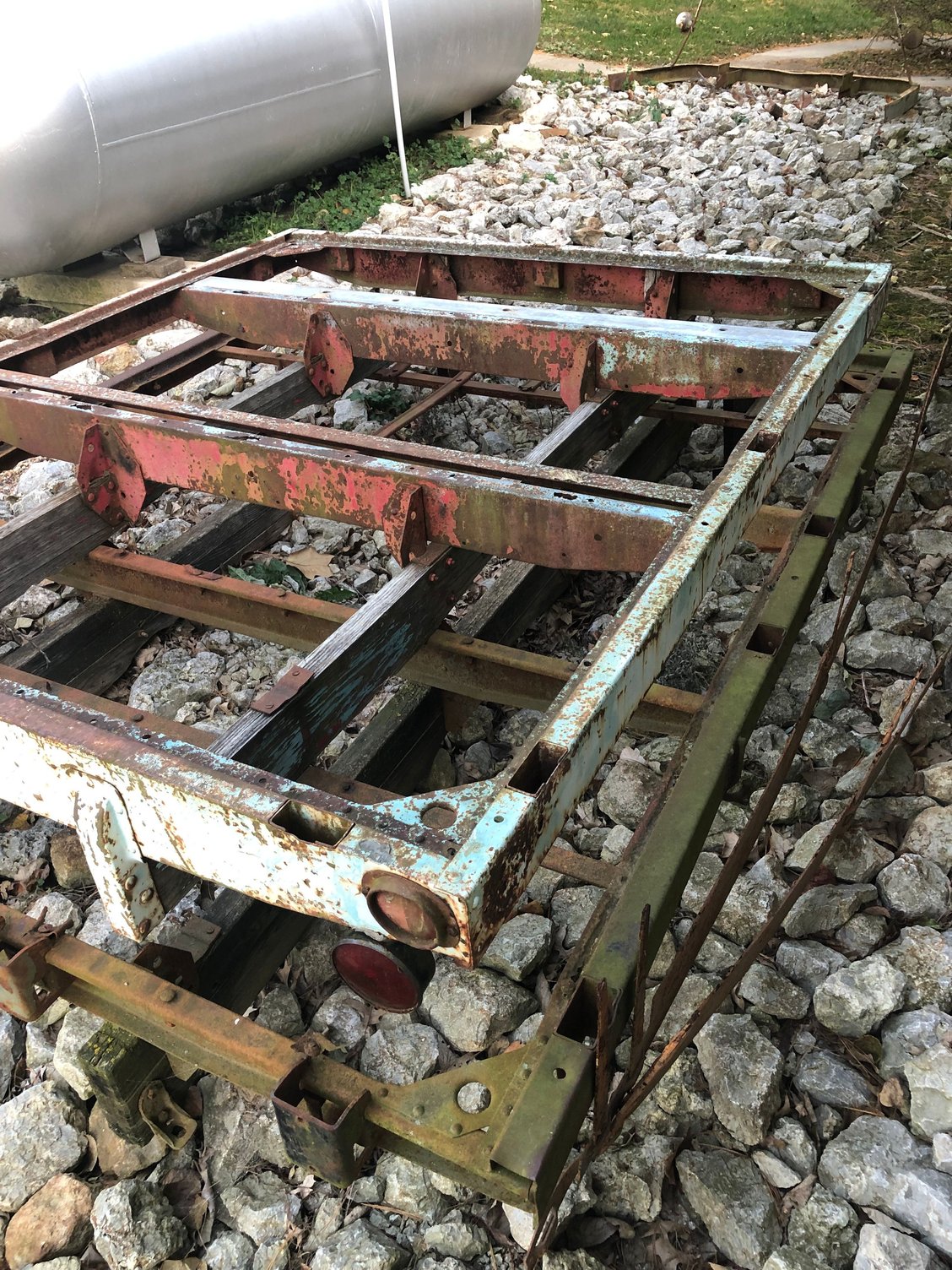

I think we’ve got this covered if two retired guys can slide this on to Art’s trailer. A bunch of years ago I got this and the 3/4 ton bed it’s sitting on from Josh Madsen. I hauled them and the 12’ bed that Mark (thundersnow70) got from Josh. I can use the 3/4 ton bed on my second project truck but have no need for this one. So Art might as well have it if we can get it loaded. Art lives only a few hours east of me so it’ll have a good new home. Stu

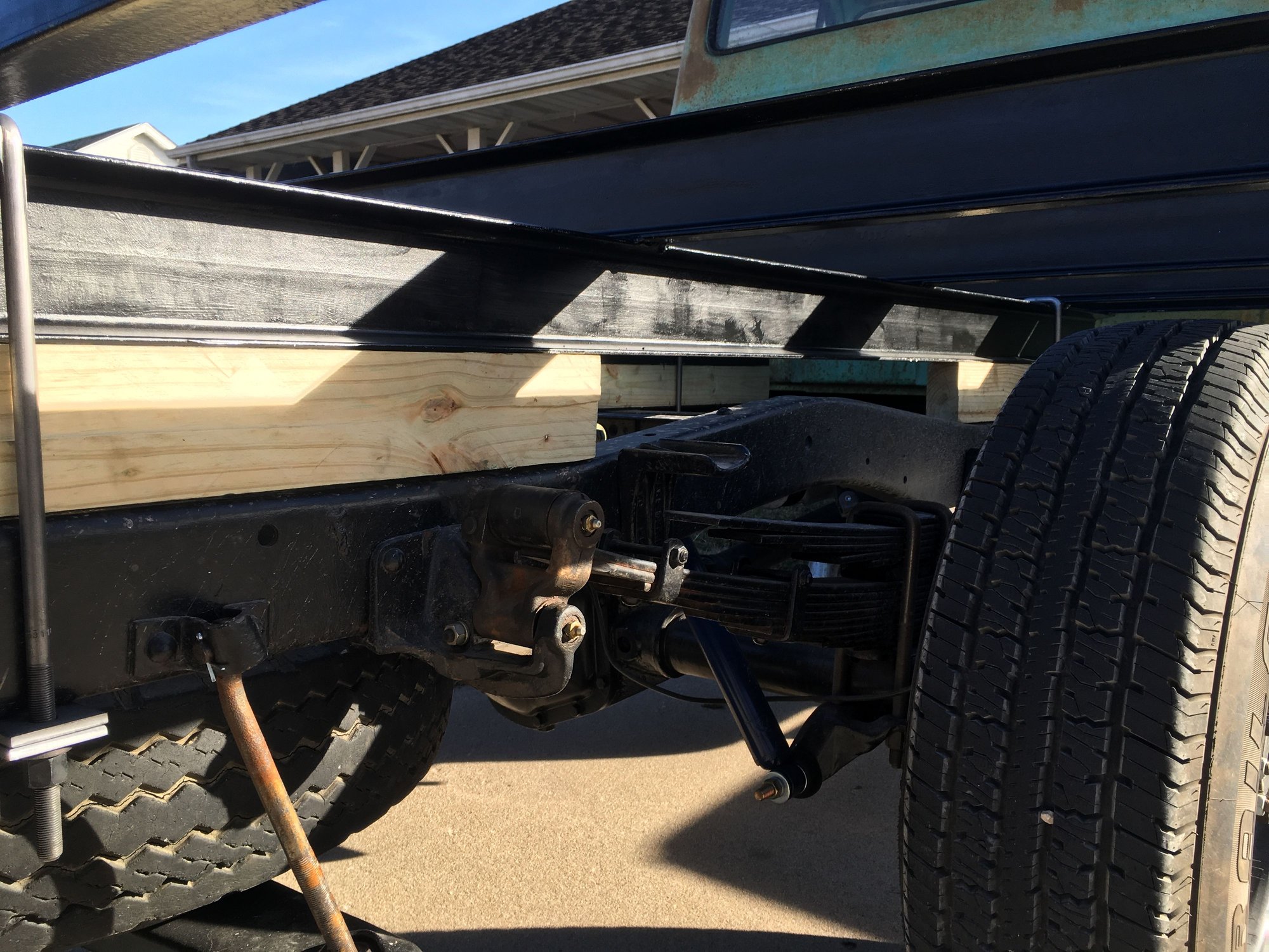

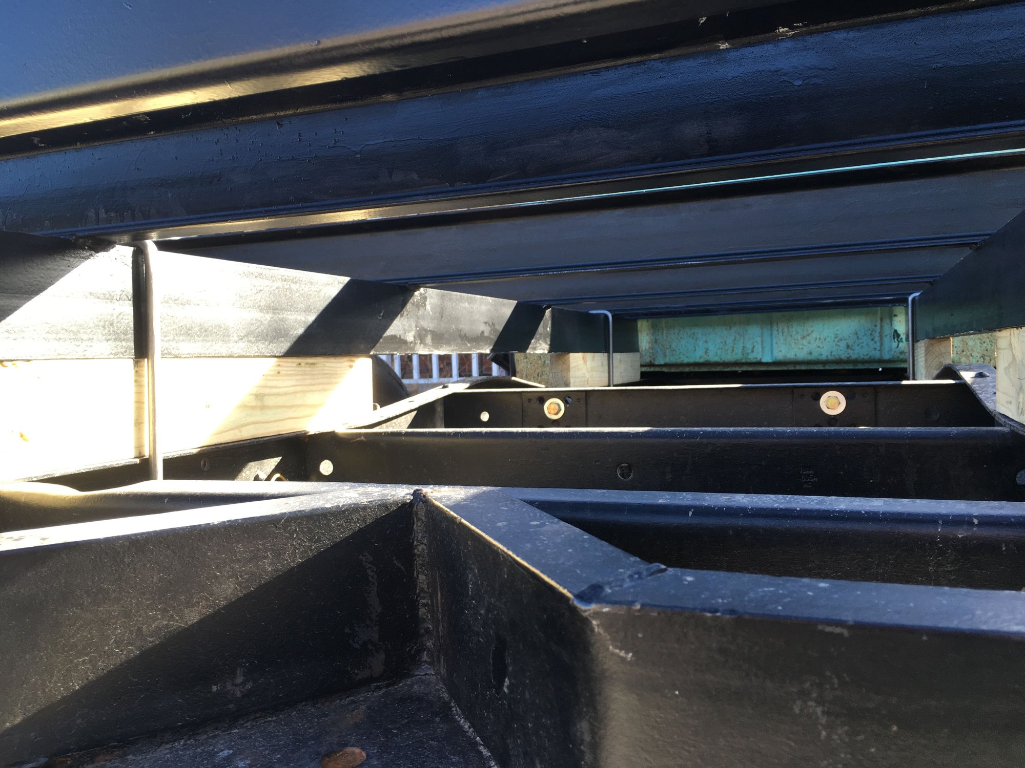

Nice looking bed! How did you fasten the bed to the frame rails? Large U-bolts?

From: Jefferson City, MO
Yes, I had some big u-bolts made for me. There are 4. I used 2X4's as a spacer between the frame and the bed.
