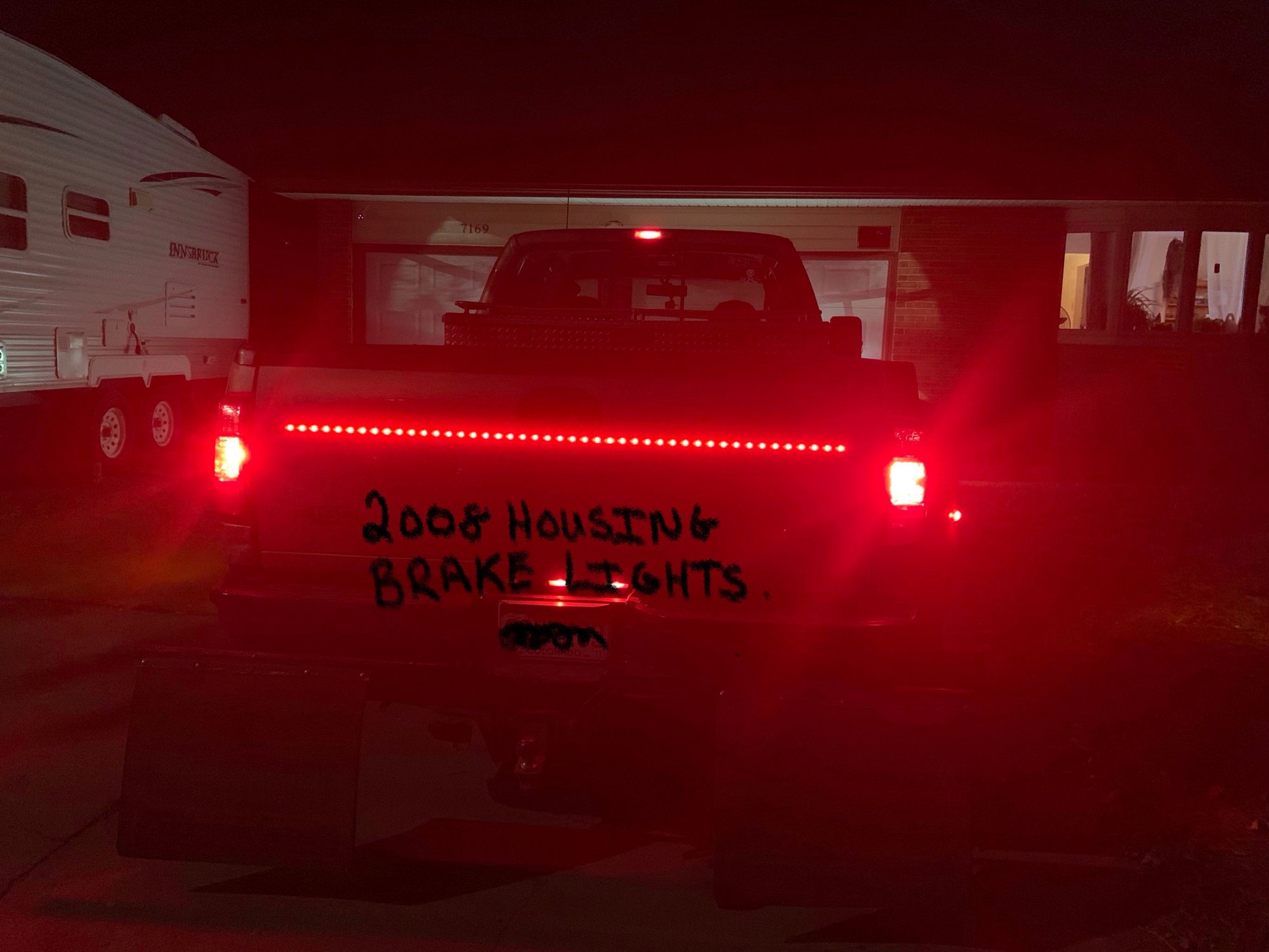

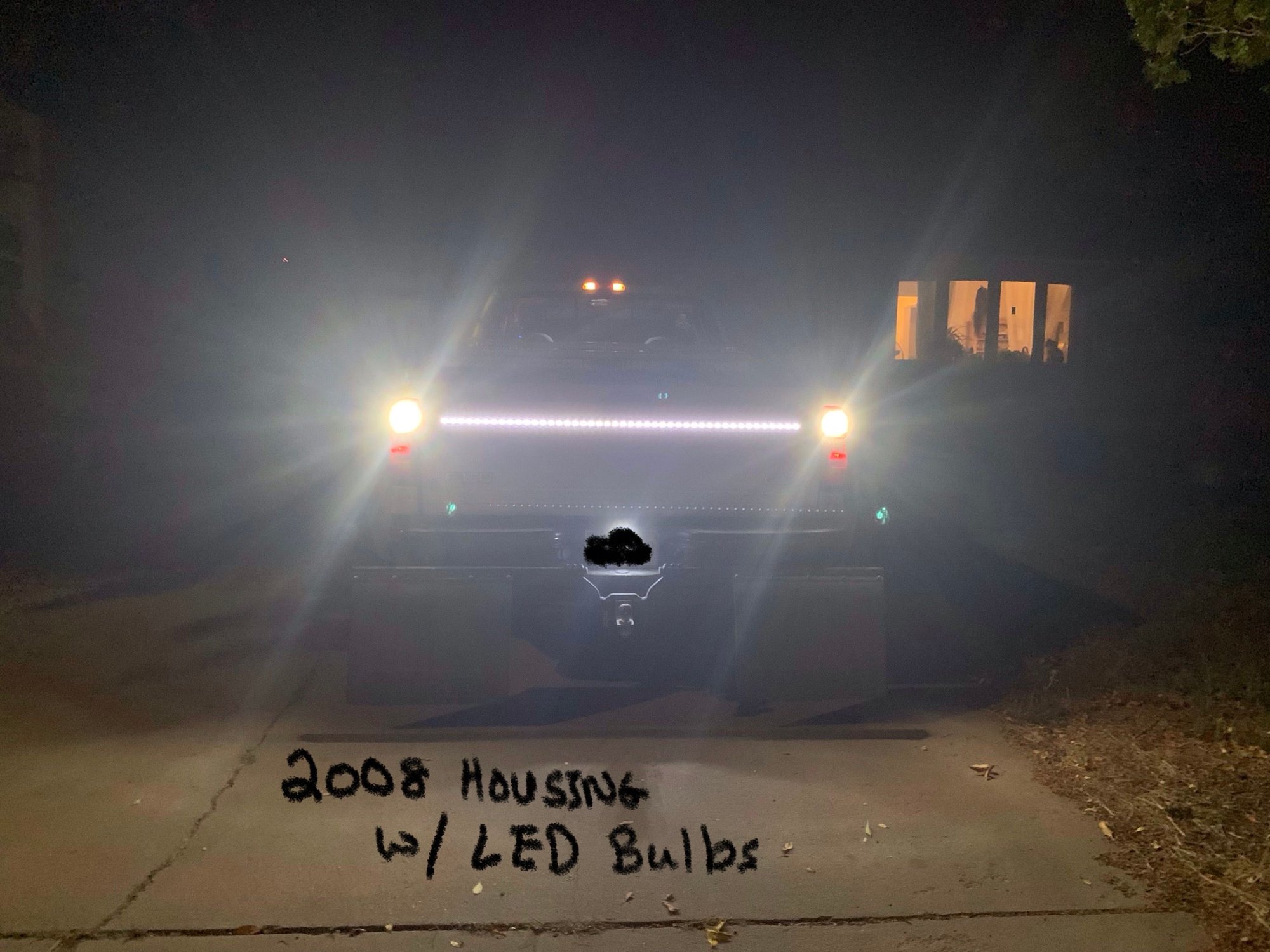

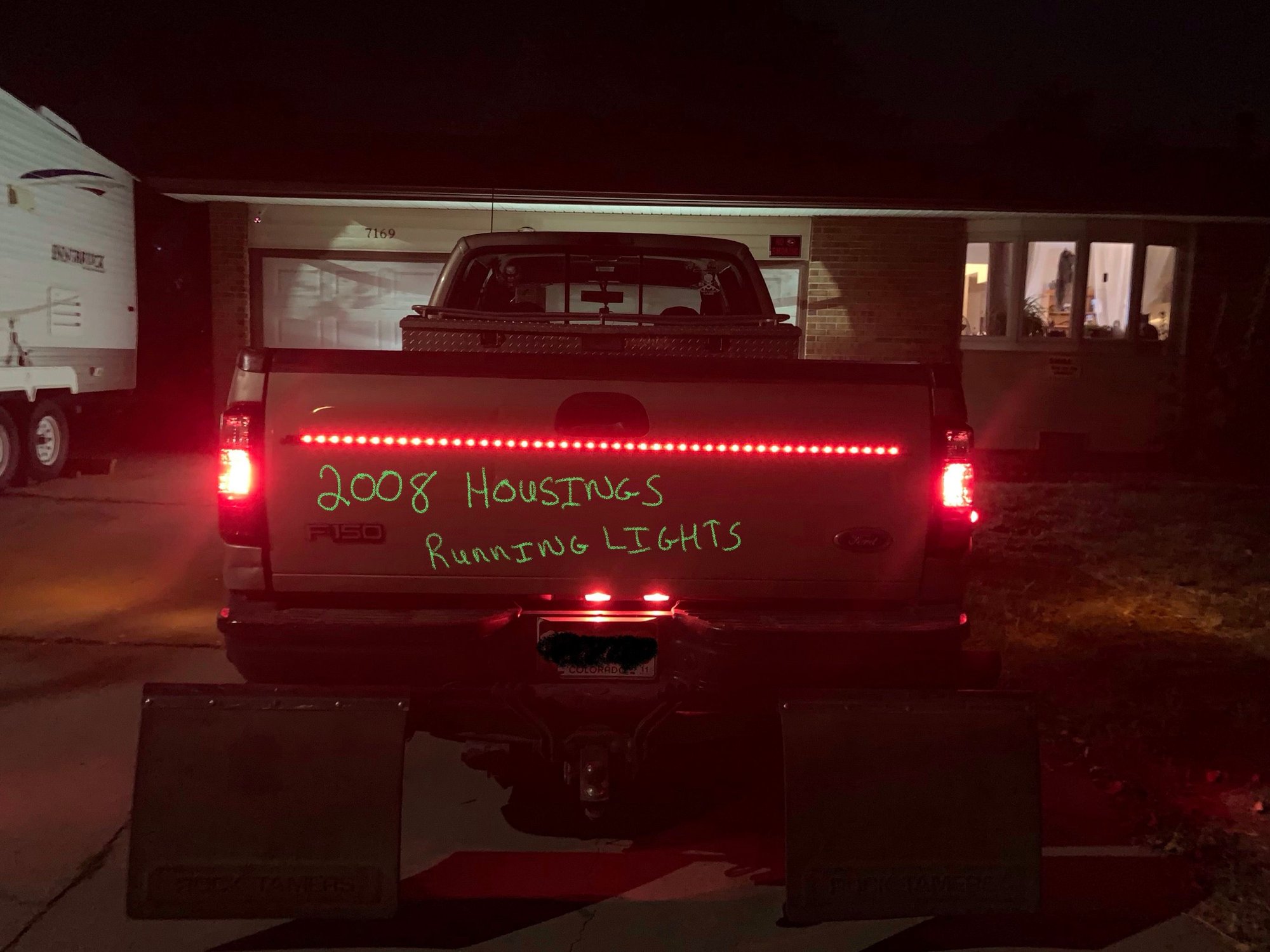

A couple things to keep in mind, LED’s will not produce heat like an incandescent bulb does, so if you deal with a lot of snow you may want to reconsider. I put LEDs in the front of my truck. I replaced the tail lights on my 7.3L but used 2008 housing, with incandescent bulbs for brake lights, but I used LEDs for back up lights. If I got caught in snow I wanted my brake lights to definitely work and keep the snow melted off of them, so I used incandescent bulbs for the brake lights.
‘Here’s my thread for installation of TRUCK-LITE LED’s....https://www.ford-trucks.com/forums/1...tes-led-s.html
Bulbs for backup lights.
I see your in Colorado. when I'm driving through unplowed snow here, my tail light housings still get completely covered with snow regardless of my OEM bulbs. IMHO, I don't think they throw off enough heat to melt anything but maybe YMMV...
