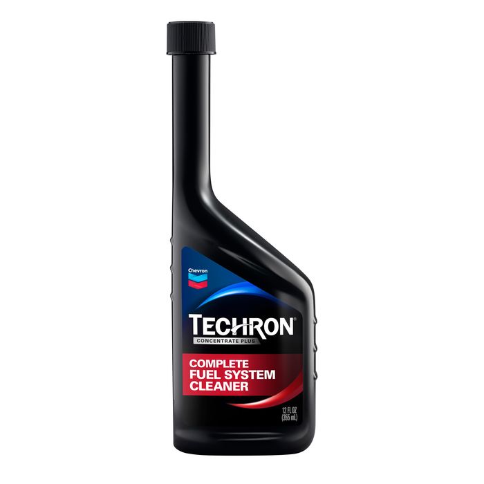

I have used Techron fuel system cleaner often for gauge issues and it works well for cleaning the build up on the fuel gauge sensor.
