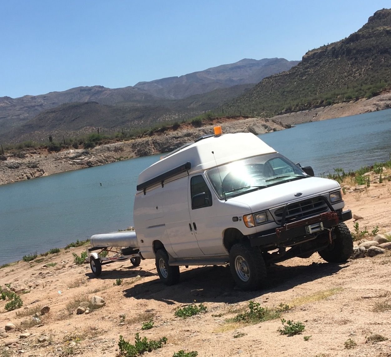

That's a nice looking van. What's the orange light for? Former ambulance?
It was built for the city of Colorado Springs. Some kind of computer and camera van with a generator and fresh water tank.
It was built with a Factory Authorized F350 4x4 conversion with Dana 60’s. I turned it into a Camper and tow rig. It’s been flawless! I added a sink, bed and ARB fridge. The whole van strobes but I only use it so people can find my camp spot or for changing a flat on the side of the road. Traffic goes from 70 to 45 when I light it up so I only use it if I have to. The generator was a 5500 watt Onan. I sold that and cary a little IU2000 honda. A big solar panel on the roof and an extra battery is really all I use except for the AC I installed. I’m worried about the fuel pump still....
