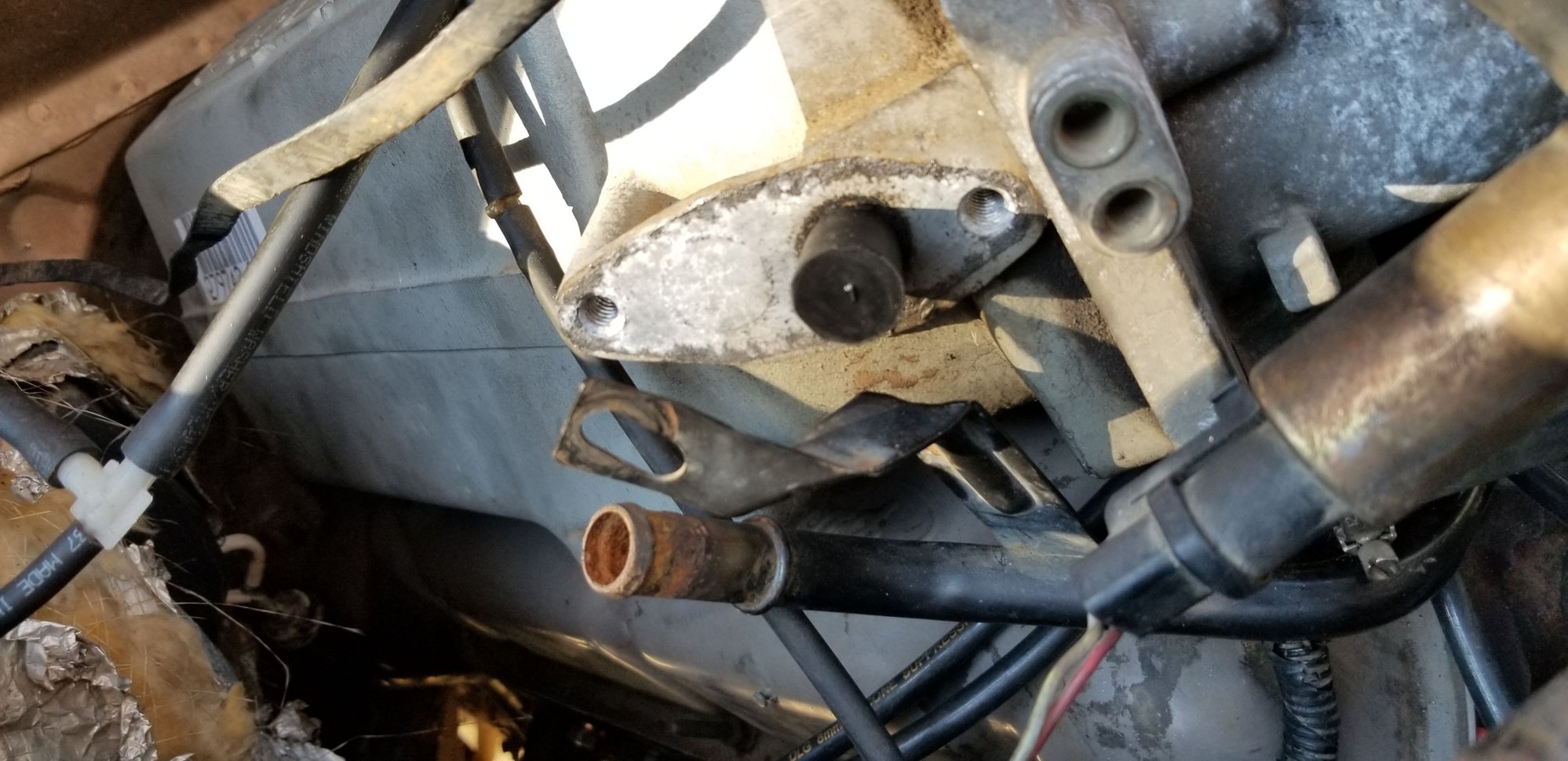

I put a rubber plug on the EGR part of the intake for now because I just wanted to hear it run.

Could be your problem right there. Have a pic?

This is the rubber stopper I used in the EGR part of the intake.

I guess that stopper will work. Look at my earlier post, all the advice I can give for now.
