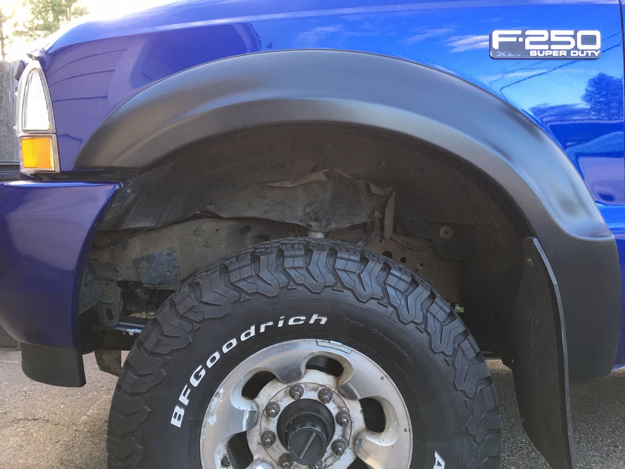

I've got an 02 f-250 and ended up going with HD ATS springs basically a 1-ton spring to prevent sag in the future & love them.
Sold me the springs that where an OEM match along with all the hardware and shackles to make the job easier.
Its an additional 1" raise of OEM but mine where really far gone so it ended up raising mine about 2.5" above the old sagging ones.
As for install that was an absolute pain the the butt, but I''m not sure if your paying to have them installed or doing it yourself.
All try and find some pictures of before & after if I still have them.
Front HD Springs 03 F-250
You only have two leafs per spring. When I was still running the stock POS Dana 50 in front on my 96 F250, I had a 2 leaf AAL kit installed. From what I recalled, the 50 rode better because of the TTB set up. Once the kingpin 60 went in, the honeymoon was over. That thing rode horrible with the straight axle without my 8 foot plow on. I hear the newer body style Super Duty springs were supposed to be smoother than the OBSs because they are longer. But all I know is the coil sprung, radius arm front ends of the new Super Dutys ride a whole helluva lot better than my 96. I believe that some aftermarket companies sold Super Duty front spring front shackle mount conversion kits for the OBS trucks. I could be wrong. I'm just glad I don't have front leaf springs anymore. Good luck with your truck.
