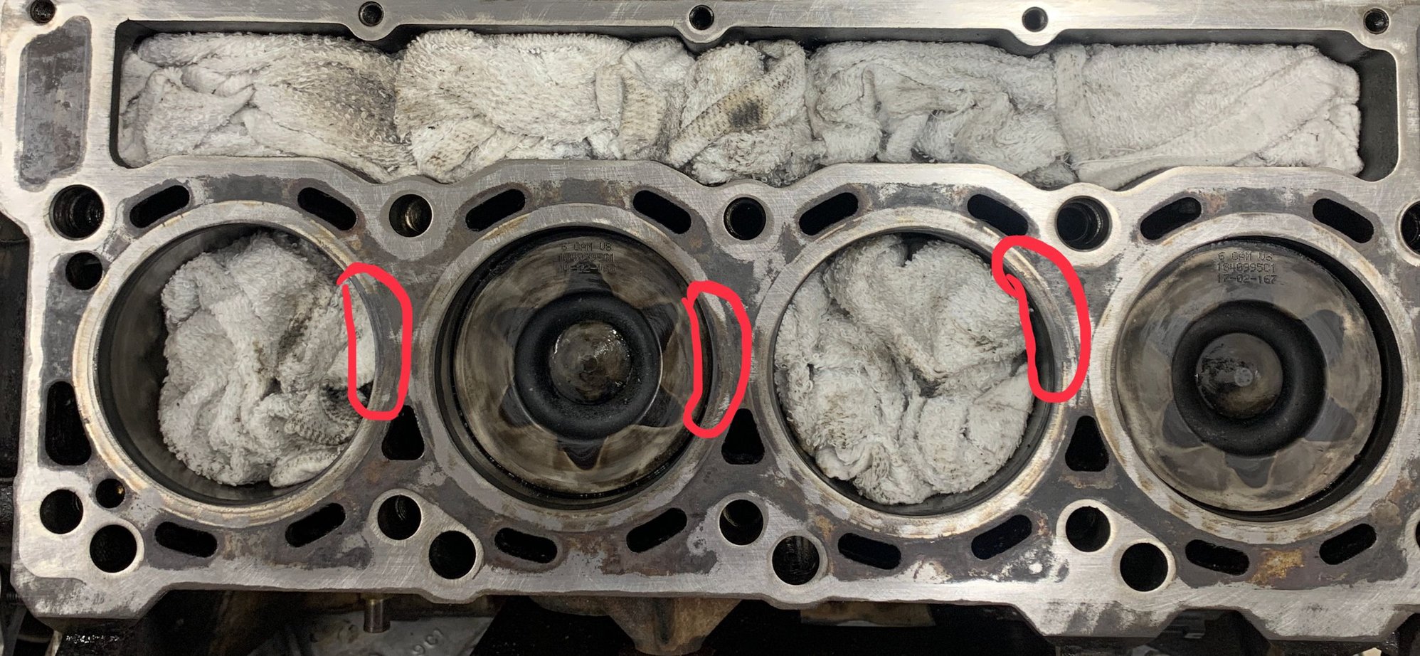

Both sides were washed out between cylinders.
I drove over 30k with slightly compromised head gaskets and could only make it puke if I really got on it hard. I don’t recommend this, they could have let go at any time and done real damage. Get the gauge so you can monitor and be sure!
