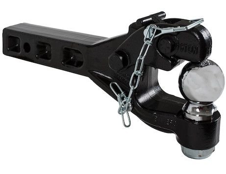

Try a pintle hitch with a ball mount. One piece. Lots of options for it.
