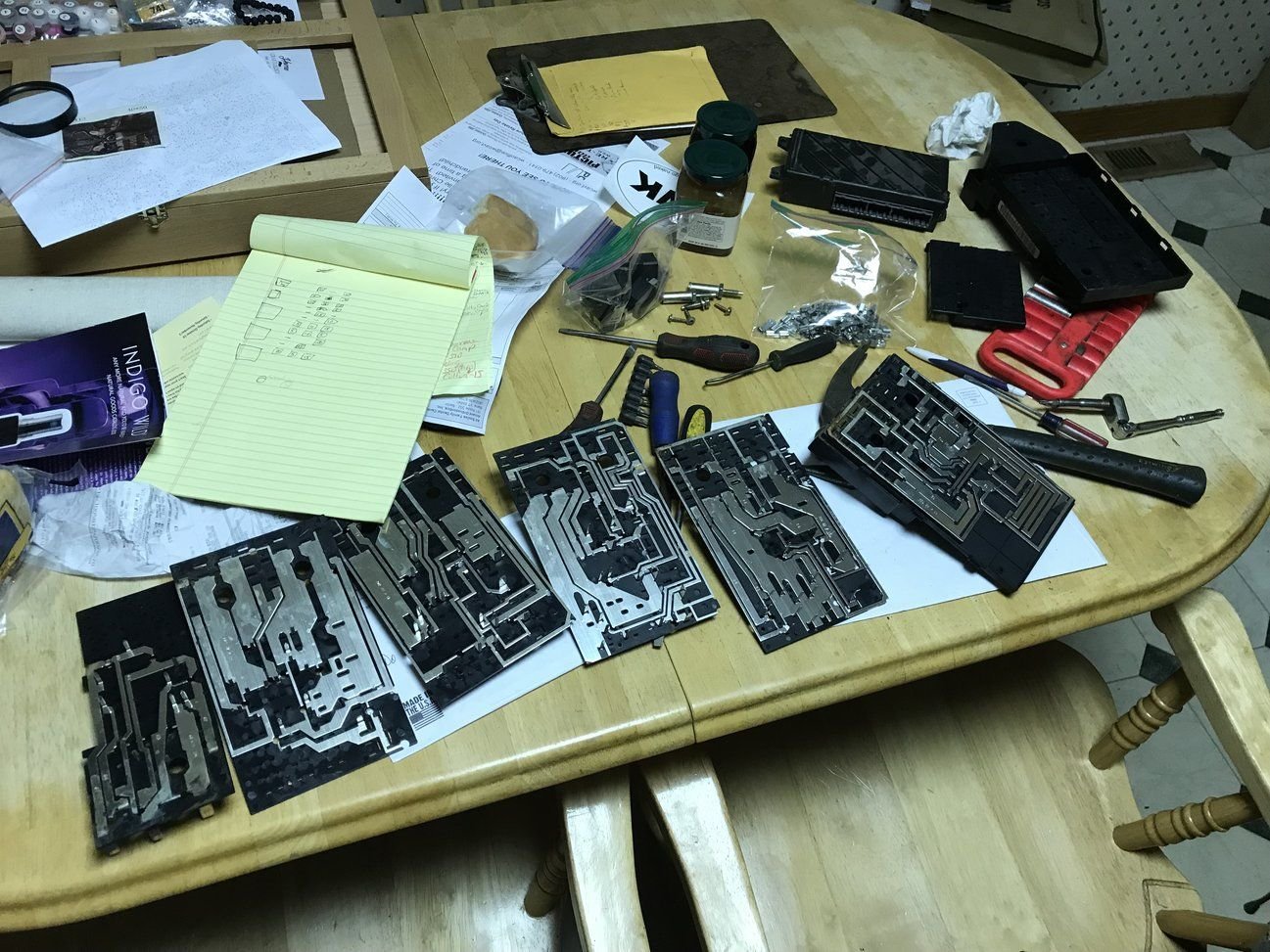

I think I am confused. I would jump right on that idea but where are the caps located on this GEM? Looks to me more like a 6 layer power distro set up with no caps involved. I found this snap on another post ( https://www.ford-trucks.com/forums/member.php?u=182384) showing what the guts of GEM look like. I am researching the DYI rebuild and found several great posts on how to.
Old Nov 4, 2019 | 01:52 PM
miedla's Avatar
miedla
Joined: Oct 2019
Posts: 12
here is the photo posted by "WILDSTANG"
