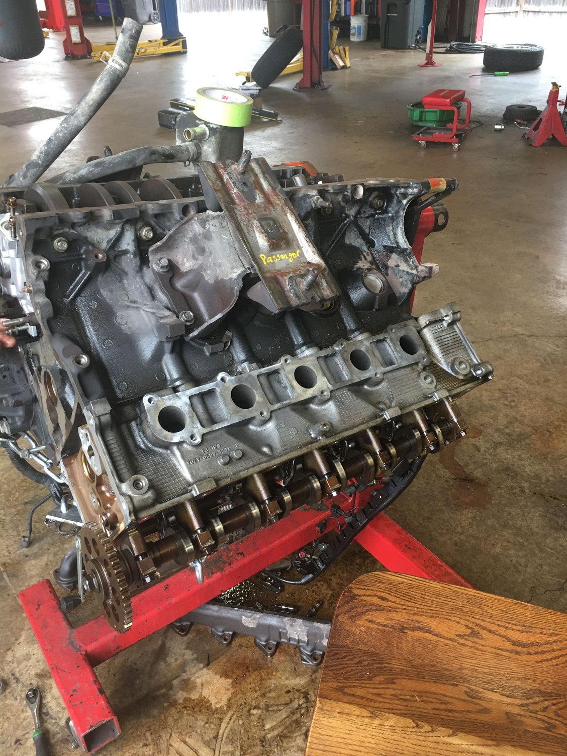

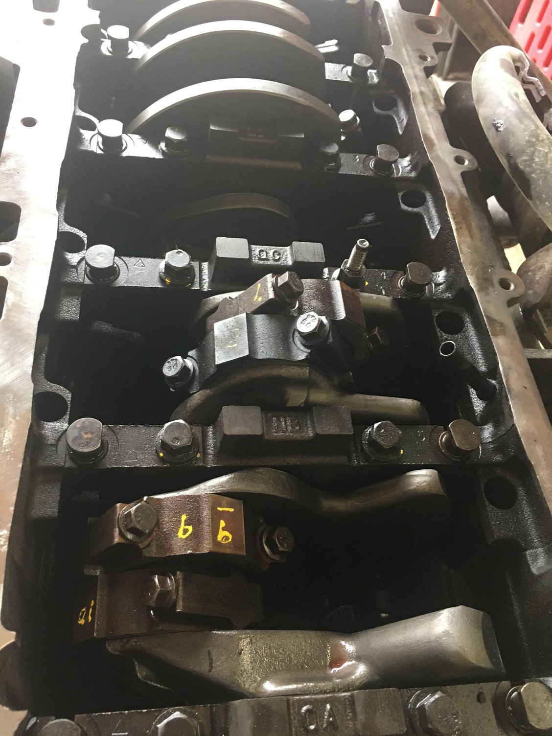

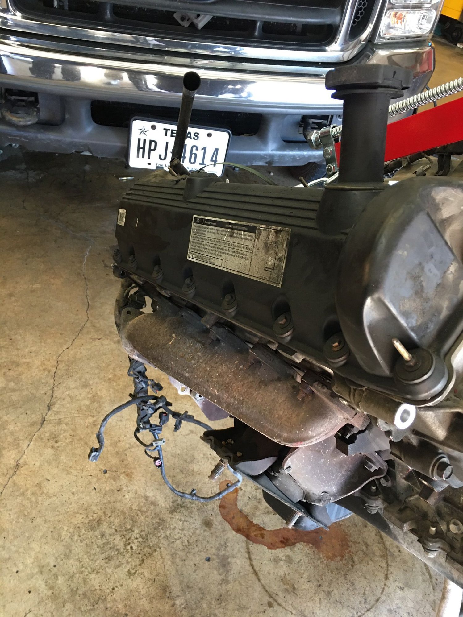

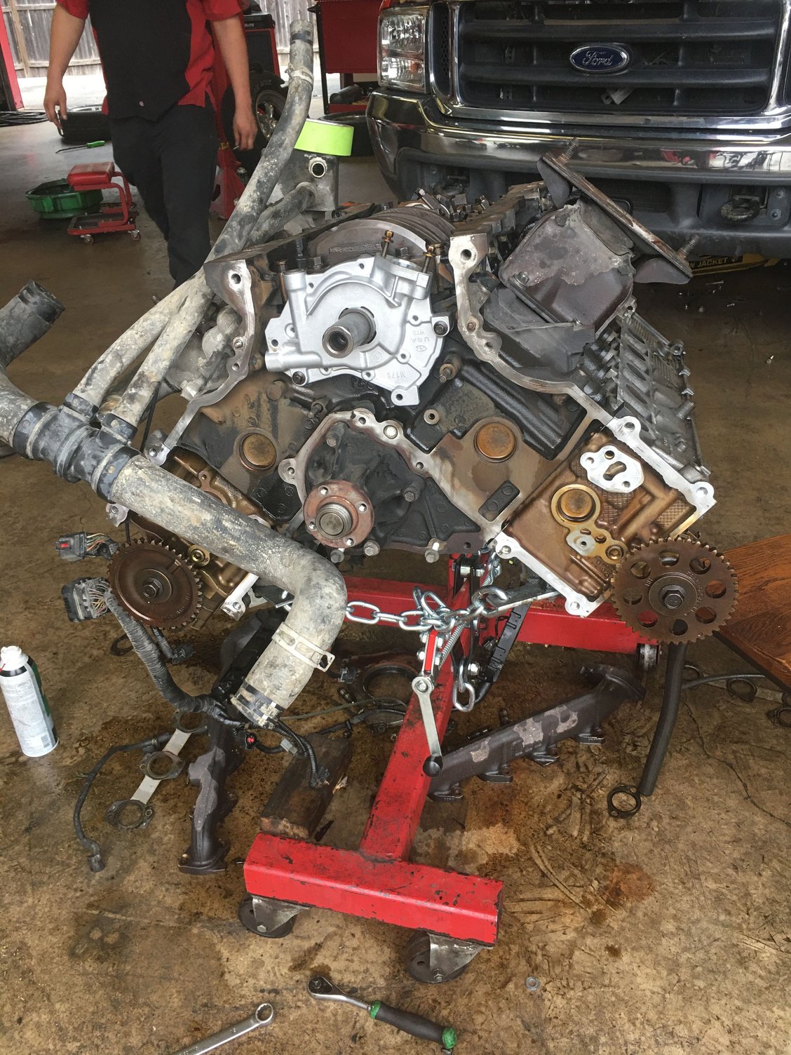

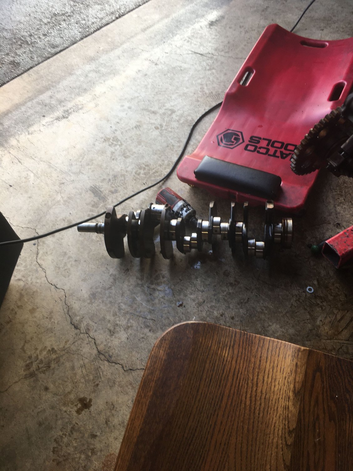

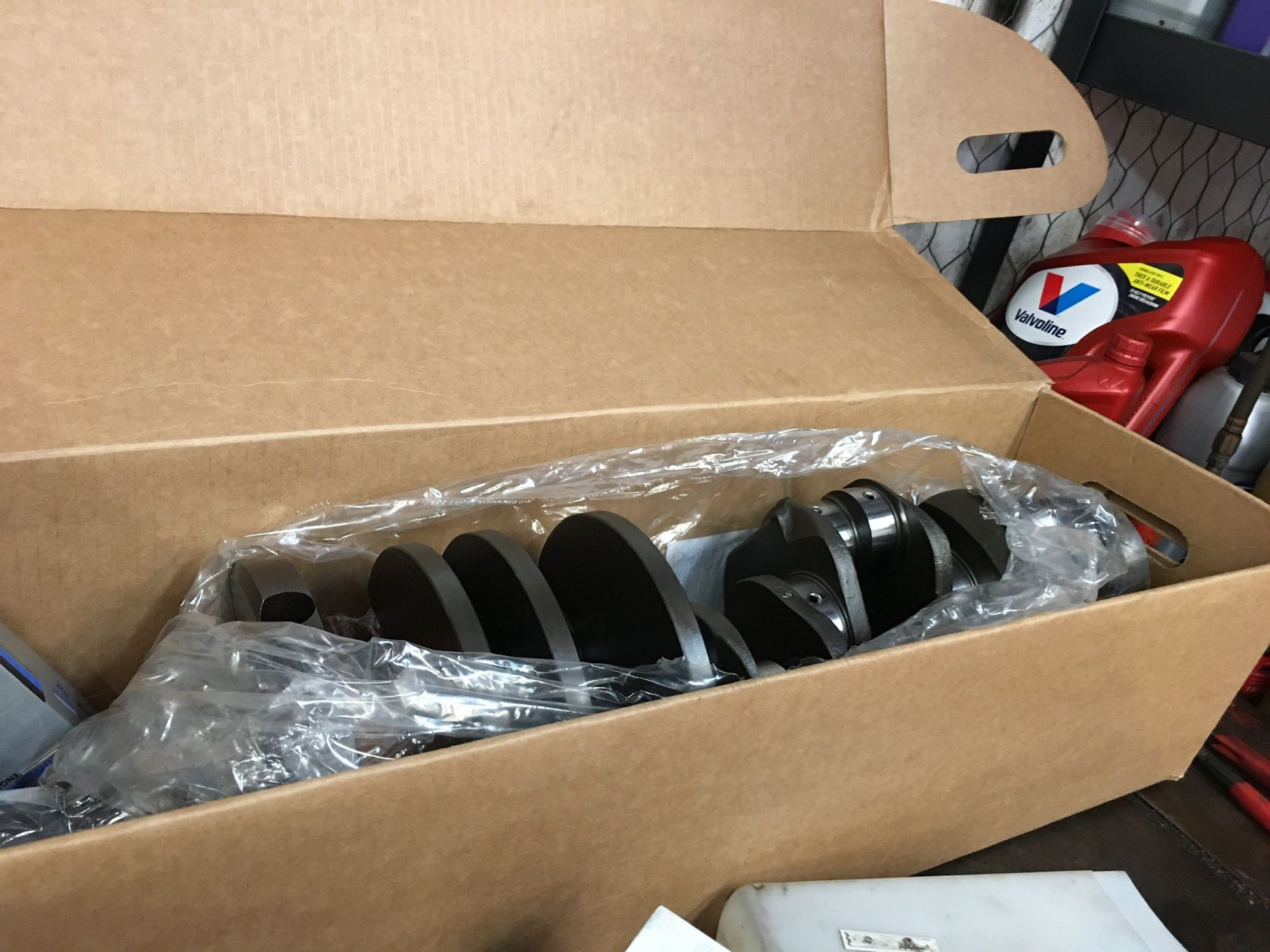

Update
Well the engine is out the crankshaft is here. Making it great again!

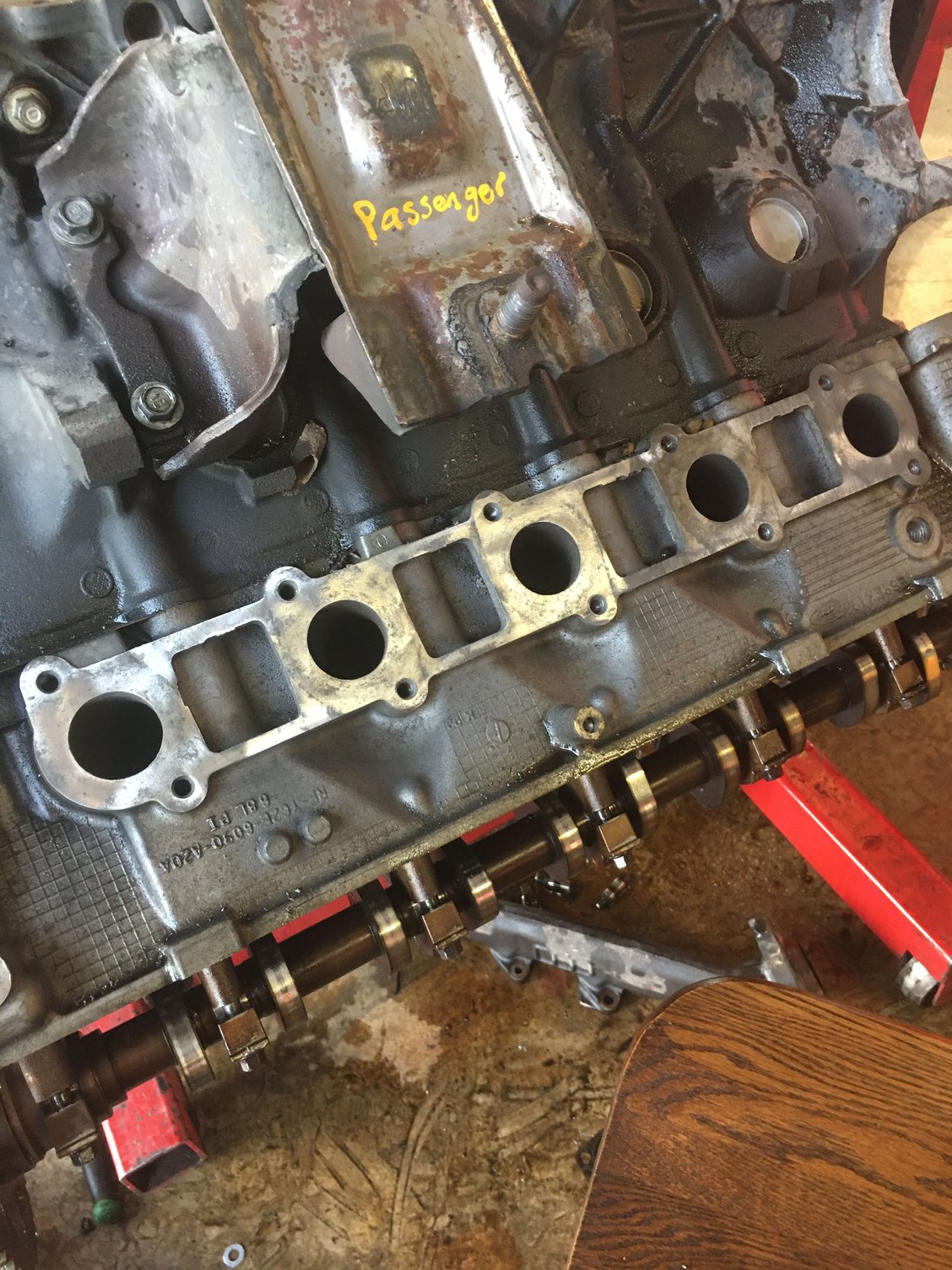

I would add while you have that engine out, check all of the exhaust manifold studs. If any look bad, replace them now. They are a monster to do a 2wd truck because of the front coil spring towers. They studs are known to dissolve over time. Probably not nearly as bad for a Texas truck as other places, but the point still stands.

Definitely follow Wizkid's advice regarding the exhaust studs.
Lisle makes a template if you need to drill them. $70 on Amazon. Part #68500

well since I didn’t have one to start with I went with what I saw. And yes I could have gotten the crank ground. But for 204 I got a crank with the bearings. That works for me.

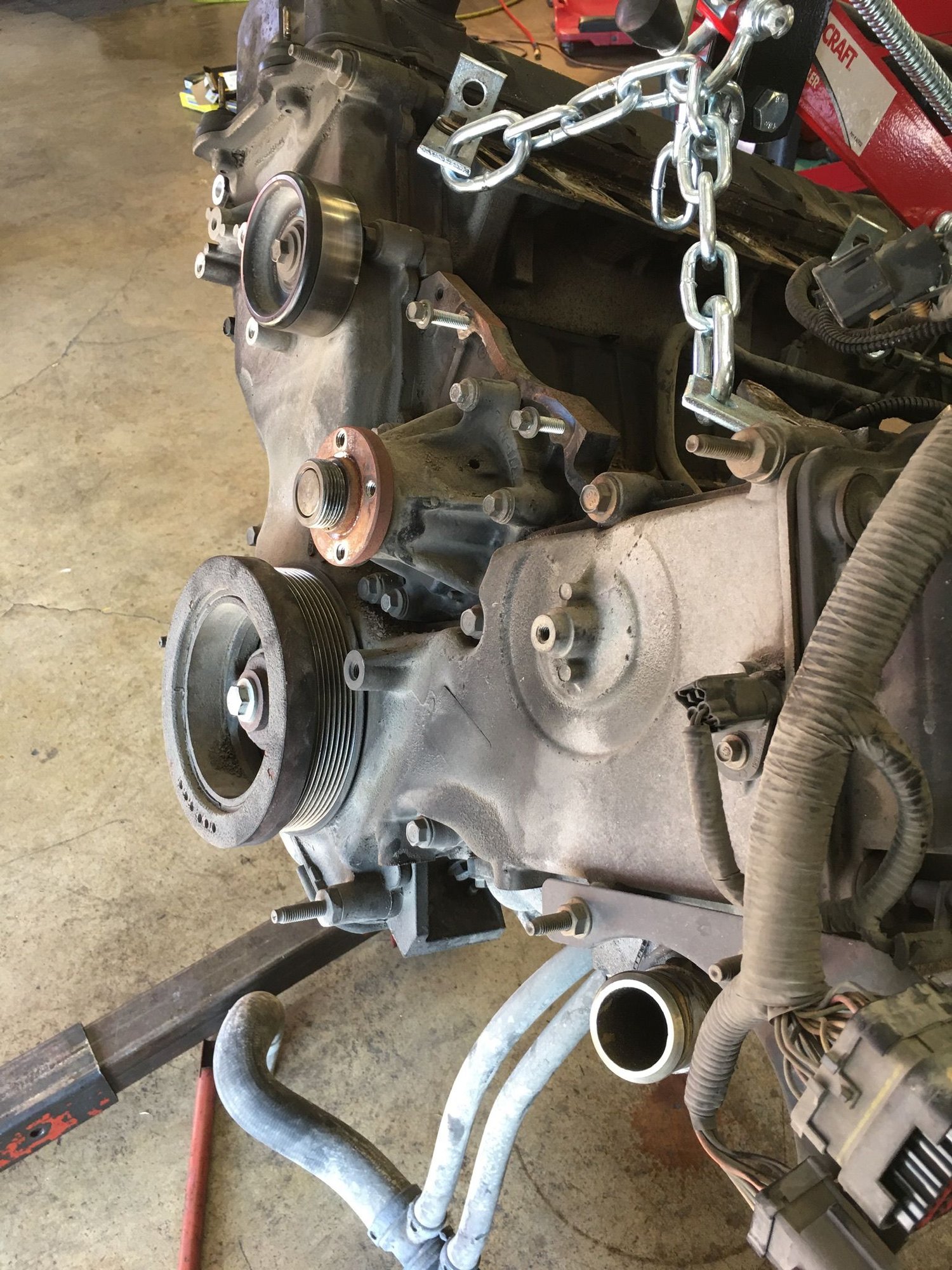

Thanks. It continues
Thanks for the heads up on the header bolts. 2 were already broke, 4 broke in removing, but they were able to get them all out and replaced. Parts are rolling in. It’s going good.
