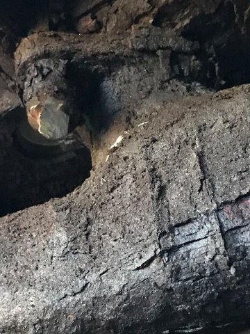

2004 Had to replace the power steering pump. While I have it apart decided to replace drivers side leaking exhaust manifold. Manifold has a crack. Can’t get any of the rusted bolts out. Started to grind off the bolt heads. Only got one done. Is the bolt spacer under the bolt head? Should I be able to then pop the spacers off and then the manifolds? I feel I am in past point of no return. Any advice would be greatly appreciated.

That looks a little crusty.
Its a long bolt with a spacer under it. People have had to drill out the bolts in the head, and sometimes that means pulling the heads.
Someone who has had problems with these before may be of better help.

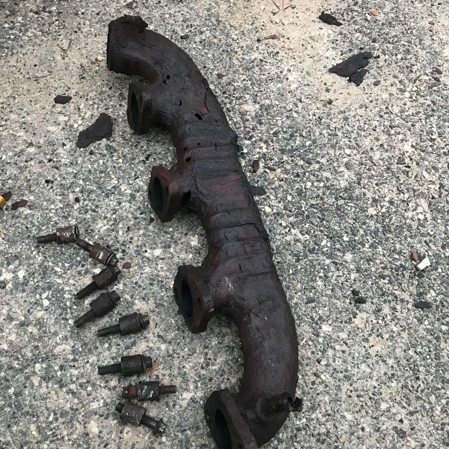

Well I think taking the heads out is way beyond me.... That job is more than a science teacher can handle. Anyone else think I can grind off the rest of the bolts and get the manifold out. Break it up?? Air Chisel?? I think I can reach all of the bolts. It appears that they are just rusted to the manifold. The manifold has a pretty good hole in it that I located. Any one think that will work before I just give in and unload it. I love my truck, wife wants it gone....

If you are going to destructively remove, then any means possible. Cutting torch, straight and angle air grinder with a cutting wheel (not grinding disc), Dremmel with reinforced cutoff wheels, chisel, whatever it takes.
The next challenge will be getting the bolt remains out of the heads.

Well I finally got the manifold off. What helped me was I air chiseled the spacers until they broke free from the rusted manifold. I then used a set of those fluted bolt extractors on six of the bolts. One I cut off and had to really air chisel and it finally broke loose and I use vise grips to get it off. One just the air chisel and a regular socket. The bolts once broke free came out fairly easy. I had to cut the two bolts off flush on the down pipe. Now on to trying to get them out. Any ideas shoot them my way. The other manifold is not full of holes like this one, so not sure what happened here.I hope I don't develop a leak there anytime soon. Thanks for all the help and I hope to get her back together soon.. Looks like I may get to keep her a little longer...
