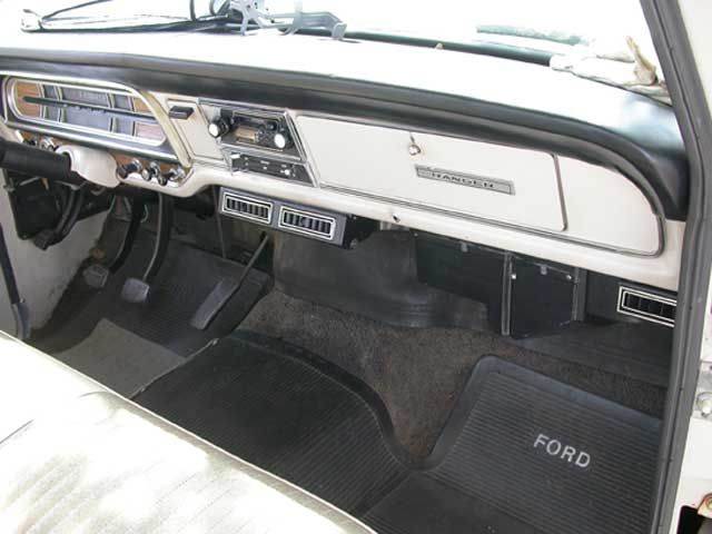

Ok everyone this may have been covered already and if so I didn't find it. Are the basic bottom dash contours the same from the 67-72 and the 73-79's? I ask as I am looking at purchasing a 78 F700 and would like to add AC to it. Found the Classic auto air kit that mounts along the bottom of the dash panel but its only listed as being for the 67-72 years.

Think the underneath classic air will work perfectly . The 73 - 79 dash bottoms have more of a curve but
with some shimming it will work your only mounting plastic outlets..

1973/77 F500 is the same as 1973/79 F600/880.

Awesome, thank you!
