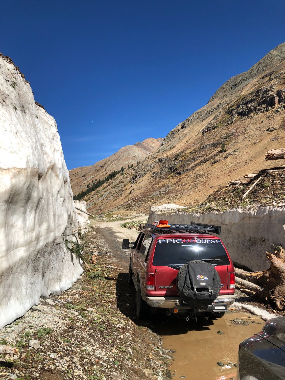

Very nice view squirrel! I see why you need it so high. I may move mine up too, it hangs a bit.
What brand and model is that swing away tire carrier?
