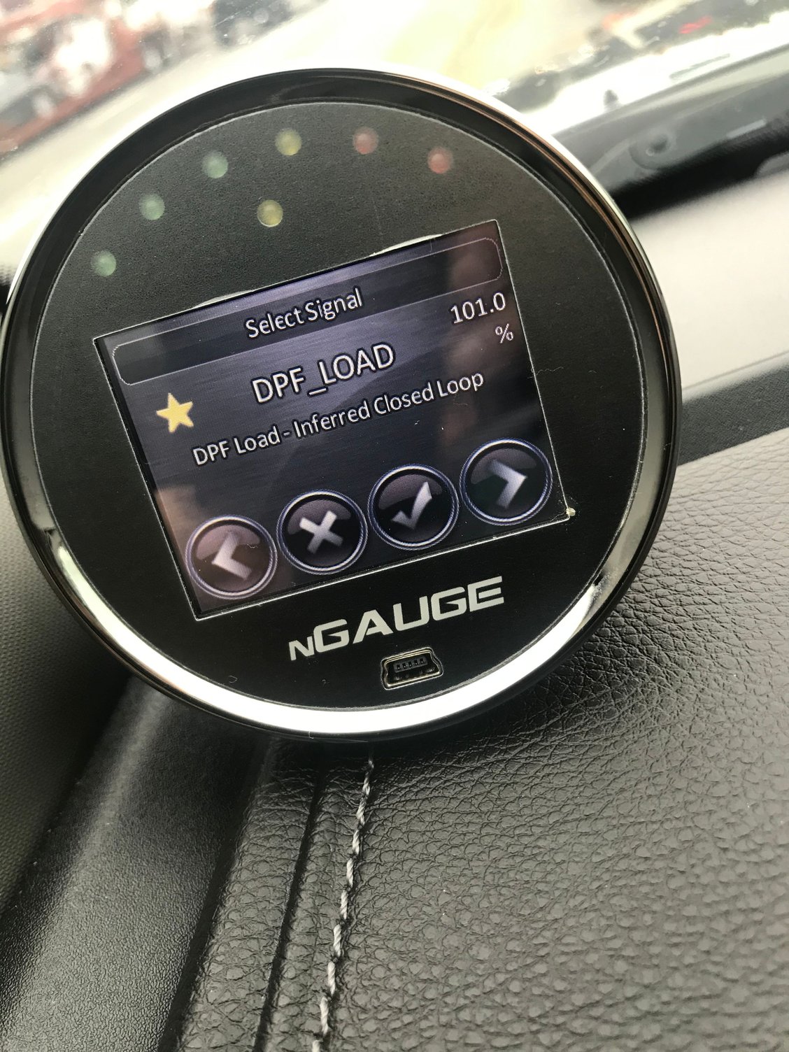

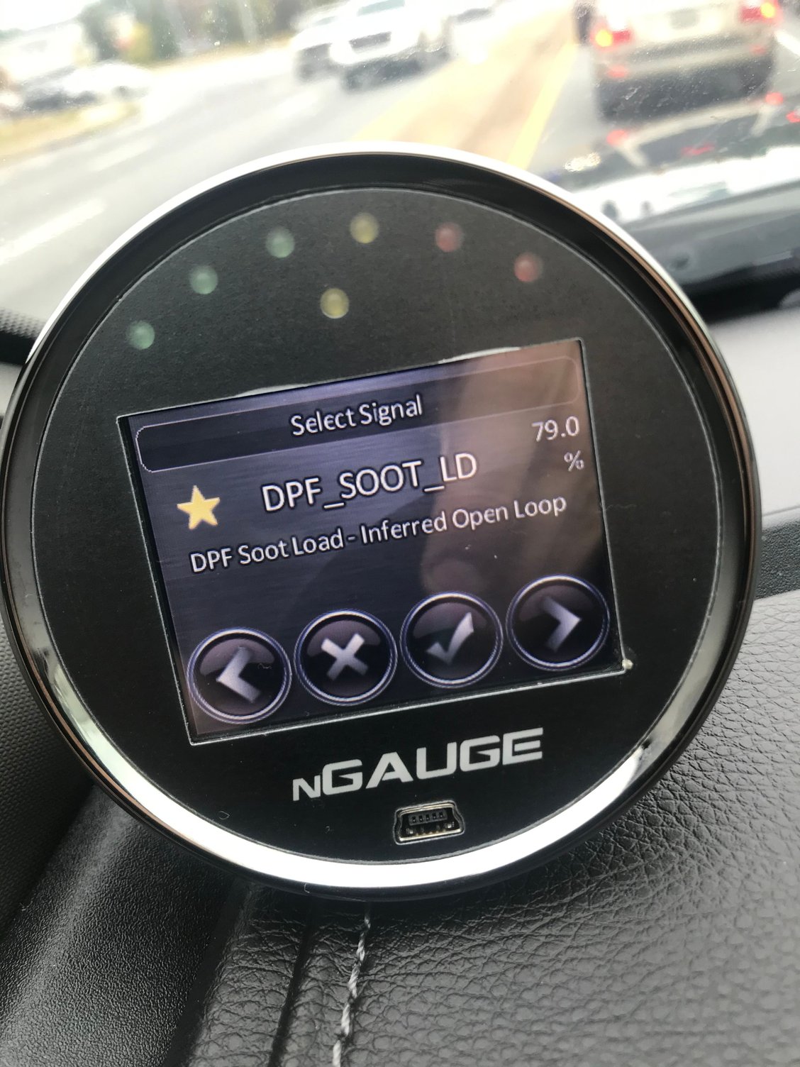

How can I tell when the Regen starts it is going on. I e been watching the soot screen the last few days. Works it’s way up to 100then starts over and so on. I assume around 100 and starts over it did a Regen?

I notice a lot of people have a DEF % screen turned on and watch that and want it to get down to as close as 0% as possible showing Regen was most successful.
from the three PID screens on my nDash I posted related to DEF, is one of them the same as the DEF% screen to watch and see how efficient my regens are?
