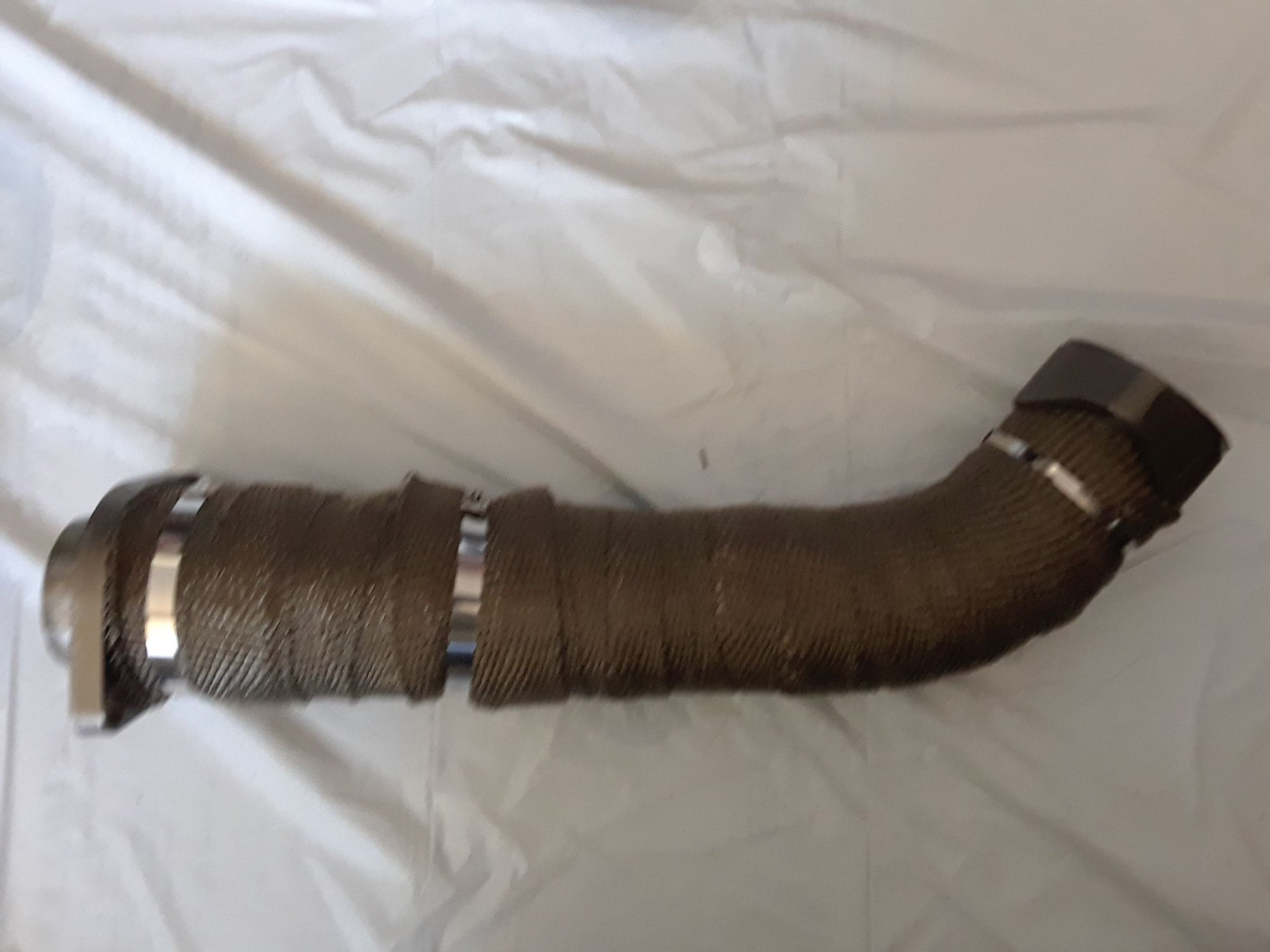

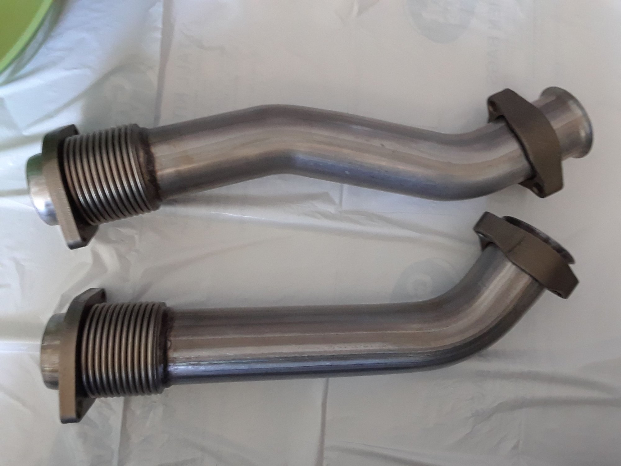

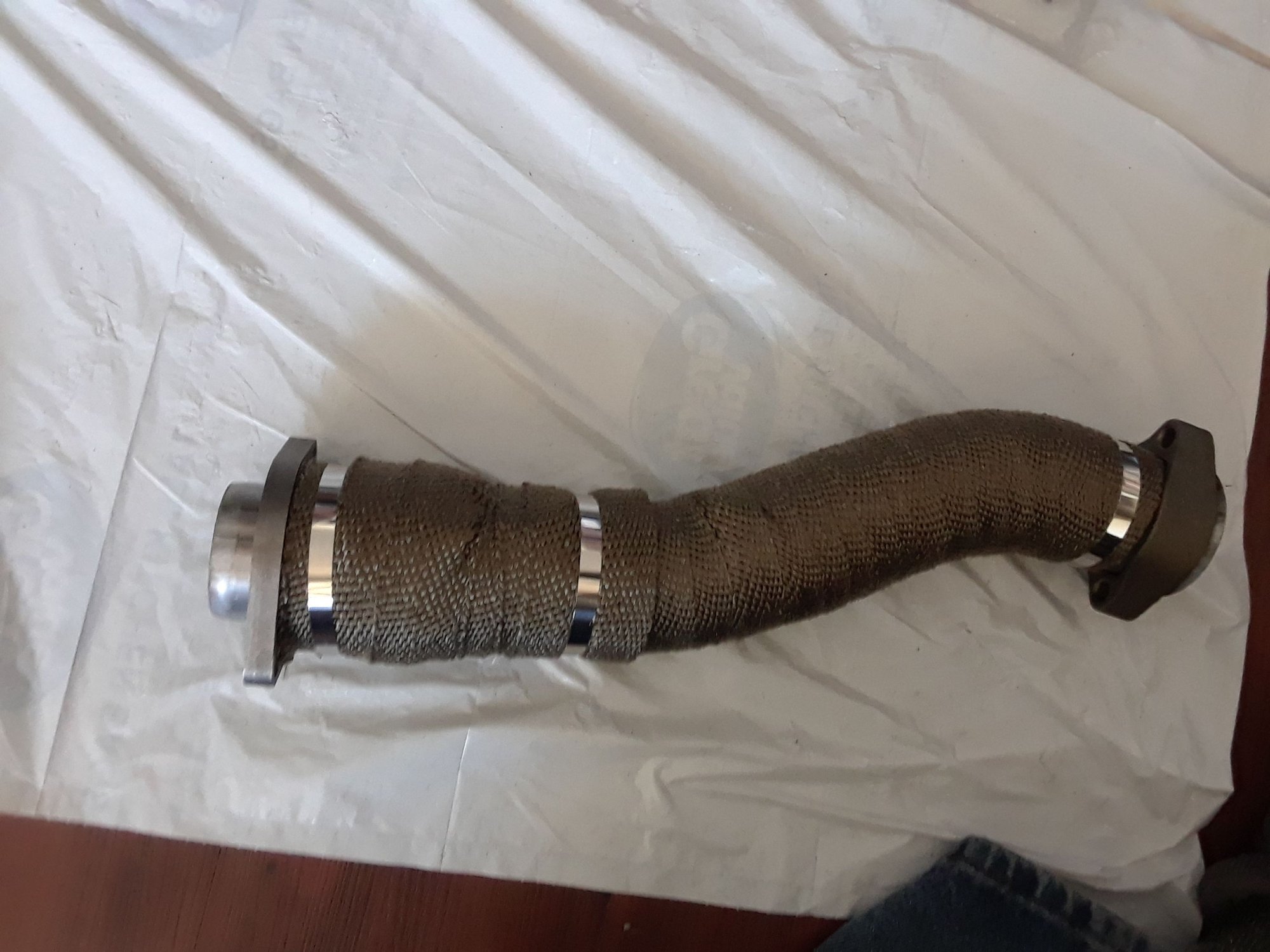

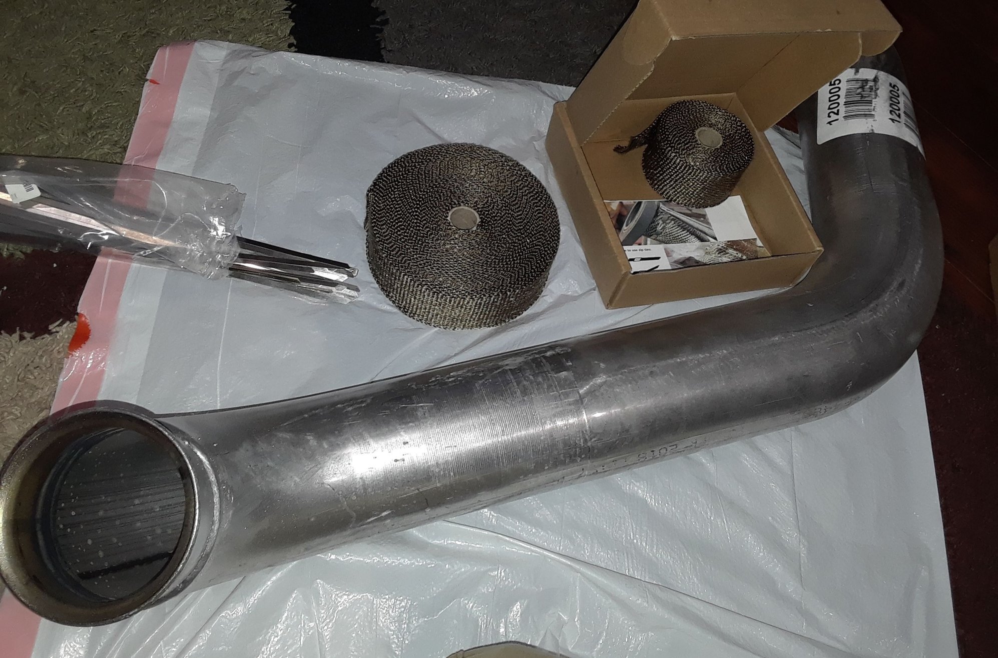

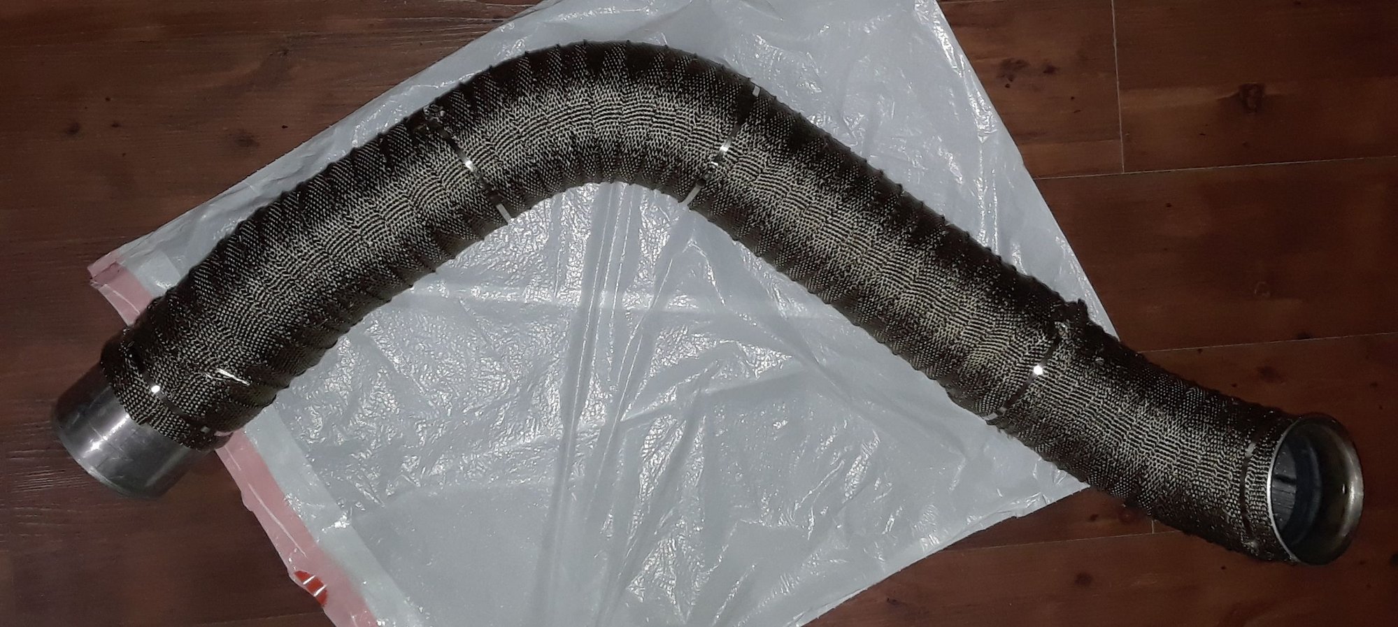

I wrapped my bellowed pipes...
Uppipes
Wrapped
Wrapped
Installed
4" downpipe too

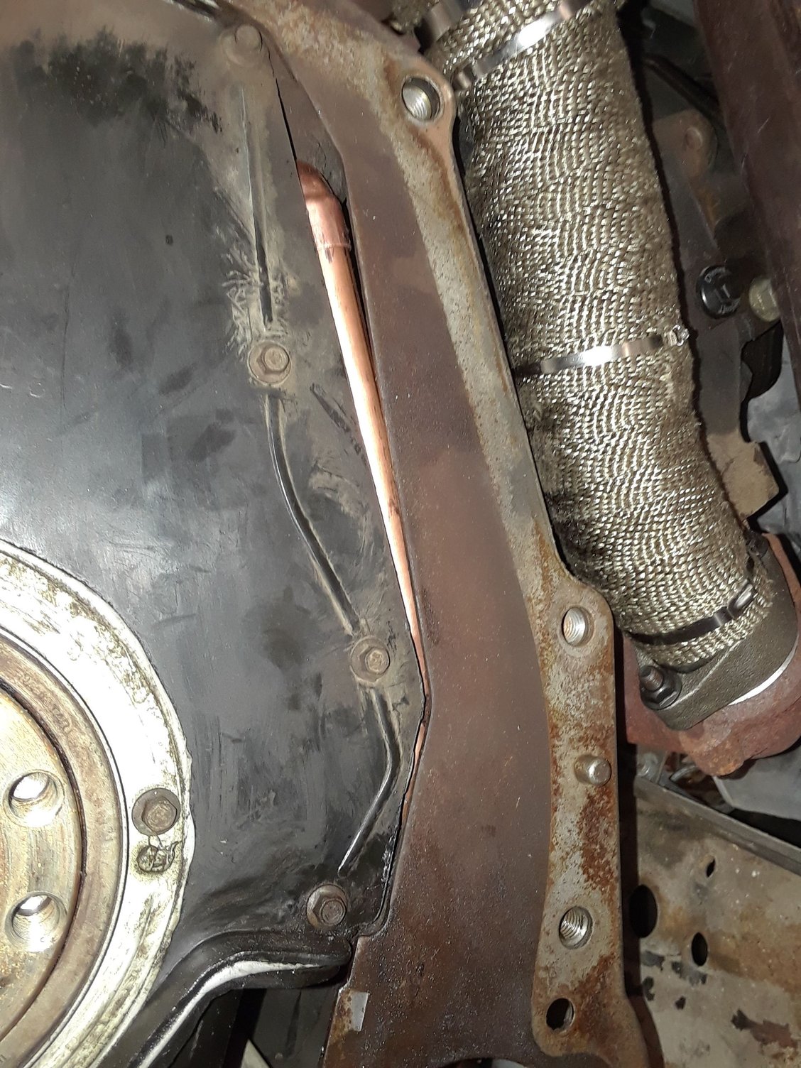

Wrapped
All my "hot" exhaust parts are wrapped, the uppipes and the 3 exhaust pieces after the turbo underneath the crew cab. I believe i used 40' for the uppipes and another 110' for the exhaust. So far my turbo hasn't melted
