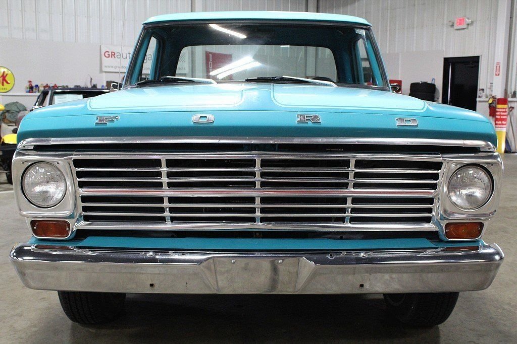

Couple I found online The first 4 are non ranger grilles, the last two have the ranger emblem in the center of the grille. Also note the Light Blue Truck and the Faded Green truck are actually 70-72 hoods and stone guards as they have the larger F O R D on the hood and there is a larger gap around the turn signal on the stone guard.

Hood is the same 1967/72 F100/750, the only difference are "add-ons." Hood letters, emblems and the 3 piece hood nose moulding used 1970/72.
Ford replaced the 1967/69 stone deflector with the 1970 (1970/72) stone deflector. 1970/72 fits 1967/69, but 1967/69 will not fit 1970/72.
D0TZ-16612-A (replaced C7TZ-16612-A) .. Hood Panel / Obsolete = 1967/72 F100/750.
D0TZ-17A862-A (replaced C7TZ-17A862-A) .. Stone Deflector / Obsolete = 1967/72 F100/350.

The hole pattern for the emblems would be different for 67-69 vs 70-72 and that is what I meant by the two trucks having a 70-72 hood. Physically the same in shape 67-72 only difference is the holes.

The hood side emblems w/the yellow reflector lens for 1968/72 F100/350 are the same. 1967 hood side emblems don't have the yellow reflector lens.
When you bought sheet metal from Ford, there were no holes punched out for letters, emblems, mouldings, name plates, because some trucks didn't have them, or if they did, may not have been located in the same place.
