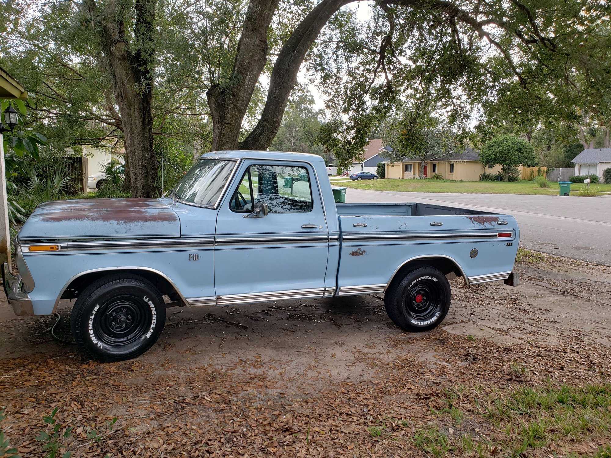

I’ve recently bought my first “old truck” a 1977 Ford F100 Custom. The price was something I couldn’t walk away from. Any recommendations on things to do on it?

The roof rust is going to be a problem sooner or later. Once it gets to the windshield it'll be tough to repair. My Brother had some rust right above his windshield and he had a guy fix it with lead before a repaint. You may be needing that soon.

The basics first for safety and reliability. Change all fluids/fliters including transmission auto or stick. If it wasn't being driven I'd totally redo the brake system, master cylinder, wheels cylinders, calipers, shoes, rubber brake hoses and close inspection of the metal lines. Replace any steel lines that have scaly rust on them that can be flaked off. Insure the emergency brake works and repair if needed. Replace any rubber fuel line hoses. Make sure steering is tight and repair any looseness. Make sure all lights and signaling systems work properly. Looks like the driver side headlight is hanging out a bit. Check the age of the tires and visually inspect for dry rot/cracking.
Then after that you can start to work on cosmetics inside and out. The body look pretty straight and rot free so that's a good thing. As far as the surface rust on hood and roof you'll want to do something with that if the truck has to sit out in the elements/rain. There are various options depending what your personal taste is and goal with truck.

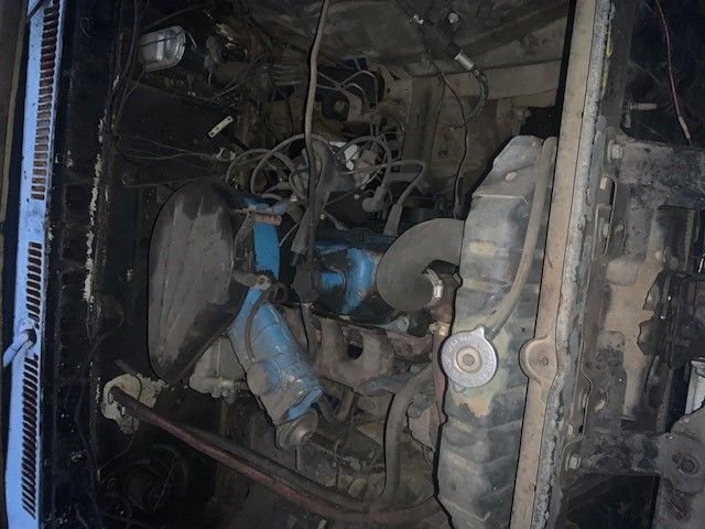

Thanks! It's 2WD 3 on the tree. The engine isn't original from what I was told it's a 300 Inline 6 from a Mustang (I really don't know). I'm very new to anything mechanic oriented, but I want to learn and this truck, believe it or not, belonged to my father in law in the late 80s into the early 90s and bought it from the original owner and through several owners, it happened to resurface years later. So for $500, I couldn't pass it up. It runs about as good as a 40+ year old truck would be expected to. As far as driving around, I am just wanting to use it as a run around truck, not a daily commuter. Here's what the motor looks like if anyone can give me more info....

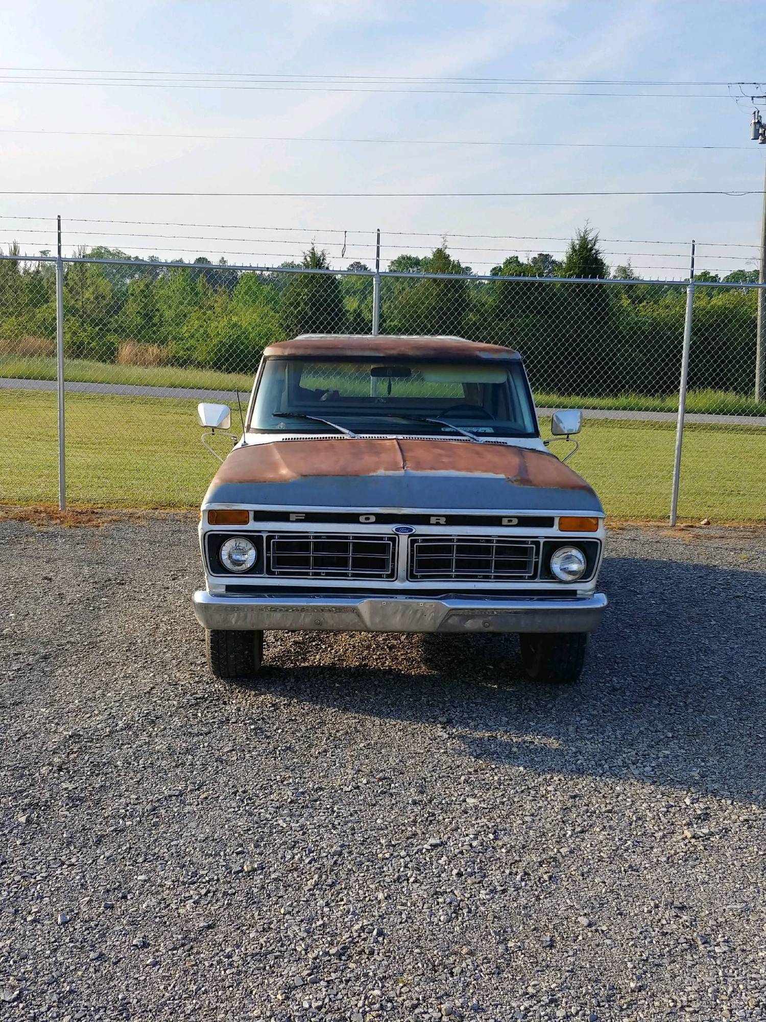

Here are my 77 and 73
