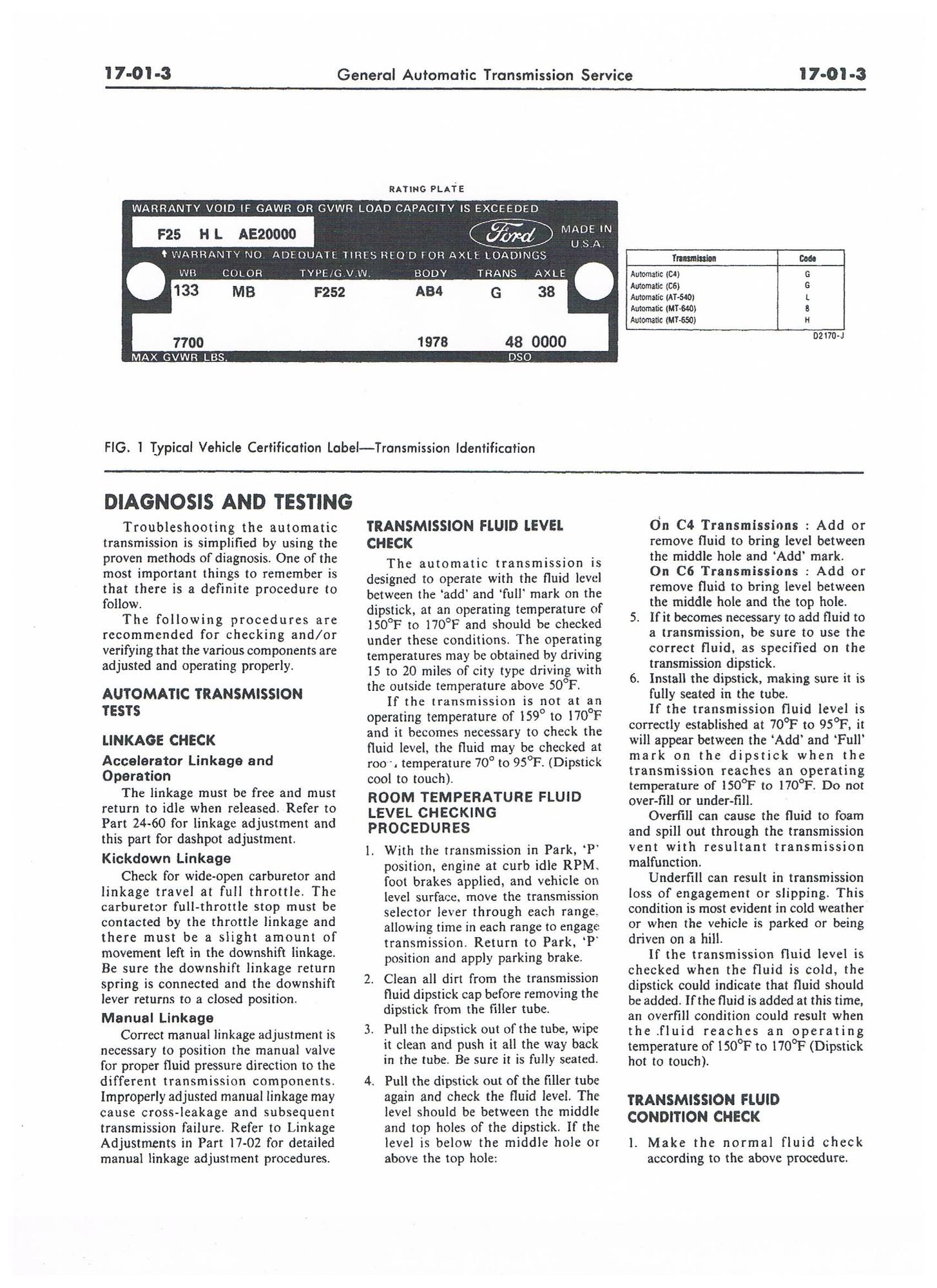

1978 Truck shop manual - Kickdown linkage.
