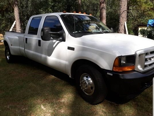

I am swapping the motor/ dash out of a 2001 F350 XL work truck into my 2000 4x4 excursion. the plan is to keep the trans out of the excursion and swap all 7.3 components; dash wiring, gage cluster, fuse boxes, ECM, inter-cooler, radiator, hydro-booster, engine harness, etc. I want this swap to be like ford put this motor in themselves. It will be a complete swap done RIGHT, no cutting corners. I plan to have all functions working and no CEL. And after the 7.3 swap is done I plan to put the v10 dash, motor, etc. into the F350 and make it a running/ driving truck and sell it to re-coop some obvious expenses for this swap.
About the F350:
240,000 miles XL truck with bench seats, rubber flooring and manual locks and windows. I bought this truck not running (because of 2 badly dead batteries and the owner ran it out of diesel fuel) for 3,000 dollars As is. The owner blew out a hydraulic line in the power steering because he was flat pulling it back to his house downhill without the truck running laying into the brakes. So before I start yanking out motors, I am going to get this 7.3 running like a top while I can still test it in a truck. I might end up pulling the valve covers and replacing injector cups and turbo seals while I'm at it too. once the motor is pulled I will re-seal all known problem and hard to get to seals (oil pan/ rear main seal). So, it already needs 2 new batteries (starter too probably) and new power steering hoses, and I should have a good running motor to swap.
