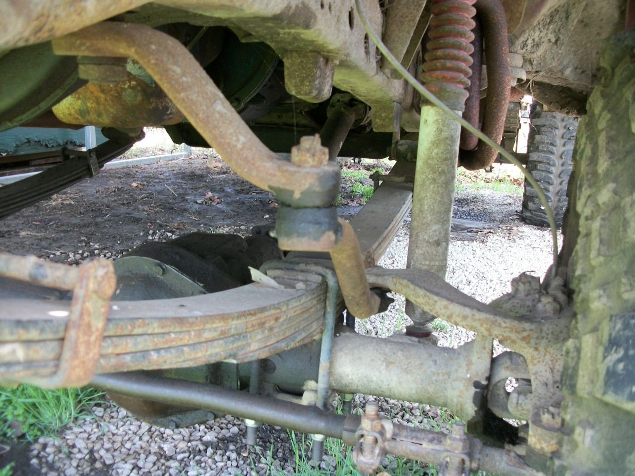

Welcome to FTE, I will try to answer the best I can. As far as your "parts" truck, are you/the owner sure it is a F150? Meaning 1/2 ton and each wheel/axle has 5 lug nuts. Because MOST F150's (1/2 ton) 4wd have a radius arm and coil spring front suspension. Unless...like ND said, if it is a SC then it can have front leaf spring suspension. And still be a 1/2 ton with a 5 lug Dana 44 axle.
Most common (I would say all, but I do not have a fire proof suit on) 4wd 3/4 ton F250's have front leaf spring suspension and a most common 8 lug Dana 44 axle. D44 has ball joint mounted steering knuckles, but the F250 can come with a not so common Dana 60, easily Id'd by kingpin mounts steering knuckles.

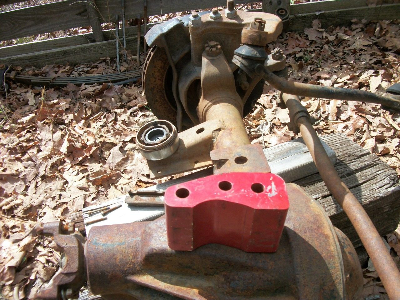

Also (all?) F150's have a Dana 44 and F250 4wd also have the more common Dana 44, or if you are lucky a Dana 60 is under you F250. But not an option on a F150. Also the F150 has the Y or T steering linkage set up. And that "horseshoe" shaped piece (steering arm) you are talking about is a F250 steering component. (Only?) It is held onto the top of the dvrs side steering knuckle by 3 long threaded into the steering knuckle studs and then 3 nuts. Bottom line, YES it comes off and people put a "steering block" in there as a cheap alternate to a drop pitman arm and adjustable steering link.
Pretty sure when I say it is not a F150 common steering linkage part. But if the truck is a SC then I will say I do not know what you might have going on.
Dana 44 info https://www.blueovaltrucks.com/tech-...id-front-axle/

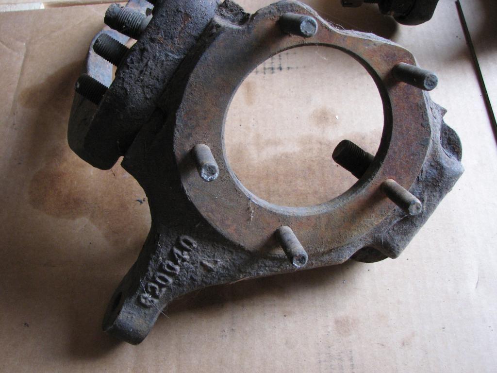

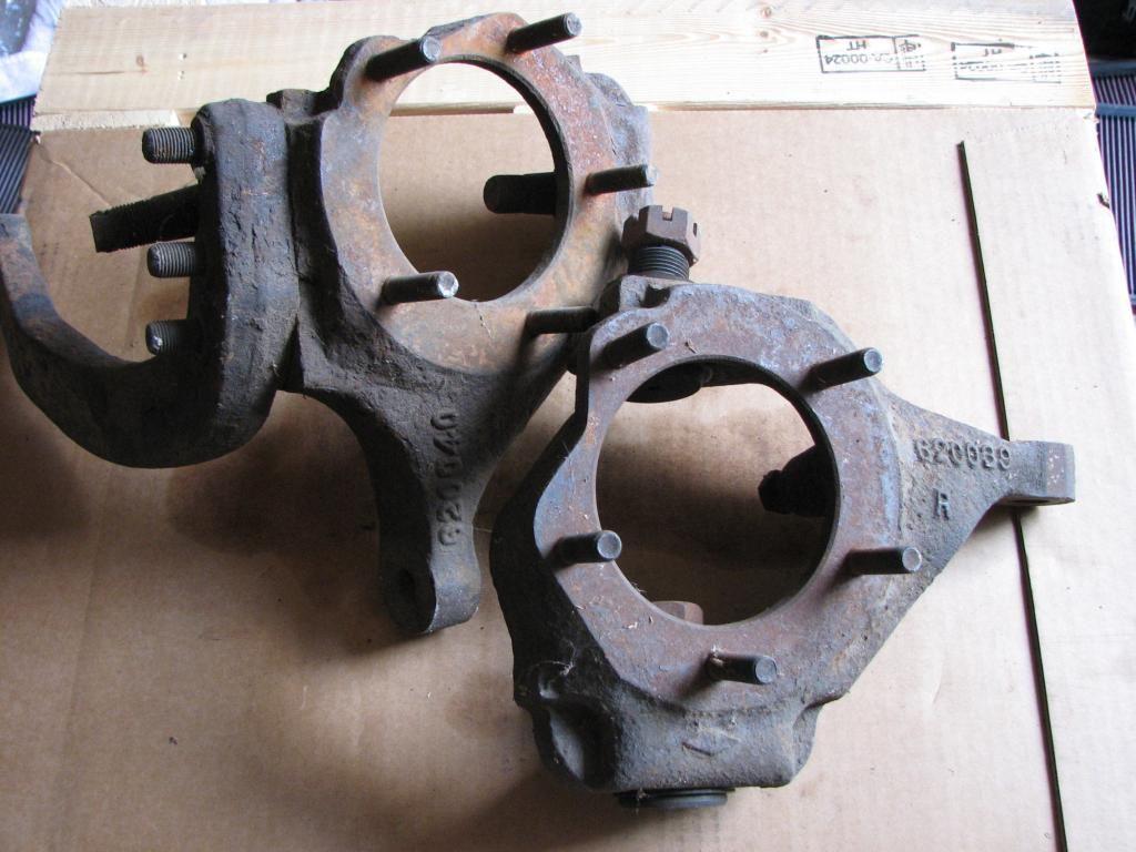

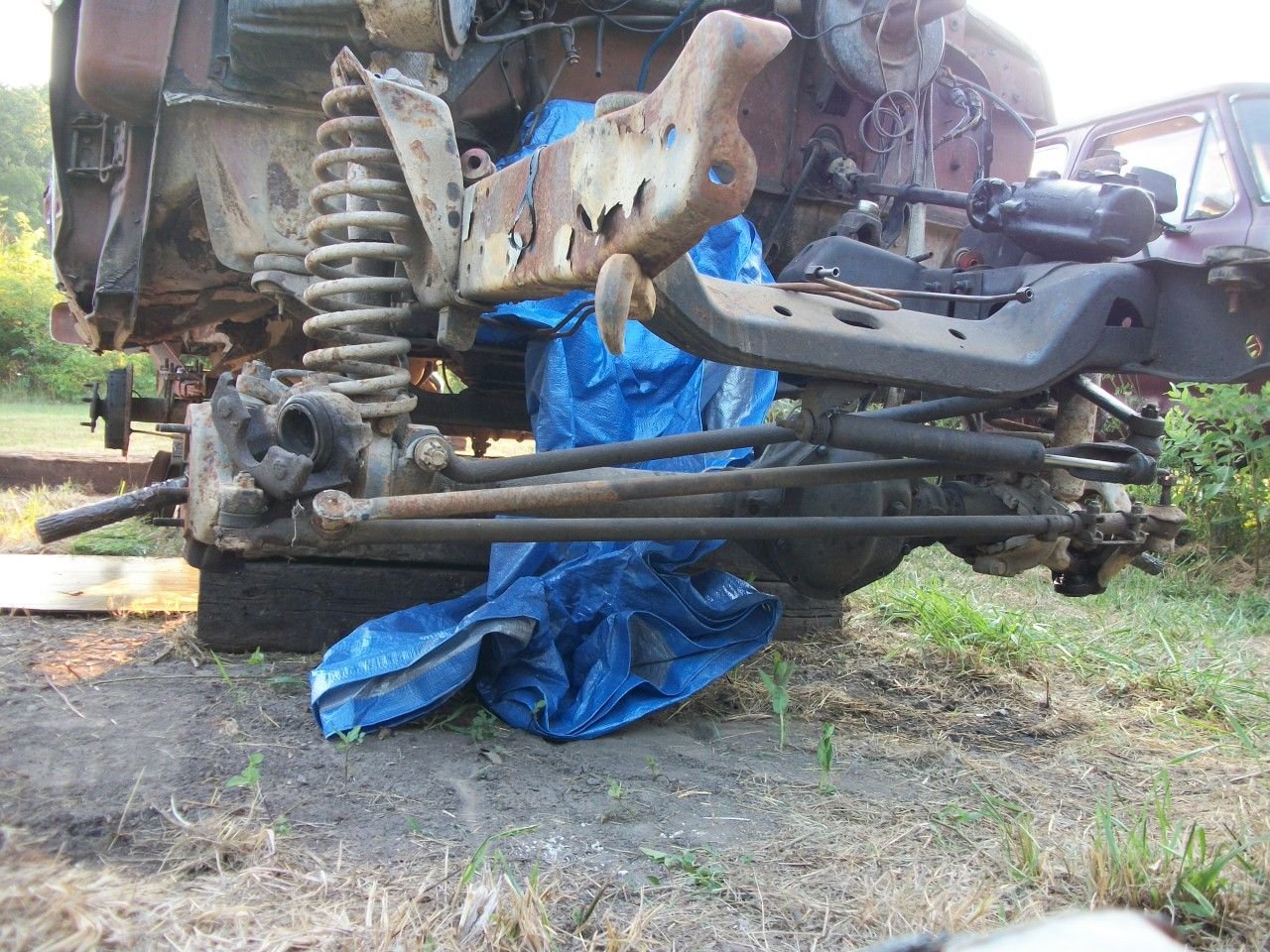

1st 3 pics are a 8 lug Dana 44. Then a Dana 44 under 79 Bronco. And I know I have never seen a horseshoe shaped "steering arm" on any 1/2 ton 4wd front axle trucks or Bronco's. I have only ever seen ONE SC 1/2 ton 4wd with leafs in a JY, and it blew my mind.
So I am thinking you are wanting to get the steering knuckle out..(and all attached components) and make your drum brake front axle a disk brake conversion? A good question is to know for sure if your current spindle is a 5 or 6 bolt on set up. I know that matters for sure when doing that conversion.
Here is a early Bronco place to get some more help with that exact conversion. https://classicbroncos.com/
To answer your questions. 1. Yes it is removable 2. No I do not believe so on that axle you are looking at using for your conversion. 3. Different steering knuckle. And from what I have read and understand, if you can source a 78/79 Bronco Dana 44 front axle you can use those parts to do the disk brake conversion.
