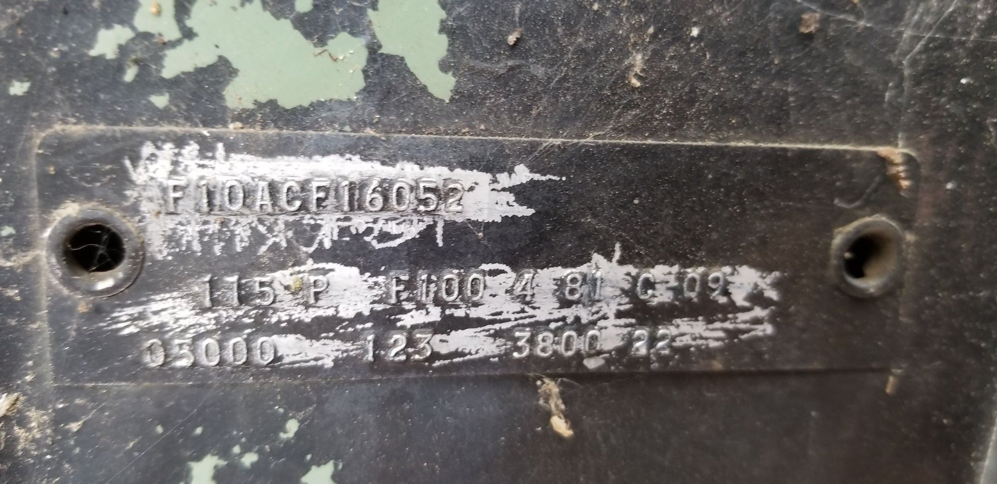

Can anyone help me decoding this vin plate. Thanks
Looking to buy this f100 and trying to get a little more info on it.

Originally Posted by ramseydj89
Can anyone help me decoding this Warranty Plate?
Looking to buy this F100 and trying to get a little more info on it.
Welcome to FTE
WARRANTY NUMBER: F10ACF16052
F10 = F100 2WD
A = 240 1V I-6.
C = Oakville Ontario Canada Truck Assembly Plant.
F16052 = 1969.
115" Wheelbase.
COLOR: P = Medium Ivy Green.
MODEL: F100 = F100 2WD, 5000 lbs. GVWR
BODY: 4 81: 4 = Charcoal Black Corinthian Vinyl & Charcoal Black Woven Thong Repeat Vinyl / 81 = 81A Standard Cab.
TRANS: C = Ford type 3.03 3 Speed Manual all Synchromesh Transmission.
AXLE: 09 = Ford 9" Rear Axle / 3.70-1 / No Limited Slip / 3,300 lbs. Rear Axle Capacity.
MAX GVW LBS: 5,000 lbs. Gross Vehicle Weight Rating.
CERT NET HP: 123 net HP @ 3,800 RPM
DSO: 22 = Charlotte NC Ford District Sales Office, where the original selling dealer ordered the truck from.
