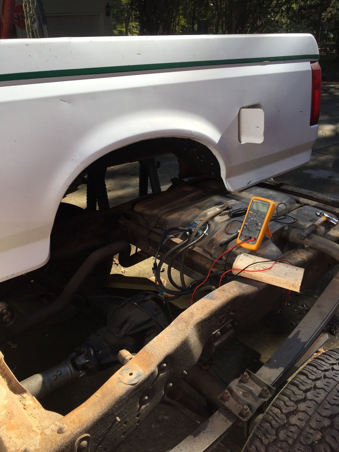

I make lots of bad decisions. This one is a 92 f150 XL 4.9 that has been sitting for about 10 years. It wont run. The only code is 542--fuel pump circuit failure. PO replaced the fuel pump. I asked him for the old one and bench tested it and it worked fine. In the process of replacing the fuel pump he cut the metal fuel lines and hose clamped hose to the cut metal. Those will have to be replaced. I have done the usual tests and working my way back. Wish me luck.

That is certainly possible. Testing the brown/white just behind the cab, I have a power for 2 seconds when switched to on or start. Shouldn't it be constant until pressure is up?

If you are talking about the fuel pump running about two seconds that is normal and all it takes to supply fuel. Sandy

I know pictures are worth a thousand words. It's been off the trailer but I dont take a bunch of pictures. Anyway, now I have done all the checks that I know of. I have just a moment of power to the pump then, nothing. Pulled the pump and tested it on the bench and it works. Does anybody know what direction I should go next?

I am not up on the newer trucks (80-86) but on them with electric in tank pumps when you turn the key to on the pump will run for about 2 seconds, like you get so that is good and shows the wiring to pump should be good.
Now IIRC they use a fuel pump relay and they can go bad, think it is under the hood.
Some go thru a oil psi switch that will turn the pump off if the motor is not running. How many wires go to your oil psi switch?
Now if the switch is no good then no power to the pump(s) but you can jump the switch out for testing just make sure you get the right wires.
Then there is a crash switch. If the truck is in an accident it opens to stop power going to the pump(s) even if the motor is still running and drive could not turn the motor off.
In the 80-86 this switch is behind the glove box, don't know where it would be on yours even if it has one.
Hope this helps even if not for your year truck but cant see them changing much between years.
