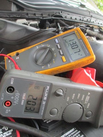

They alternate between the 2 under large loads, here's a few photo's after they switched.
I was impressed with both the voltage and amperage at high idle.

That's really interesting that they switch between the 2 alternators. Presumably to keep alternator temperatures down?
yes, they can get real hot within a few minutes with actual full loads, without the engine heat.
