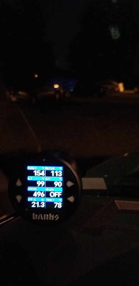

So thought I would throw this up here since there has been a lot of discussion on DPF/Regen and soot percentages.
This is what I have so far on the guage. Not sure what all of this means

I think the bottom left is DPF % in grams, but not sure how to convert that to what I have been seeing in the form of % for Soot.
The other DPFDIS is the distance since the last regen in miles.

So you're 4 miles away from this reported 500 mi forced active regen once at operating temp. Now we can see how many miles you make it before one is commanded. Does that factory exhaust screen not report at KOEO? Even as good as your truck is, at nearly 500 miles you should absolutely have more than 0% reporting.

Yes I believe that is the DPF soot load which is in grams. The DPF SOOT LOAD % PID did not work before the latest update on mine. When you turn on the truck and the iDash boots on... when you see the boot screen with the teeth, the version number is on the bottom. The new one is 1.18.1. Here's my pics...

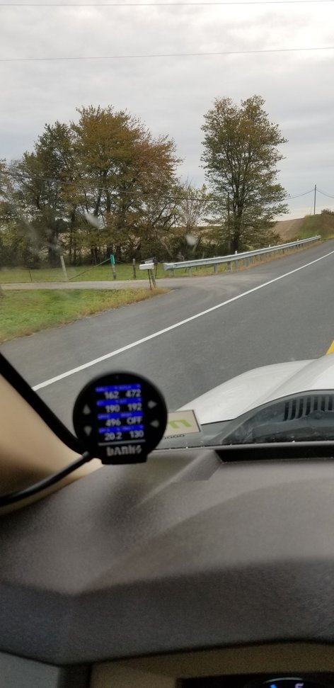

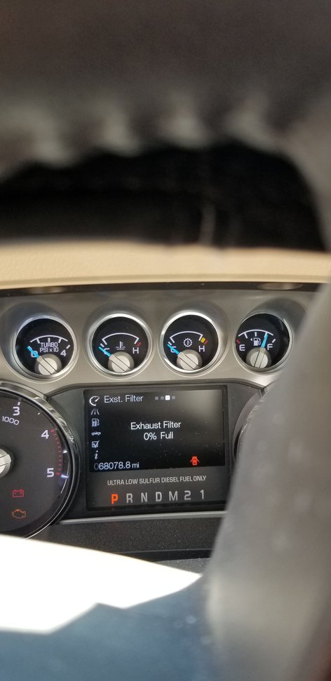

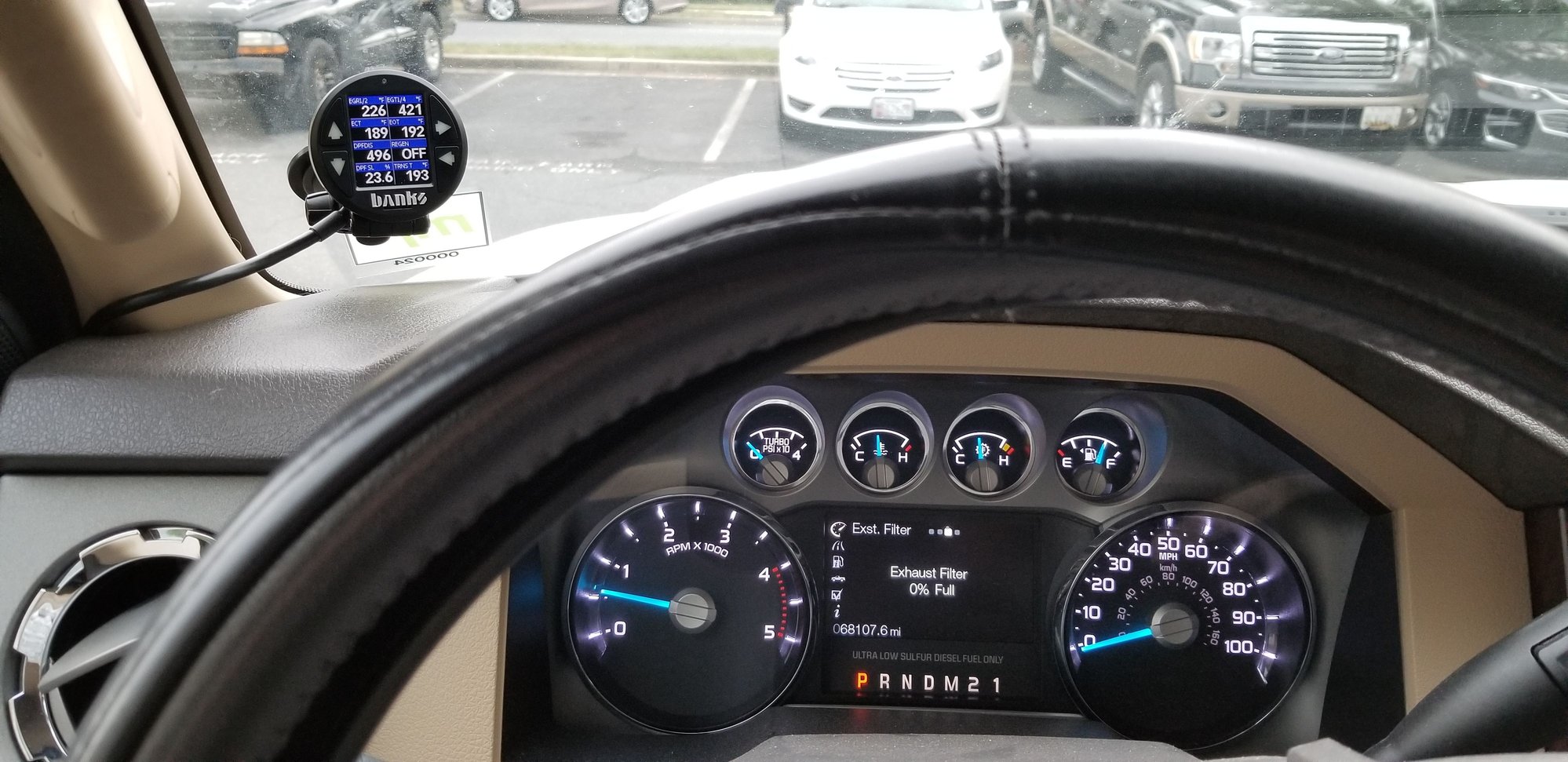

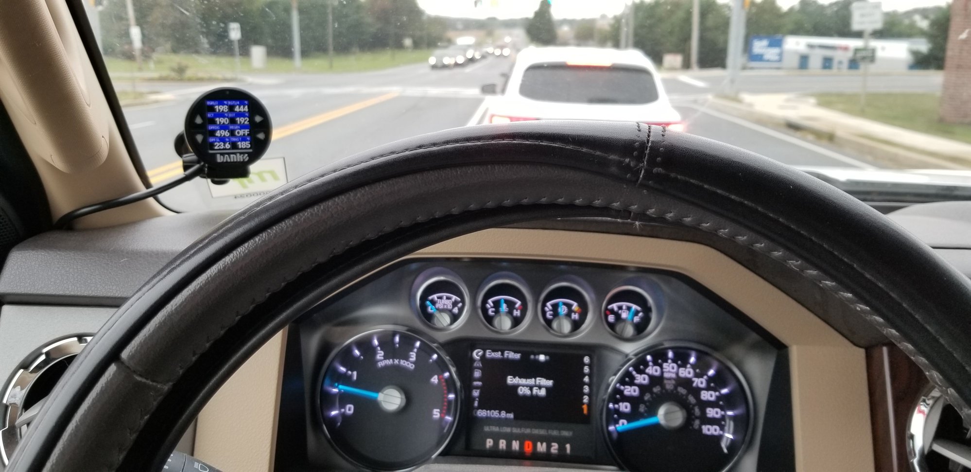

So drove the truck this morning out to the trailer yard and back. Total miles was 29. Hwy speeds around 55 to 60 mph. What I notice is if my EGT 4 stays around 450 the truck holds at the same or close to the same DPF % full level.
What we all know is also true, stop and go on the way back yielded a slight build in soot %.
My conclusion on that issue is my truck passively regens more than anything else. Therefore, my regens are quick and few.
DPF Distance since last regen did not move, even though I drove 29 miles. So that value must be a recorded value from the last two regens, I can distinctly recall a regen 1st week of Sept. I can also recall last week my soot % according to the truck had reached 35% but then I went on a 100 mile run with the trailer and now it is at zero% on the dash.
Trans temp, oil temp are pretty close to the readout on the idash.
enroute
at the yard
drive home
end of trip.

Heres another though on the readout of the dash vs reported values on the idash.
Several report the exhaust filter % either will not go to 100% before a regen or will not go to zero upon a completion. Mine has always read full before a notification and then goes all the way to zero. The readout is not accurate!
