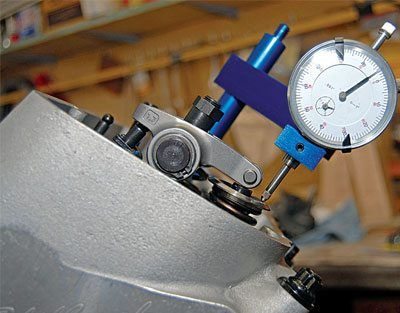

You can determine the amount of wear in the valve train by using a magnetic dial indicator. Zero the dial indicator when the valve is at maximum lift. Measure the lift of each valve at least twice and then average the results since you can't set the dial indicator in exactly the same spot when using the magnetic base. Like this:
