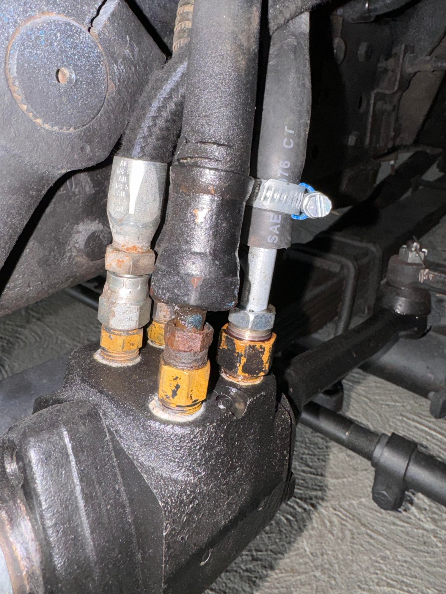

Referencing this photos taken from the truck, do you think the pressure hose should be replaced, could be the letting in air into the system?

Possibly but I would think it would leak fluid. The two go hand in hand. Under pressure it would leak.....have you jacked the truck up and did the proper bleeding procedure? Using Type F fluid...red fluid...?: When you have the front in the air, check the knuckles/hubs for play.
