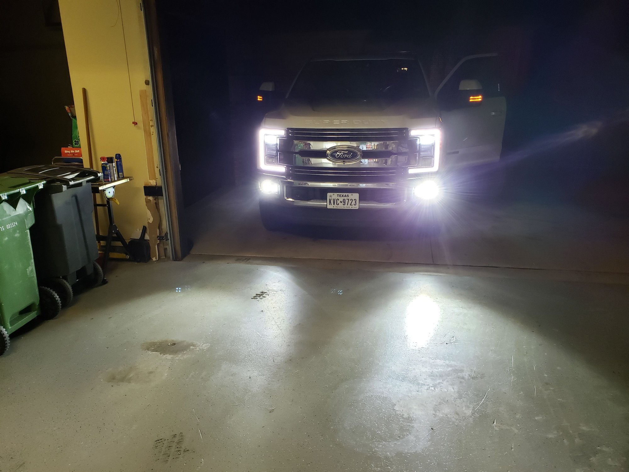

I run the KDF brackets with a pair of Rigid floods and a pair of their spots. I went with the Rigid's because the color matches the color of the OEM LED's. On a 2 lane road, the floods are too bright to run and I get flashed by just about every car. But, on a divided highway, no one flashes me and they light up the sides of the road great. The spots fill in the area between the high beams nicely. I used the KDF harness to connect the floods to factory fog light switch and I ran the spots to one of the aux switches.

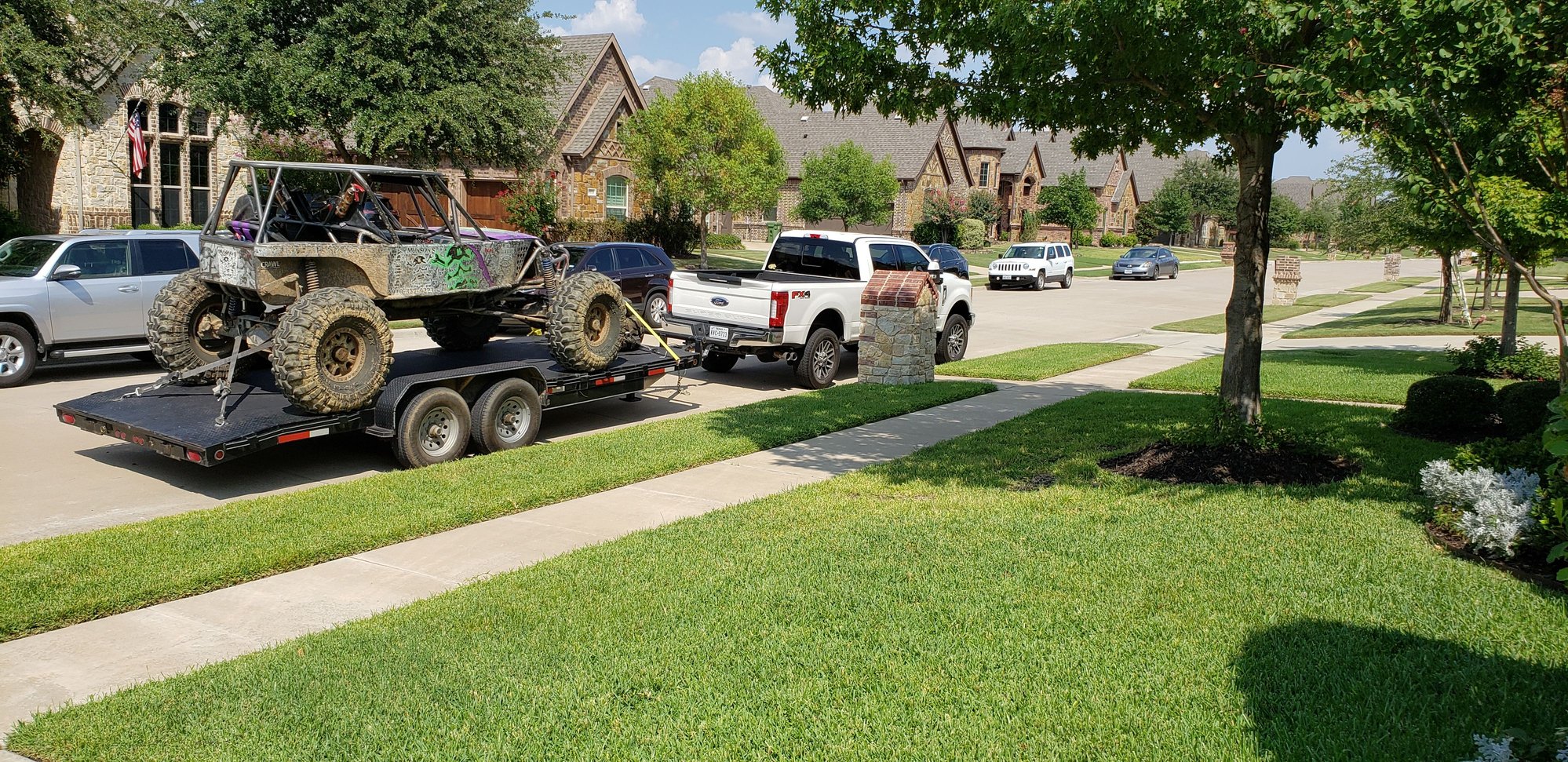

Sure, I'll try and remember to take some this weekend and send them to you. But, post up a pick of your Bronco! I wheel this every chance I get (unfortunately, It's currently sitting in the garage with a cracked transmission bell housing)..... Full tube chassis, 383, TH350, Atlas II, 'tons, forged raceline monsters, 43" stickies.

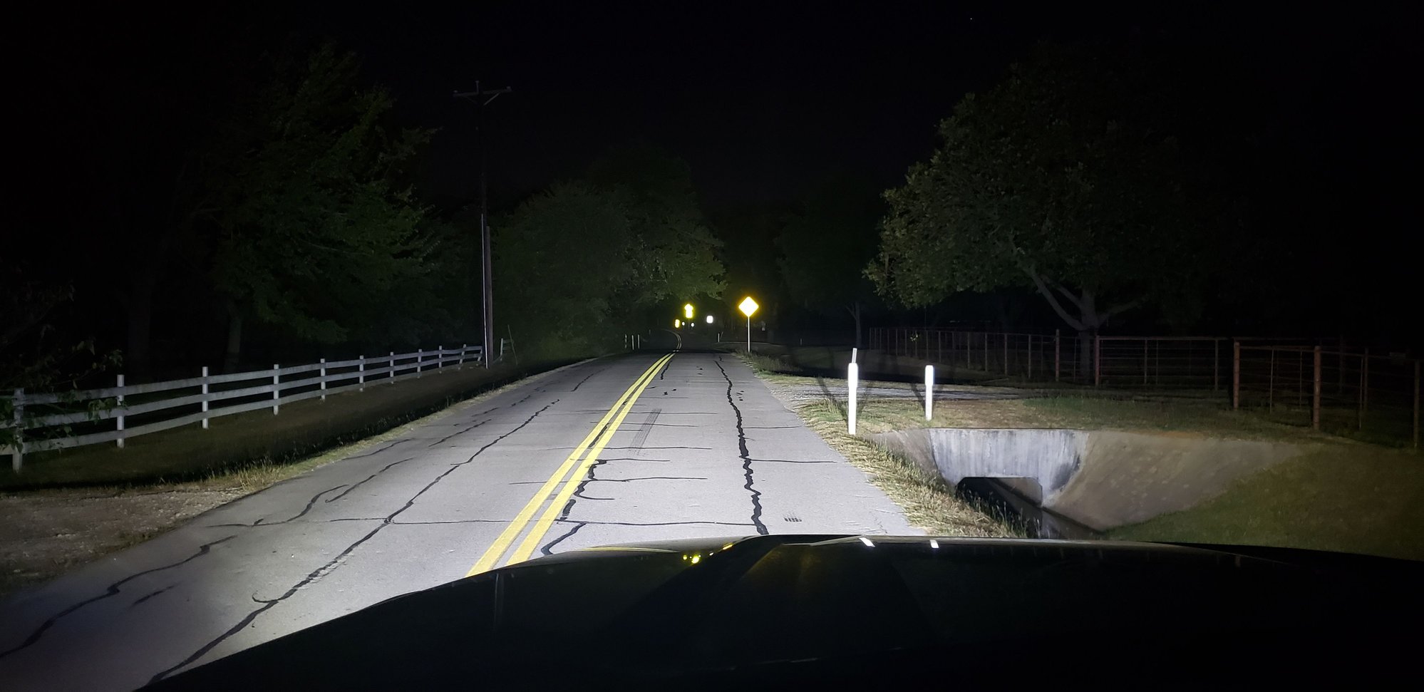

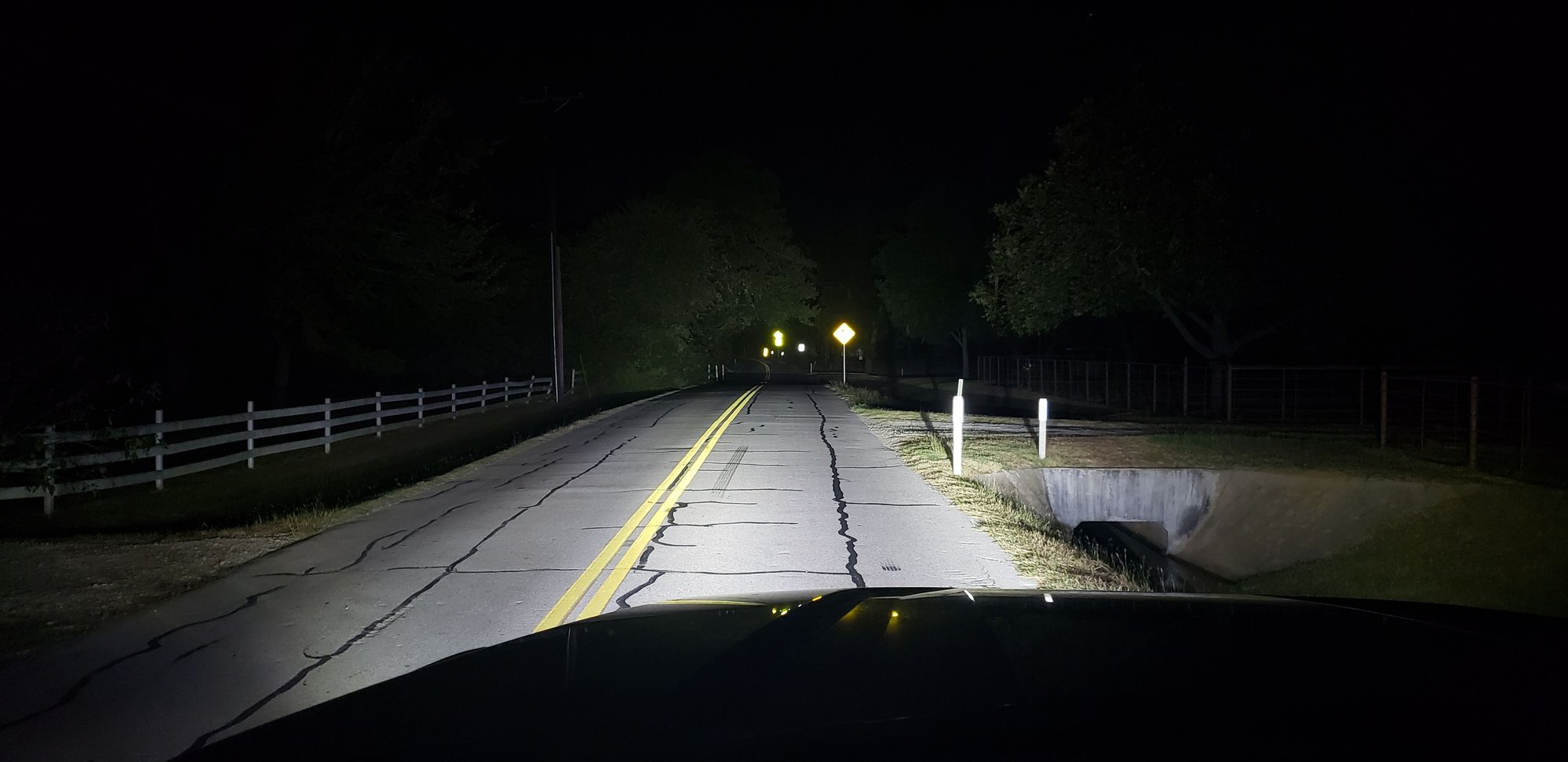

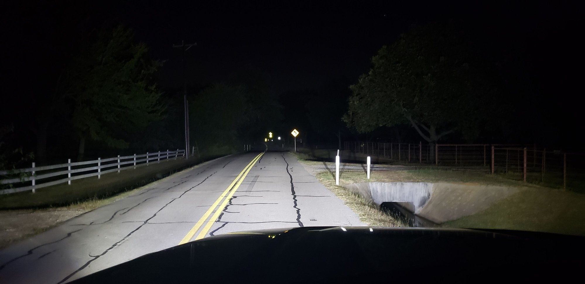

Here you go. I had a couple Amazon gift cards so the lights were free. The only thing it cost me was the cost of the brackets -- yes it was worth it. They throw off a lot of light, so even if I would have paid for them, I think it was worth it.
Low Beams
Low Beams + Rigid Floods
Low and High Beams + Rigid Floods
Low and High Beams + Rigid Spots
The last pic was supposed to be low and high beams + both the Rigid floods and spots but it appears the floods got switched off? In the pics, you can't really tell a difference with the spots on vs. off but in the real world, they make quite a difference on a dark highway.

Thank you very much. I'm mostly after some width to the light output to see beyond the shoulders of the road. It looks like it really lightens up that fenceline quite a bit!
