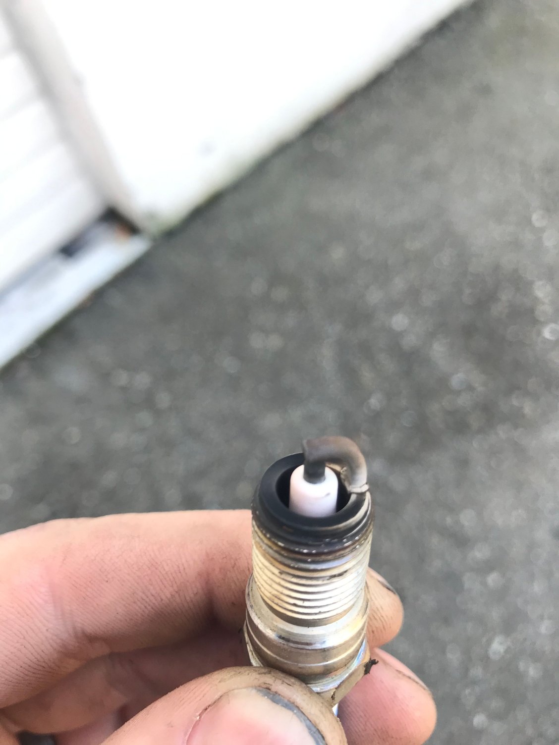

Post a sharp clear close up pic of a spark plug or two. There's a bunch of things that can be learned by looking close at how they are burning.

Here is a picture of one after about 100 miles on the plugs. I'll get more tomorrow, I think I'm at 800 miles.

OK, so they aren't running krylon gloss black, dripping with fuel. Thanks for the pic.

Get in the older tune-up manuals. Compression first, make sure piston rings and valves are in good shape. If it doesn't make spec or has uneven compression it won't tune-up no matter what. Plug looks pretty good, at least that one I guess, if compression test checks out focus on other tests. Ignition.

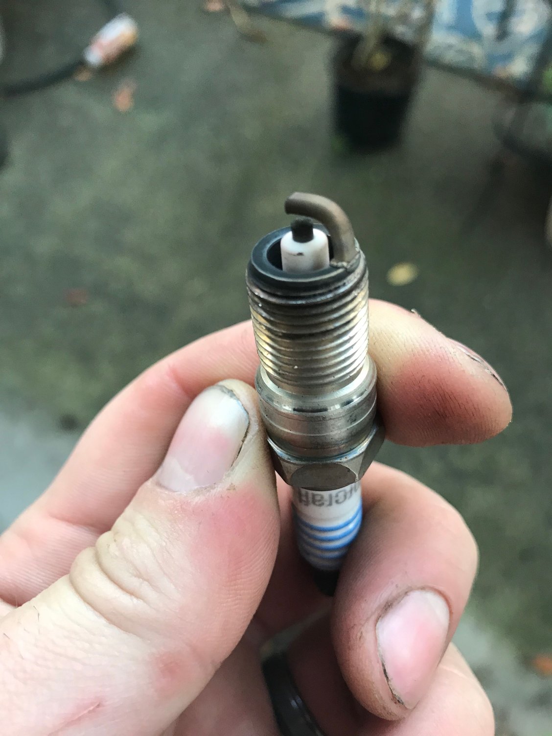

Here is today. About 950 miles on the refresh. I'll check advance at RPM today.

A tad rich, but not overly so. Unless you're looking to maximize the MPG's I'd leave it be.
