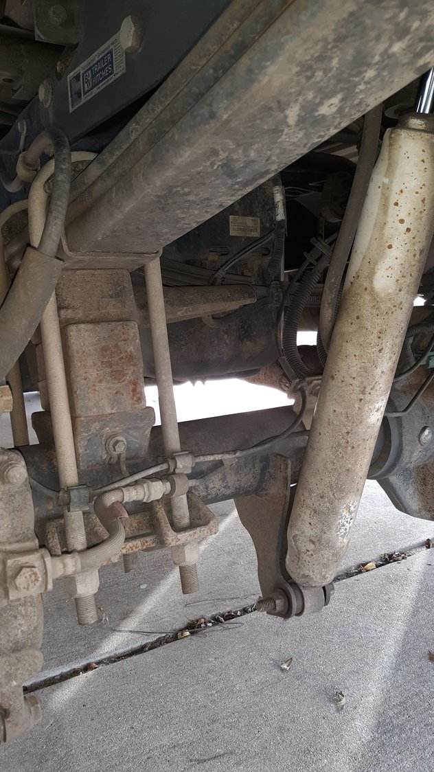

Was just wondering if anyone could tell me how much of a lift my 2012 f250 has,the truck came with 305 size tires and I replaced them with 35s.so was just wondering if it had been lifted or if 35s will fit the truck stock..thanks..

It appears to have been lifted according to the blocks in the rear and the spacers in front.

You may already know this, but it's time to replace all your shocks. They're spent.

time for some under body rust prevention too. You can tell it has been lifted looks to be about 4 inches too me.

I appreciate the comments. Yeah I know the shocks are worn, that's why I was trying to see if anyone know how much a lift was on it so I could buy the right shocks online.

That steel spacer above the coil spring and the larger rear block are not stock. That is where your lift is coming from. Measure those and you will know exactly how much lift you have. That is assuming those are factory springs and there is no aftermarket spacer under the bottom of the coil spacer.
These trucks will fit 35s with stock suspension on stock wheels. I run 37s on my 4.5" lifted truck, but a lot of it depends on wheel offset/backspacing/width.
