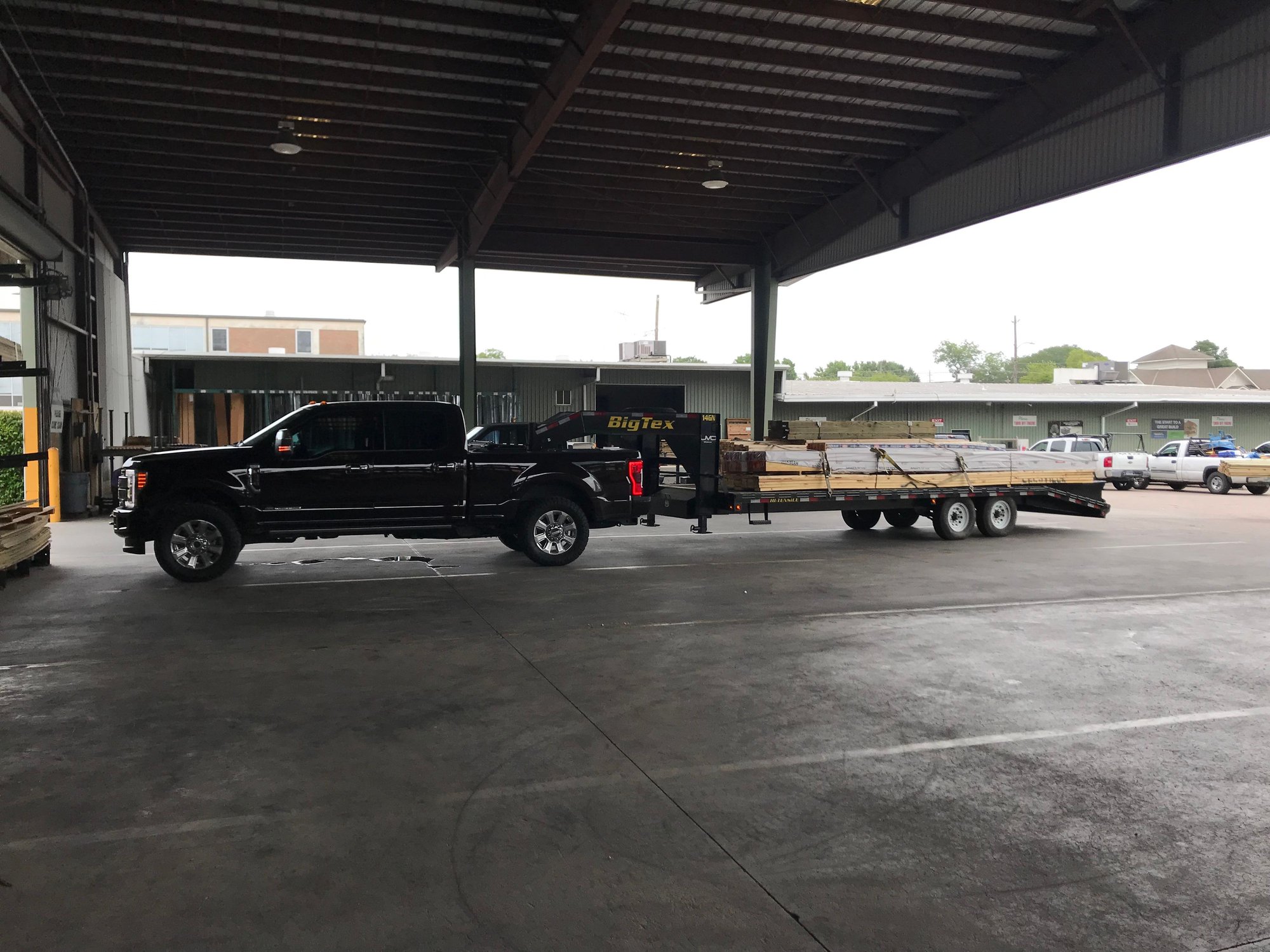

I would hook up first and see how it sits. Would rather a lower front end than dealing with airbags. 35s look great stock.
I have the HD front springs that are 1/2 inch taller and it looks great with 295s. Do not know if I would want to lift it anymore unless you have an f350 with the extra rear spring.
Here it is with around 15k, this trailer has fairly forward axles so little lighter on the pin. Probably around 3,000 including me/misc in the truck.
