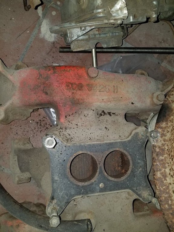

Good Morning All...I have an engine that I removed from my 1955 C600 parts truck(Edith) that Im seeking info on. Is this a 239? Do things like the seized high mount water pump have any value? I need to start cleaning up my stuff to get ready to move from the building where I am now. I have a year to do so so I want to start now. What should I do with this (seized) engine? What is it?
C2AE 6015 C casting number on the block
ECG 9425 H is the intake manifold casting number

Not an expert on casting numbers but here is a source: How to Decipher FoMoCo Part Numbers - Overview - FORDification.com
63 Galaxie FE block?

That’s a 1962 block, should be a 292.

All I know is casting numbers don't mean anything. But what I see the intake carburetor bolt pattern is not a
239. Its a much later Yblock for a 2bbl Holley or 2100 Motorcraft / Ford carburetor. Correct me 239 Y was a
one year block in 1954, then 272's 292's 312's - they all look the same only way is to measure the bore...sam
also high water fan getting thin now a days save that....
That's what this site says: Identify Your Y-Block
