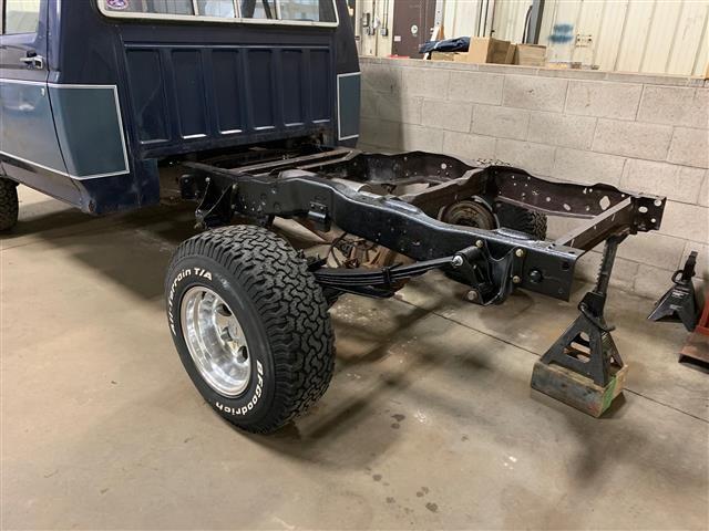

Originally Posted by mark1986F150
If it's a RWD chassis and Moog SB340 bushing doesn't fit I would recommend the Moog SB351.
Oh my bad, I should have mentioned that it is a 1995 4x4 chassis, so the correct bushing has a 3" shell, and 3.5" center sleeve. I ordered the Moog SB344, which is listed as fitting 1980-1996, but it looks like it only fits 1980-1993. The ATS RB-229 should be perfectly fine, but with the shipping and exchange and tax they'll end up costing me around $180 CDN. That's fine if I have no other choice, but I am going to at least check with the local spring shops tomorrow to see if they have the correct size.
Worst case scenario I can swap out the main leafs for a 1980-1993 set that the common bushings fit (like the ones I already purchased).
