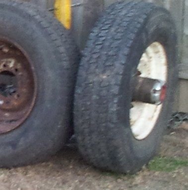

If you post a pic of your good hub I can see if I have one still. I know I have one entire assembly, from the spindle out. Just need to know if yours is a 44HD axle.
Hub I have

I am not sure what I have, all I know is they are calling for the possibility of 2 feet of snow this weekend and I’m behind the 8 ball. You know what the say about procrastination... also I just double checked, these are disk fronts...scabbed together plow truck...

I believe that's the lighter GVW axle, I don't recall the HD hub being sculpted it just smooth . look at your door tag, if it says 260 that's the light GVW, I think 270 had the HD axle.
Thanks man, but the door tag says it’s 1973 1/2 ton...go figure

that happens a lot.
We'll see if someone knows for sure but I bet you have the standard 260 axle.

Check the frame vin... the door could've been swapped and they didn't keep the old warranty tag. I don't recall 8lugs on a 1/2 ton. Oh could be an axle swap too, see if the tag is still on it?
Definitely doesn't LOOK like the 44HD but hey I'm no expert lol

Open knuckle so you have the 76???? up HD axle. Big hub as all the old farts called them.
