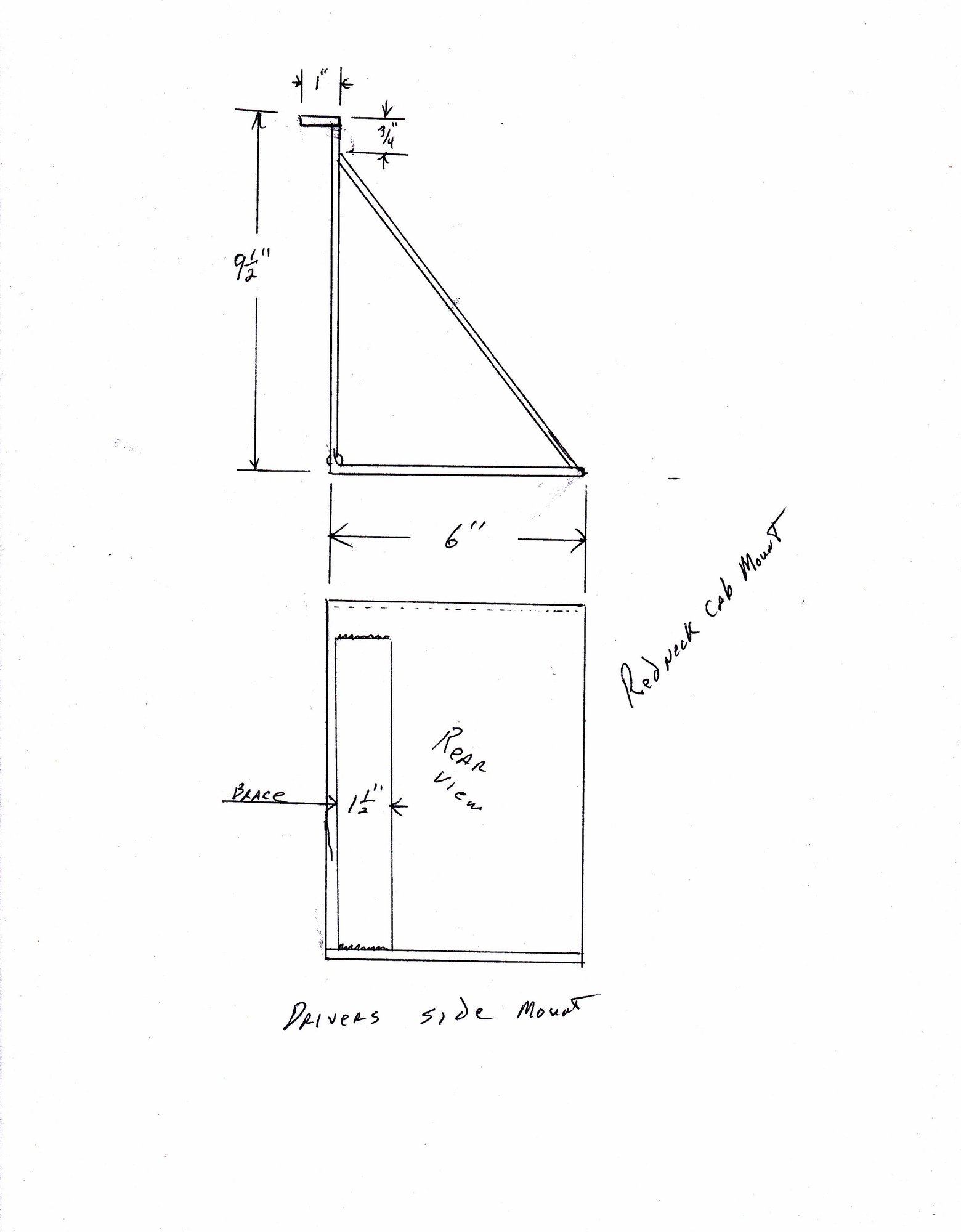

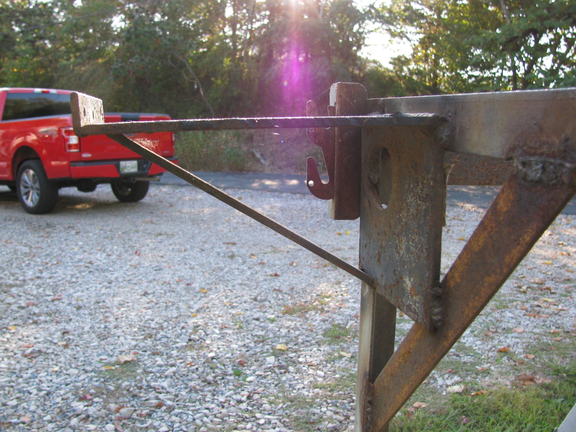

Redneck cab mounts
Here are a couple of pictures and a little drawing of those homemade mounts that were on my truck. The pictures are kinda wonky because they got repurposed on to my roll around paint rack. They are 1/4 inch thick metal.
I do not know why they made the hole where it bolts to the mount rubber so large but it should be 7/8 inch. Also these are 9-1/2 inches tall but the factory mounts are 9 inches tall. My guess is that they just made it to fit on top of some old squashed mount rubbers.
ok so the bottom of that redneck cab mount will bolt to the factory cab mount correct and how wide is it and what does the passenger side look like
