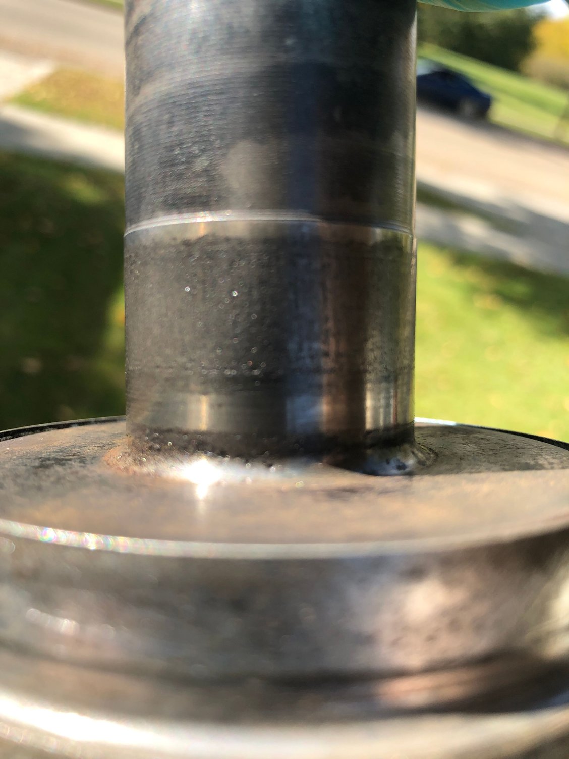

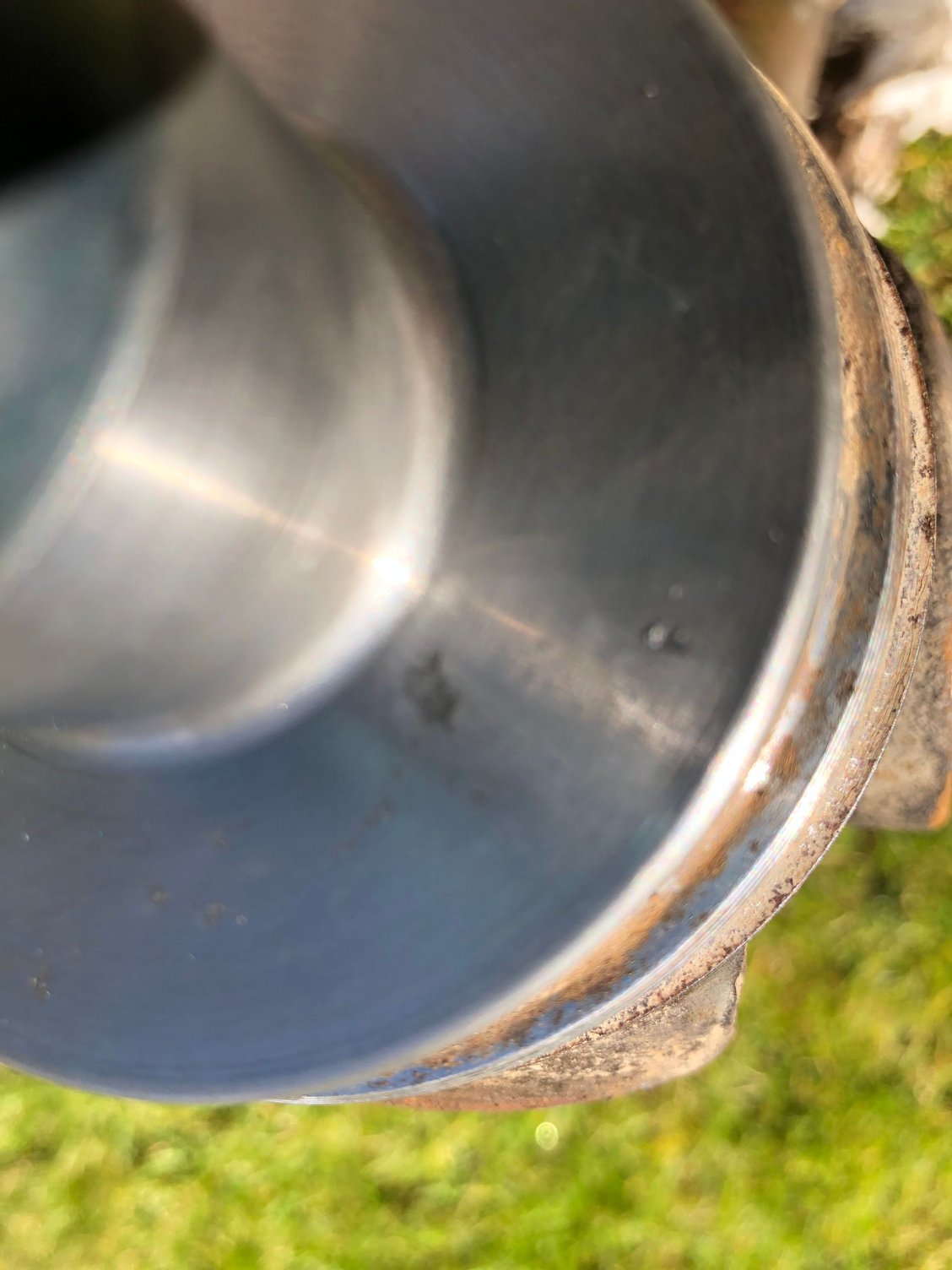

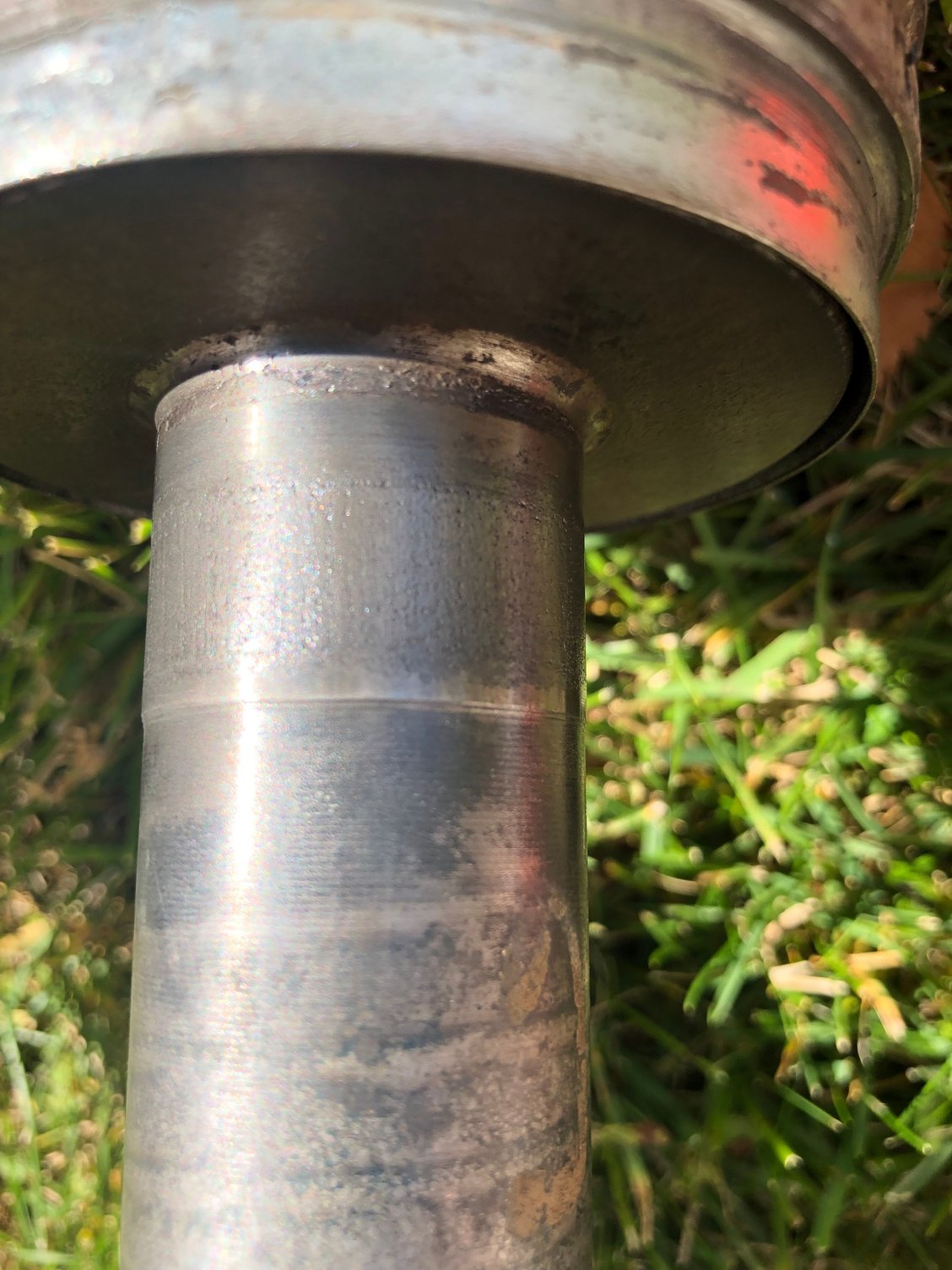

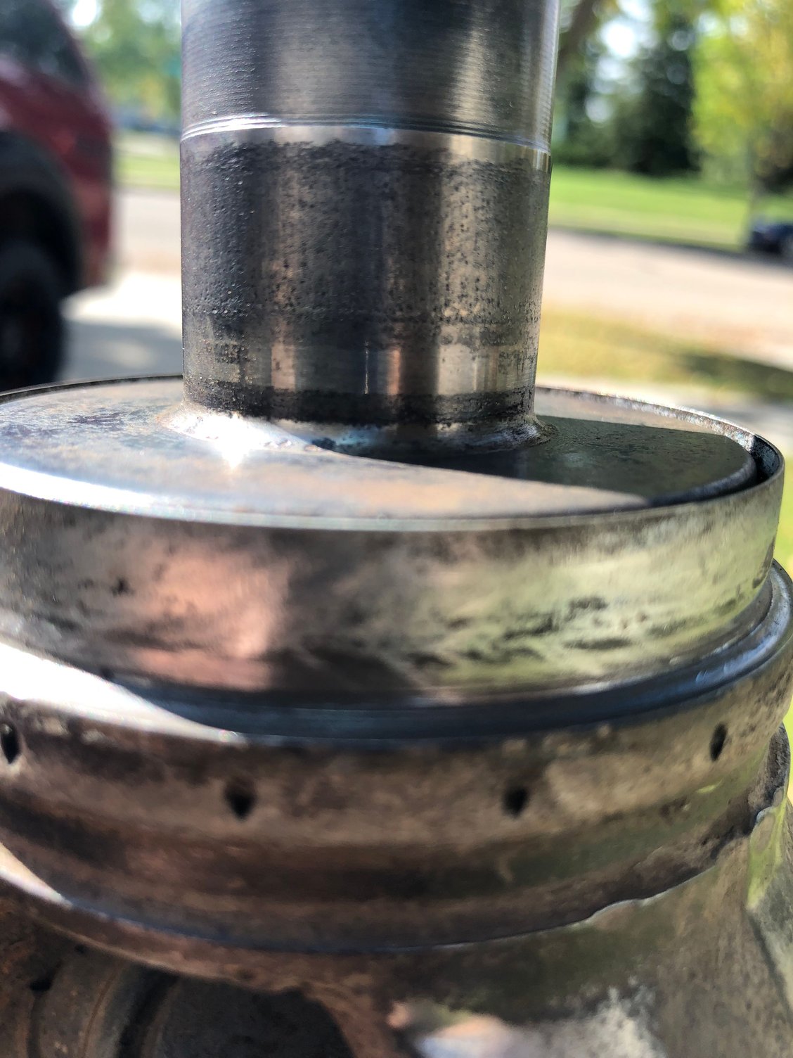

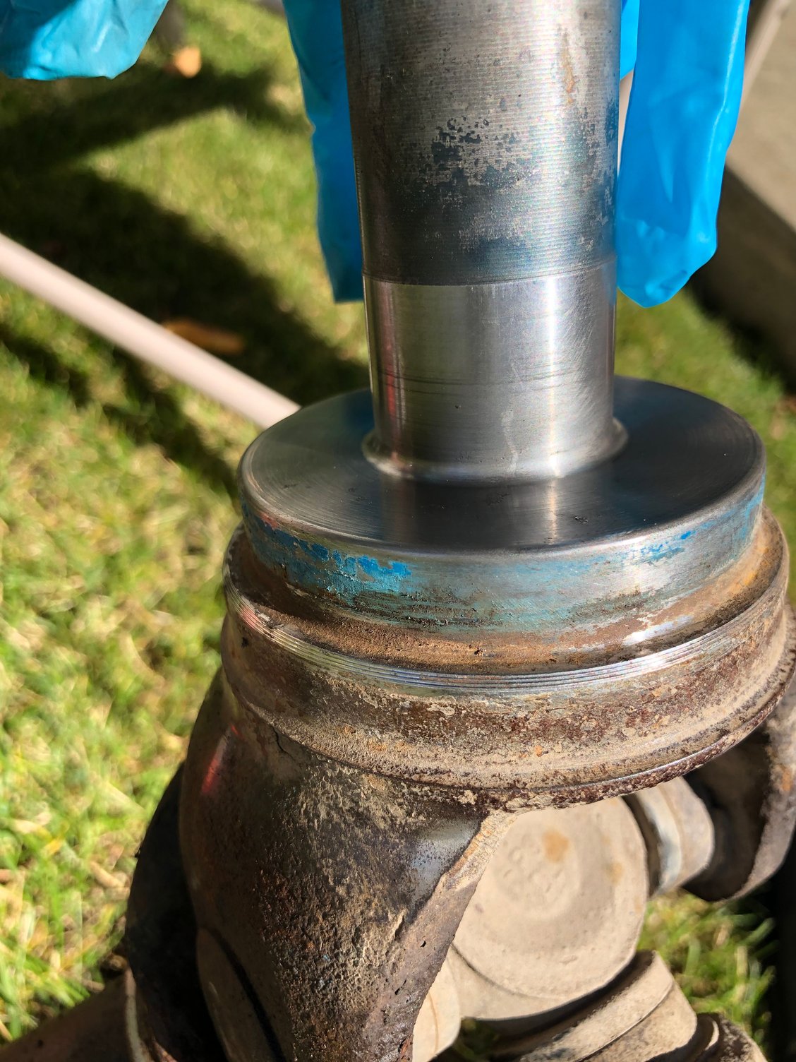

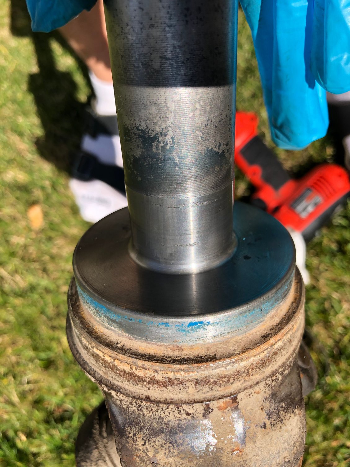

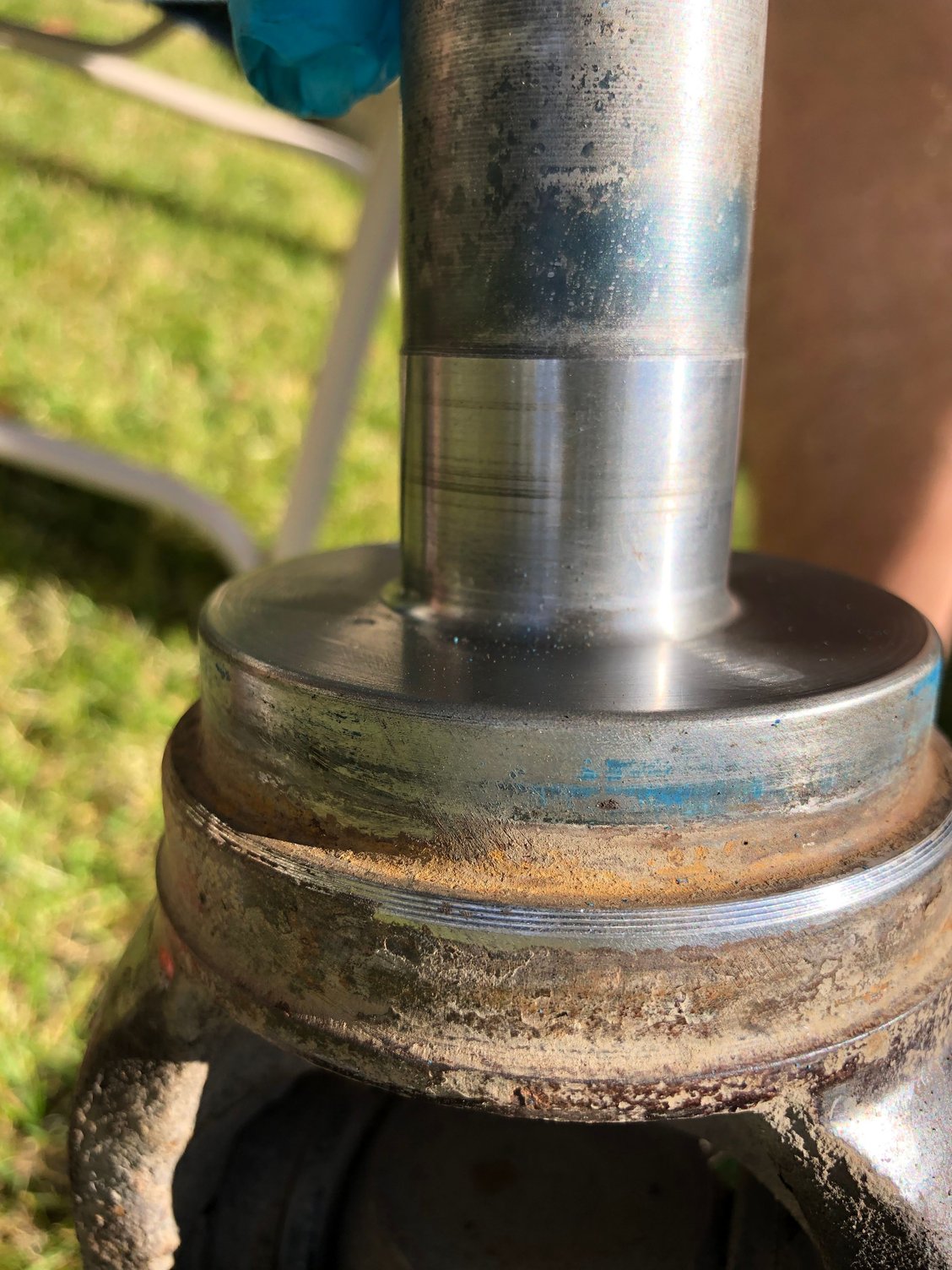

2. Bearings on passenger side were basically seized and axle shaft was scored. Drivers side bearings were better but two minor areas of wear. Is there any worth in the repair that moves new bearings to clear part of axles?

FYI, in that second picture, it looks as though the inner part of the seal is still on the stub shaft. As far as the wear on the stub axles and replacing them, I can't tell from the pictures if I would. I'd say if you can feel a significant lip there, replace them. As far as upgraded parts, I'm sure there are ways to upgrade the axles, etc., but unless you're doing some serious offroad driving I wouldn't worry about it.

Dynatrac Free spin kit will upgrade your outer stub axle to the dana 60 35 spline. but the real benefit is eliminating the failure prone no serviceable wheel bearings to a traditional hub and wheel bearing setup that can be rebuilt and serviced.

From my research on the topic, I have concluded that the axle spline count and taper (compared to a D60) isn't a real issue unless you are into some rough off-roading with tires >36"...most of the stories I have hard of breaking are from hard/quick accelerations in 4WD-Lo running way oversized tires. In day-to-day or slow going off roading they are more than sufficient.
On the bearing wear...as said before, I can't tell from the picture if I would replace it....it 'looks' pretty smooth and uniform, but if it fails the fingernail test I'd replace it.
Also, if you can swing the Free Spin Kit, it's a heck of a kit...I've been real happy with mine too

Added pics of axle stubs
Thanks so much for the feedback! Spent a few hours reading thru past threads last night. Thanks to all those who contributed to those posts! Priceless!
I added a few more pics of axle stubs. Would appreciate any additional thoughts if the bearing wear on them justify replacement. Have Timken bearing assembly’s on the way and although the Ex has 396kilos(Calgary AB) on it we hope to ride for another 400k, so worth being thorough.
Also read should only use emery cloth on the bearing riding section but (before reading) used a drill with small wire brush attachment to clean it up. Can’t imagine it would comprise the integrity with the abuse it gets from the bearings but I’ve been wrong many times before.

surface looks fine, i have run much worse,
the axle only turns when you are in 4x4 ( unless your hubs are. locked ). and that is likely going to be for short durations and moderate speeds so that pilot bearing doesn't see much action. throw some bearing grease on it and run it.
or......follow the link i posted above and replace it, they are inexpensive

That needle bearing in the center of the bearing pack sees 100% rotational speed with the axle stub motionless when in 2wd and hubs unlocked...
With hubs locked the needle bearing and the shaft are at the same speed and zero wear.
The needle bearing is replaceable by itself, the stub shafts are available from the ujoint out... part number somewhere in FAQ.

Originally Posted by Mod7.3
Theses are the pictures I was referencing above. Looks as though there’s part of the seal left on that stub shaft. As far as an install tool, I made one from a 4” flange, 2”x10” pipe nipple and a cap. Works well, just make sure the flange isn’t threaded crooked before you buy it. It takes a bit of force to drive them on. I cleaned all my parts with a wire wheel or cup on a grinder (low speed) with no ill effects.
