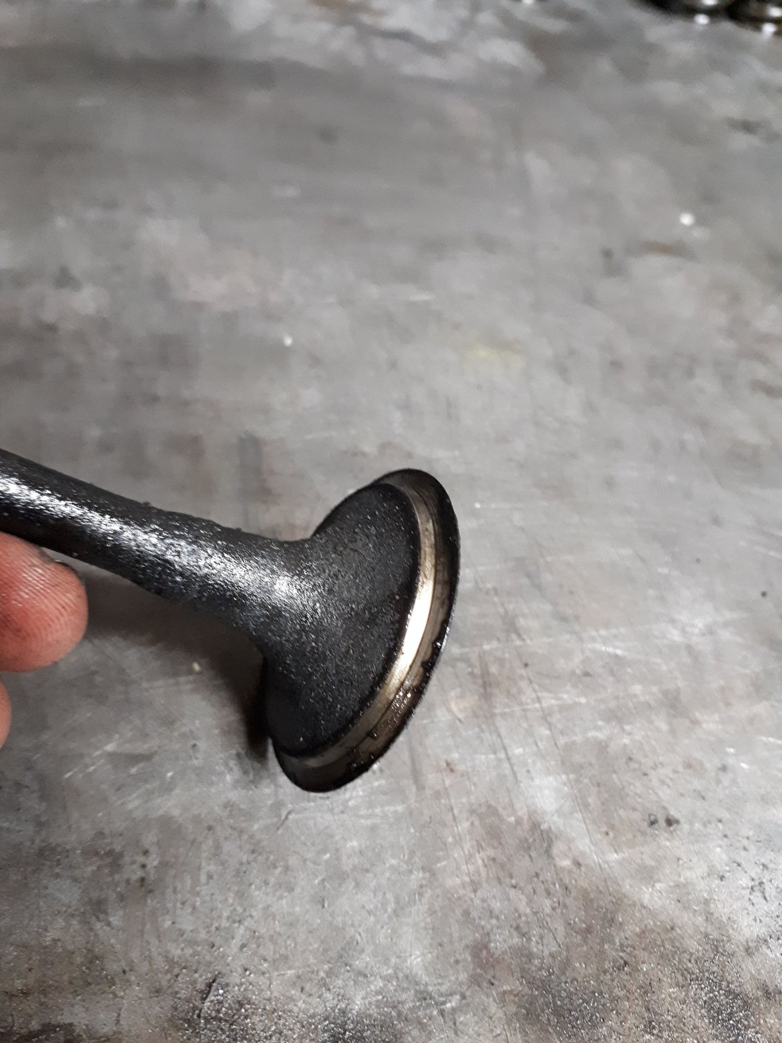

Heres a pic of the pushrod that gave up.
I did find what I think is the problem. The intake valves are completly shot. This must have collapsed the lifter and bent the pushrod. There was a slightly bent pushrod on the drivers side of the motor aswell.
An exhaust valve for comparison. The exhaust valves are pitted but show no signs of being worn like the intakes.
Looks like the top end of the motor needs to be redone. I will probably start a build thread for this truck as im rebuilding it.

wow! looks almost razor sharp!

With the pic being side on it’s hard to tell but is that intake valve (or any others) burned? What is the condition of the valve seat and guide?
I’ve done a few head gasket replacements due to coolant leaks and collapsed lifters but I’m yet to experience any mechanical damage like that.
