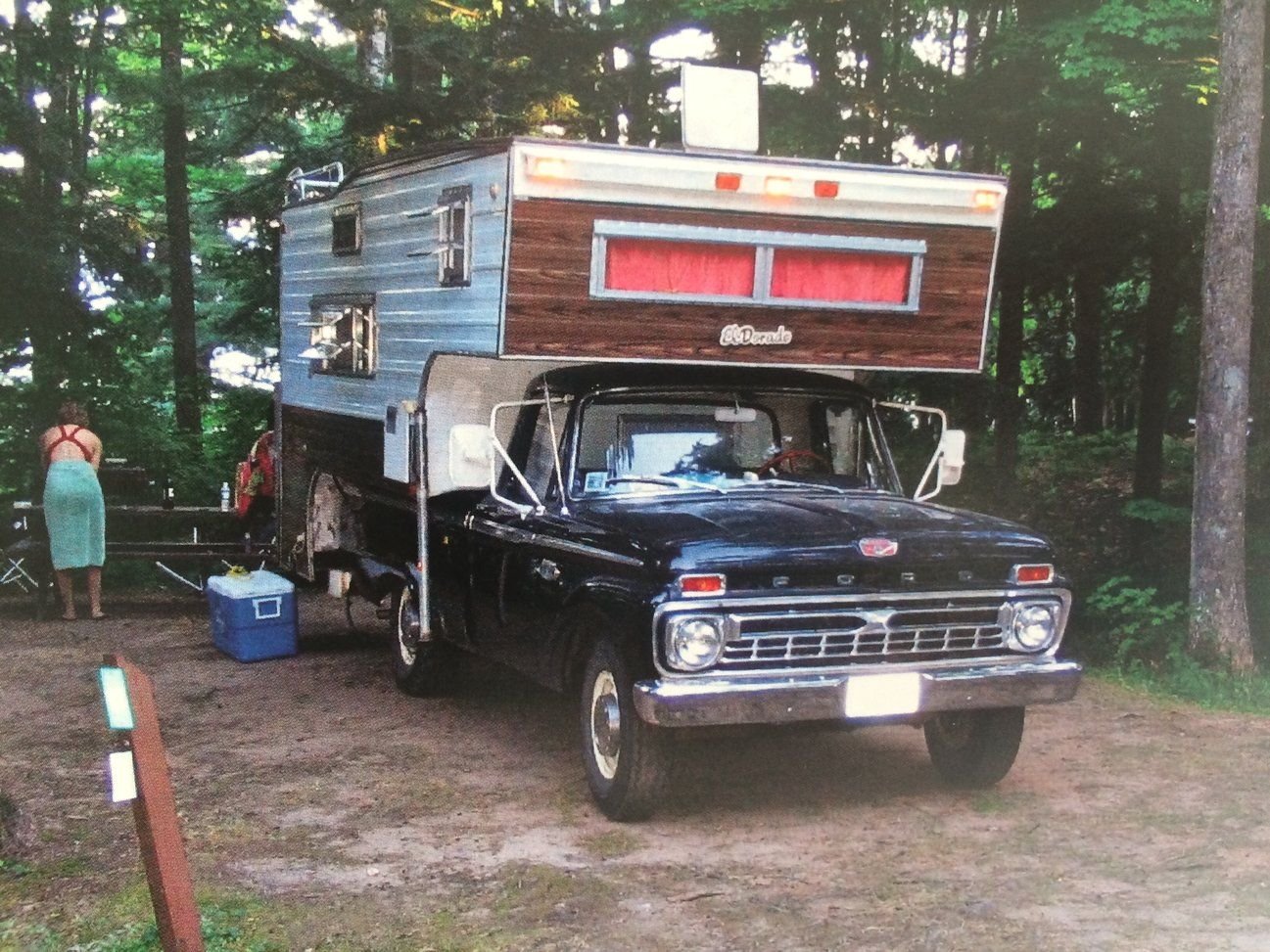

This '66 appears fairly new (@ time of photo), and tailpipe is same as what you've posted. I have others as well that show same. My thoughts are that this is as original, but??
***edit: hmm, based on fender badges, maybe not a '66, and not so original
Looks like a '66 to me.
F100/250 Camper Special introduced in 1965.
Pic below is the only one there is. Same pic as in post #6
