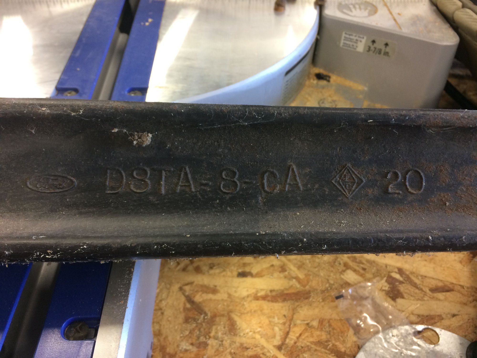

Is there a difference between the ibeams from 1973-79 ? I have a 1975 f100 and a 1978 f150 .
F150, 1978
F100 , 1975

One thing that I know that changed in the ''73 I-beams is the pivot bushing size.

C5TZ-3B177-A .. Axle Pivot Bushing - 2 1/4" O.D. x 5/8" I.D.
1965/79 F100, 1975/79 F150.
D2TZ-3006-C Right & D2TZ-3007-C Left .. I Beams
1971 F100 from serial number M00,001, 1972/74 F100.
D8TZ-3006-A Right & D8TZ-3007-A Left .. I- Beams
1975/79 F100/150.
1975 was the first year that a front stabilizer bar was available for F100/150 2WD
The 1975/79 F100/150 2WD radius rods (D5TZ-3A360-A) are also different than 1965/74 F100 2WD (C5TZ-3A360-A).
