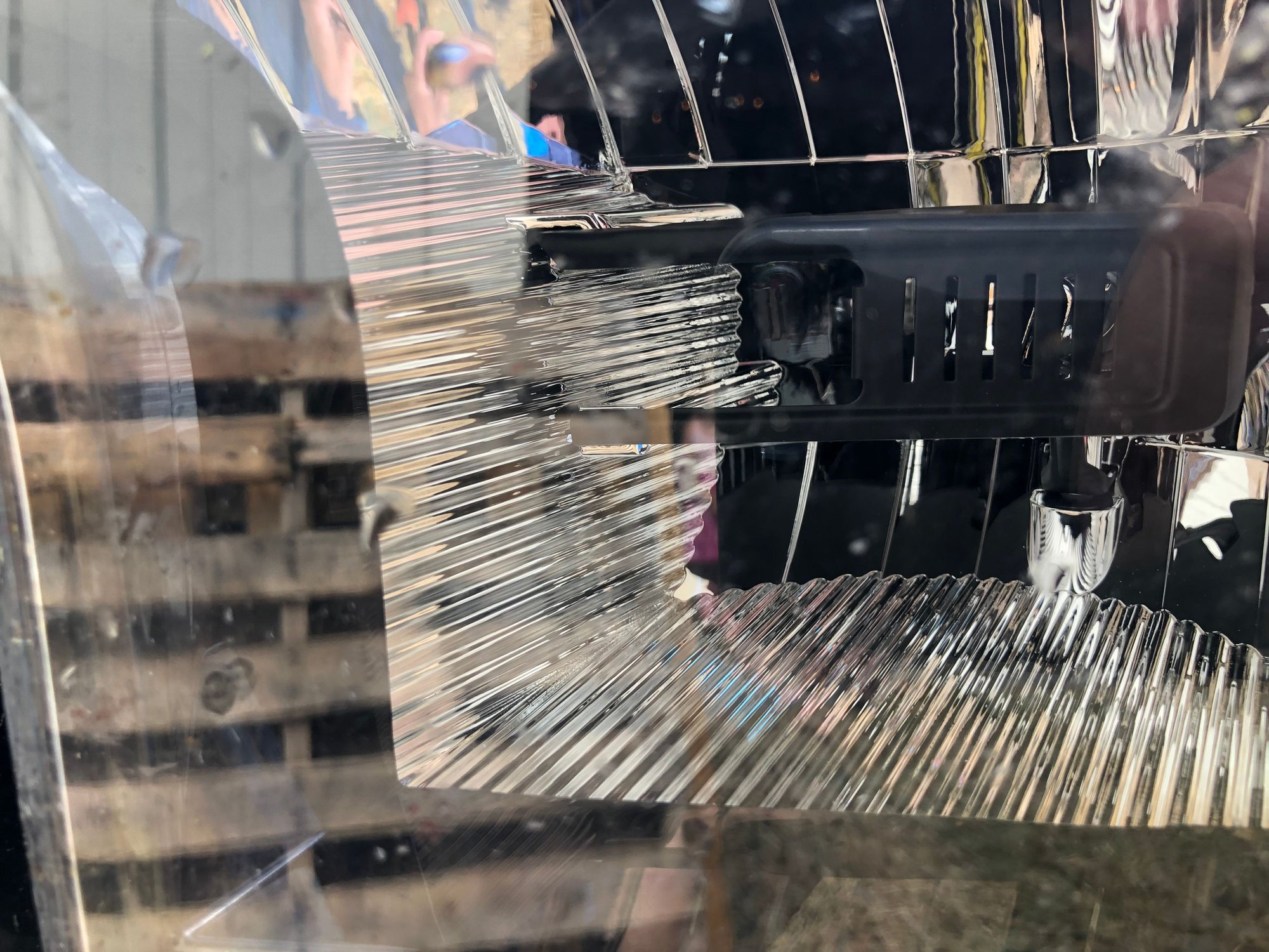

I have a '19 F-350 without the LED headlights. I would like to put LED bulbs in, but I ordered some from amazon and installed and there is a black bulb protector shield within the headlight housing that makes it so that my new LED bulbs will not reflect the light appropriately....making it close to impossible to drive at night. Any suggestions?Thanks

Which bulbs did you buy? Me and several others on the forum have Beamtechs and love them.

I got
Amazon Amazon
does your headlight have the black shield shown in this pic ?

Originally Posted by markit8
I got
https://www.amazon.com/Alla-Lighting.../dp/B07FK78C4V
Yes mine has glare shields as well. Some bulbs just have a worse beam pattern than others. The beamtechs work well.

Make sure the led lights you already purchased are installed in the correct orientation first - flat sides should be facing left and right at 3 and 9 oclock

I was the first here with Beamtech in December 2017. Still have them and will switch them over to the new 2019 I'll be getting this week. Even though you have another brand I have a suggestion. When installed, make sure the LED chips are facing exactly to the 3 o'clock and 9 o'clock positions. Anything else will throw your pattern off.
As far as those telling you not to put LED into your halogen housings, I will only say that I disagree and have been happy with my results. Other than that I refuse to argue about it on an internet forum.
