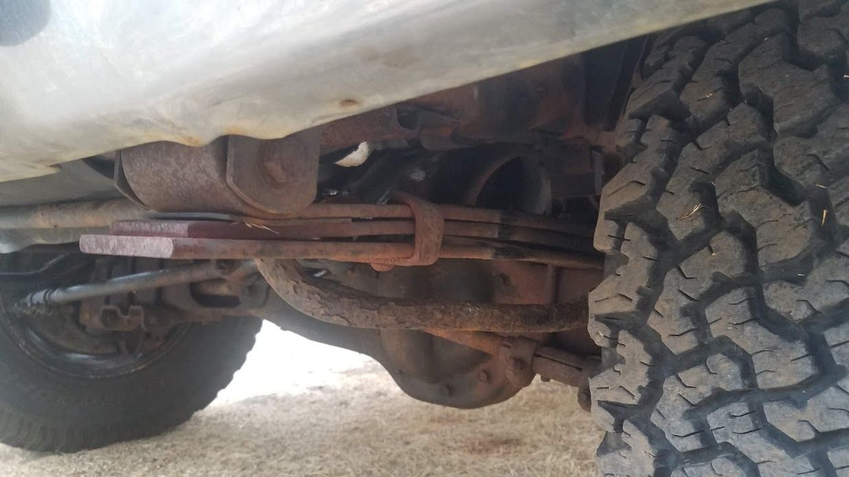

The tires installed are 33X12 R16.5 which is roughly a 305/170-16. Stock size is 235/85R16. That roughly equates to a 1-3/8 of lift just from the radius of the tire.
It also equates to the tire rubbing on the leaf springs when you turn the wheel all the way in either direction.

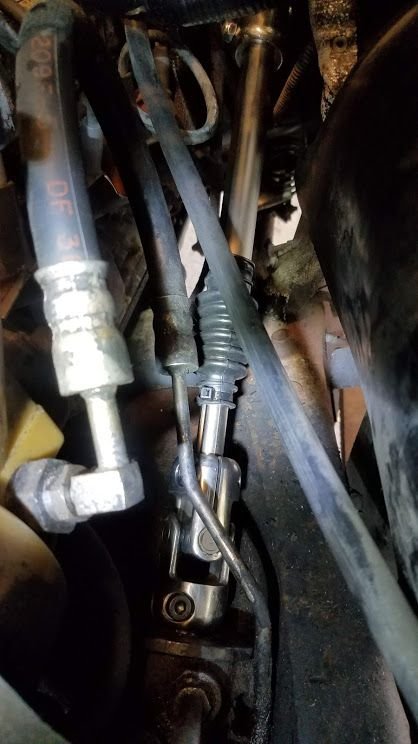

The intermediate steering column is screwed. There's A LOT of play in the steering wheel (almost 60 degrees). I've bought a new one but I haven't installed it yet. The factory ones just don't exist any more so it's one of those cut to length ones.
Rust. Did I mention the rust? I'm not sure there's a component with iron in it that isn't rusted.

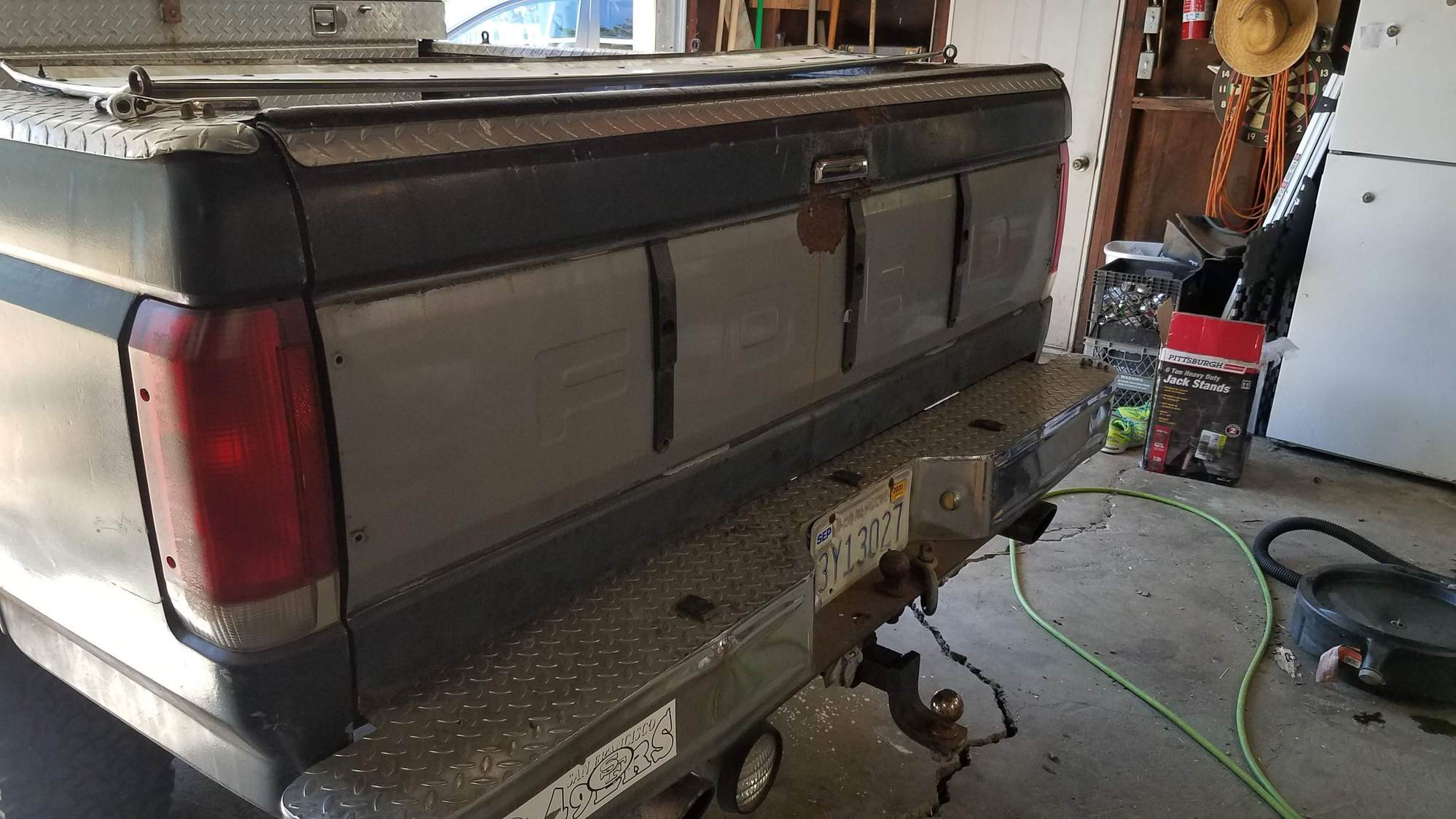

The hitch is rusted solid. I couldn't remove the ball mount pulling on it w/ the truck against a tree.
The frame and most of the hangers seem to be ok-ish.
The sway bars have lost ~0.3mm of diameter (the powder coat I think).

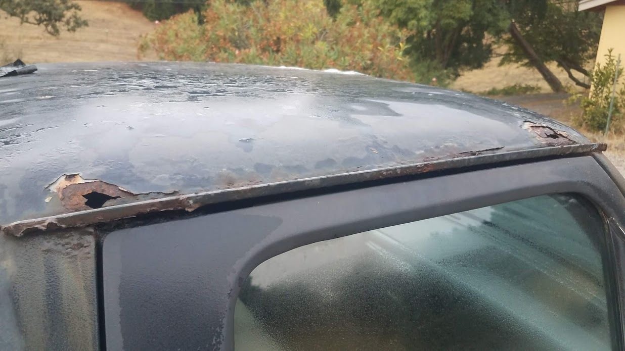

The cab is toast. The bed might be salvageable.

Replaced the intermediate steering shaft with an aftermarket one. It's like I have a new truck!

Getting that ball mount off will be virtually impossible without a cutting torch to heat it up. The rust bond is incredibly strong with tight iron like that. Get the whole outside of the receiver starting to turn red, if you see rust popping off/paint on fire you are doing good. Ideally you will have that rear bumper off to keep the scorch marks down! Keep a fire extinguisher handy and don't hit anything with a beater that's been heated or you'll bend it and then you're screwed.

I hope that works! I don't have a cutting torch but I do have a huge MAPP gas torch.
I think the hitch might come off. but the rear bumper needs to be adjusted anyway so either way.

The frame is actually generally ok. however most of the hangers and components attached to it are rusted out.
The Cab is the worst part. tons of holes. I doubt it would be worth salvaging. I'm on the hunt for a decent cab.
