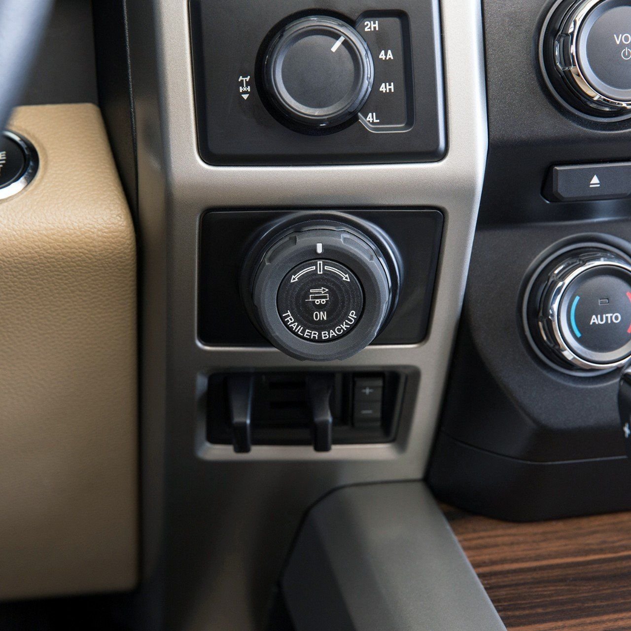

To help find trucks with the Max Tow package, check the interior and look for the factory trailer brake controller and backup assist.
Well, it's possible to have those options without max tow package as well. Really you need the window sticker to know.
To my knowledge, you get backup assist with the base tow package (level above trailer hitch) and TBC can be added as individual item. So you could have both and not max tow.

Those options might be available as separate items, but trucks with both of them are more likely to have the max tow package.
