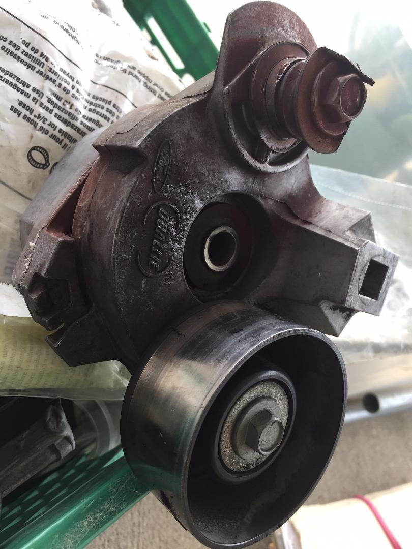

I was in the UP of Michigan going 65mph and heard a bang. Battery light came on and no PS so I pulled off. I found the pulley gone on the SD double pulley set up mod that I did. Three years ago I thought I heard a squeaking noise coming from that area so I replaced it. I had that one in my 'extra' parts bin thank goodness. Another lucky thing is that the pulley didn't go thru my radiator!!

About how many miles on the broken one?

Three years and 30K miles. I've heard of repacking these bearing but I don't know how to do it. Have a picture?

I didn't seem to matter how fast I got pulled over because the belt was shredded and the pulley was gone with the wind. My wife saw a smile on my face and she said that I was happy because I could work on my truck. I told her that I was happy that I had the part to fix it and get off the side of the road! In twelve years of six month 10K mile trips I've been on the side of the road too many times but what do I expect with a 22 year old truck?

I do have a bunch of spare parts with me. When it happened I couldn't remember if I had brought it along but sure glad I did. Got the new one from Clay yesterday. Thanks Adam!

That's for sure John, after getting the old part and serpentine belt out of the camper I was delighted. Man that motor was hot to work on!
