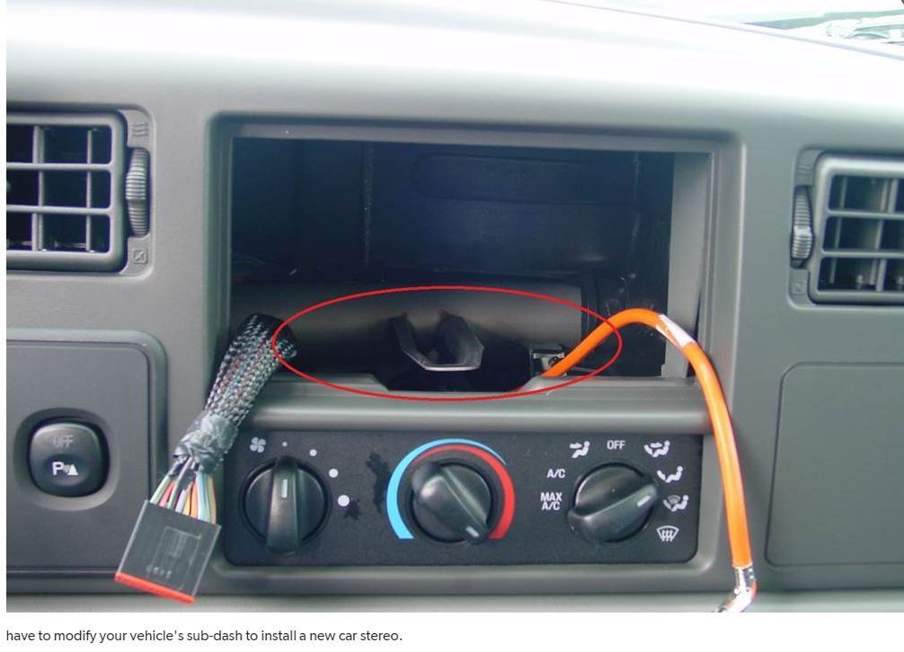

Old Aug 28, 2019 | 05:51 PM
jjriley97's Avatar
jjriley97
Joined: Mar 2019
Posts: 541
Likes: 37
From: Tulsa, OK
This is a pic from Crutchfield's site. The circled area is probably what is missing.

I'd pull the radio out and see if anything had been modified first. I replaced the OE radio with a double DIN unit in my 2006 and didn't have to modify anything to get a good fitment. Just hope they didn't screw the wiring or plugs up when the aftermarket was installed

I'd second what kgburns said. You won't know for sure until you pull it out.
