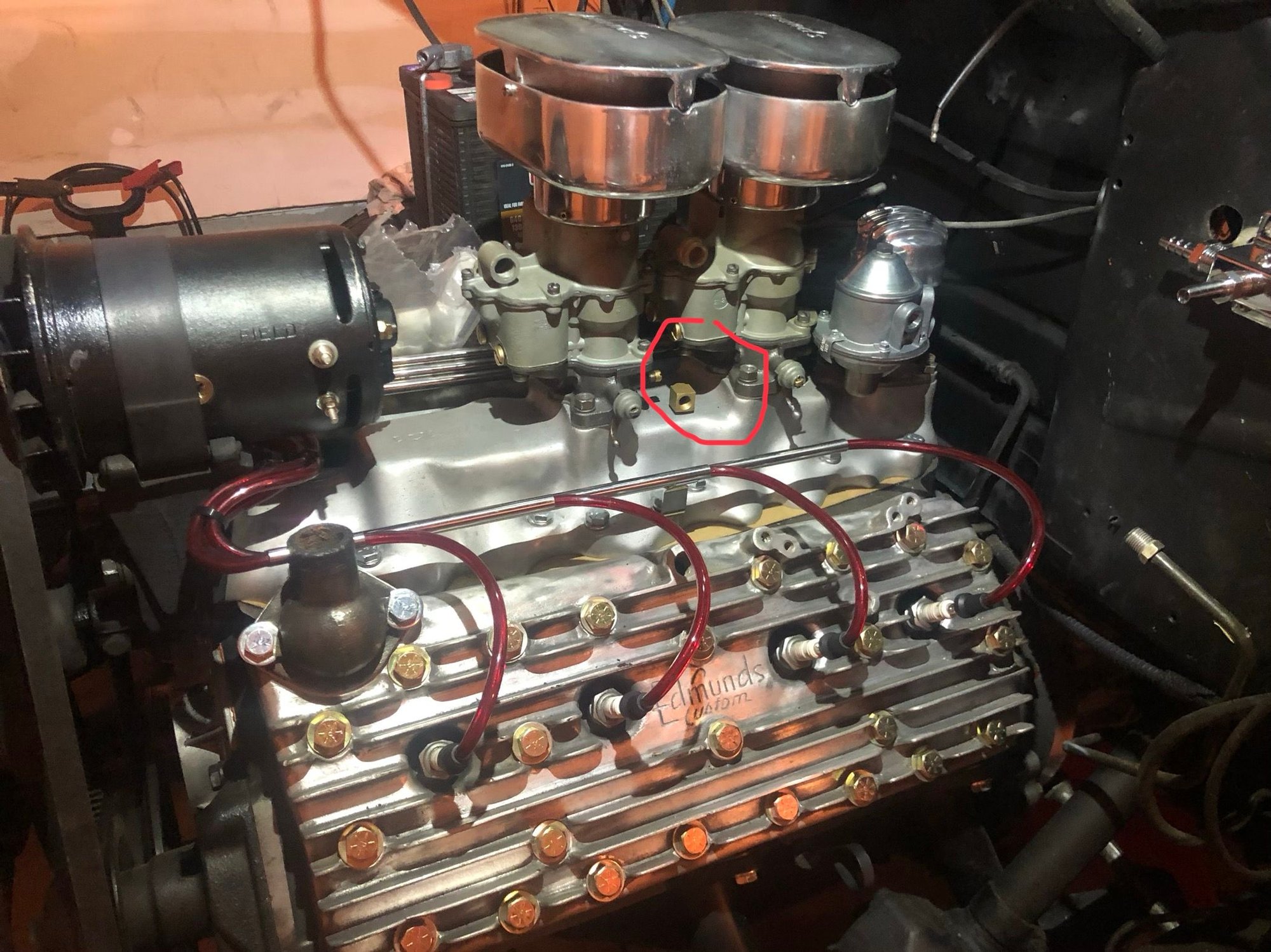

So I’ve put the engine back together in the truck
new /old Edmunds heads and intake manifold
can some one let me know if this is the vacuum port off the manifold ??

The brass fitting? It appears to be tapped into the manifold plenum, near as I can tell from here. If so, that would be a full manifold vacuum source.

Yes the brass fitting.
Ok so that vacuum line will run to the vaccum line in the distributor ??

probably not. The distributor vaccum line is connected to a port above the butterflies. Manifold vacuum pulls the hardest at idle. If the loadamatic dist works correctly with dual carbs, is another question.

With dual carbs, you will have to change the power valves, too.

When hen I bought this intake manifold it came with the carbs already.
I sent everything out together rebuilt. So I’m assuming the power valves are the correct ones for this type of application

... If the loadamatic dist works correctly with dual carbs, is another question.
It won't work properly with dual carbs.

So you guys saying I have to switch to an MSD ignition system ?
im still on 6V any suggestions

The stock distributor provides advance by a calibrated vacuum signal from the stock carb (only). When you go to two carbs, the signal is too low to do any good. Your options are to go with the MSD ready-to-run, a converted GM distributor with mechanical and vacuum advance, or any number of cheap chinese copies of the MSD.
