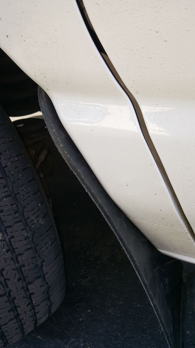

These are screwed on
I couldnt find anything that would work for me... So, I went to NAPA and bought two semi truck mudflaps. I think $12.00 each.
I cut them in half from top to bottom and mounted with self tapping screws and washers. They did the trick and have been a successful addition for over a year in the Pac NW weather.
I mounted them so they would stick out a little. REALLY helps with the wet road flying up all over the van!
Mike
Mike
Also thinking in that direction as well. I'd be mounting mine at the rear of each wheel well since the flying debris tends to travel backwards anyway. At the bare minimum I'll use some of the 3M paint protection film for the lower rear quarter panels.
Also FWIW I've considering making plastic inner fenders for the rear wheel wells--a "shield" of sorts from the road crap flung against the body both upwards and to the rear. I could do that easily enough but it would require drilling holes---which I'd promptly treat with POR-15 before installing the pieces.
Thanks guys---good advice!
