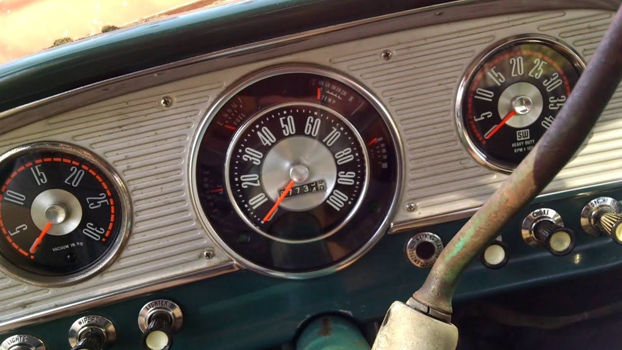

Since you guys instantly found the lower SS switch panel, I figured it's been 6 months, maybe someone knows where the chrome instrument bezel may be hiding.

I don't know what you're asking for but I like your tach and vacuum gauges!

..your photo shows a multitude of things that would be described as instrument bezels. What are you looking for??

the chrome and white piece that the gauges mount to.

There are several instrument panels on ebay, for example:
https://www.ebay.com/itm/1961-1966-F...oAAOSw9yZdTeM7
If you want chrome and white, you will have to have the entire panel chromed and then scuff/sandblast the area you want painted. The perimeter is not removable.

Thanx Bill, I have 2 nice painted ones, so if I have to I'll drill one for the tach and vac gauge and have it chromed.

Where did you find that tach and vacuum gauge if you don't mind me asking? I really like that look.

The vacuum gauge I took out of a 67 f600 I owned years ago, I just bought the tach a year or so ago for THIS PROJECT. When I get home tomorrow I'll see If I can find where I bought it. I think I have the link in my computer at home.
PS. If I recall correctly the vacuum gauge came on large trucks with power brake boosters on the frame. Probably wouldn't be too hard to find since not many people restore the big trucks.

Thanks for the info. Yours is the second one I've seen with those in the dash and I have been searching only to come up empty. I did find a vintage tach, but it is mechanical. Are they all mechanical and how hard would that be to integrate in?

Yes, all of those tachs are mechanical. You would need a distributor with a tach drive and the cable. The FT engines may have used a larger oil pump drive shaft, so you might not be able to just swap one in, but there were FE distributors with a mechanical tach drive, or you could send out the FT distributor to be rebuilt with an FE shaft by pressing in new bushings. The distributors come up on ebay all the time, but I rarely see the cables.

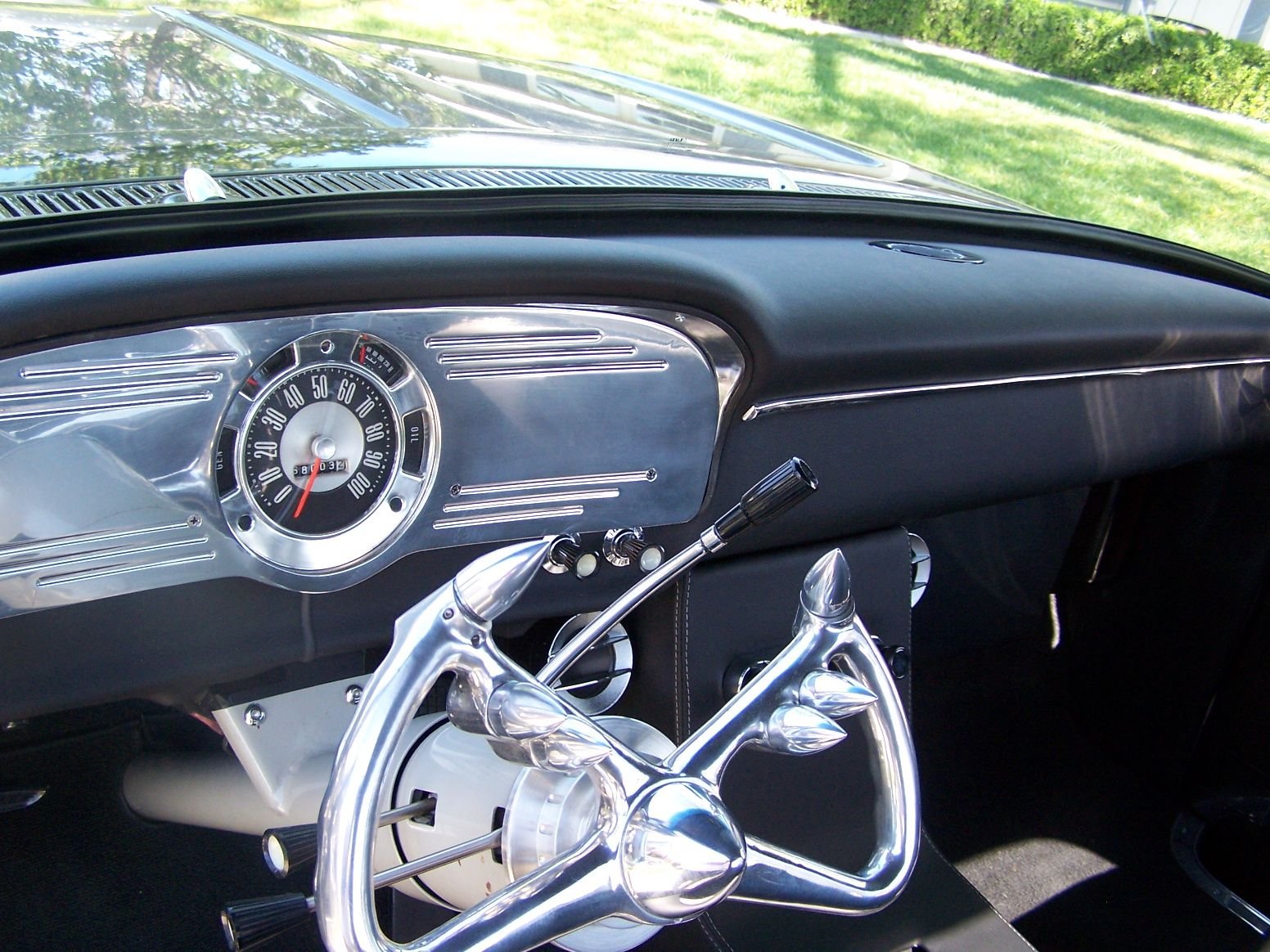

Chrome Instrument Bezel
So here's my Chrome instrument bezel.
