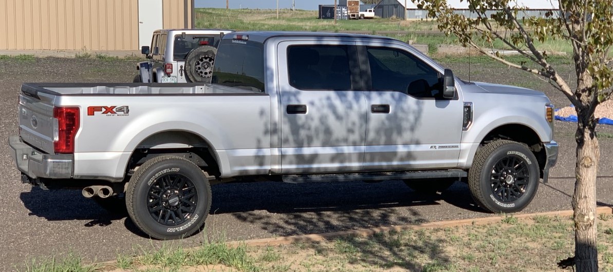

Old Aug 19, 2019 | 10:59 AM
HST's Avatar
HST
Joined: Oct 2003
Posts: 463
Likes: 43
From: COLORADO, USA
I just found some 2017 F150 running boards with brackets and sold my stock ones all of craigslist. I actually made $100 after it was all said and done. Install is very straightforward. Much better look in my opinion.

Old Aug 20, 2019 | 08:37 AM
HST's Avatar
HST
Joined: Oct 2003
Posts: 463
Likes: 43
From: COLORADO, USA
Originally Posted by satz28406
Do you have pictures you can share?
Sure - Name:  4Co3V03.jpg
