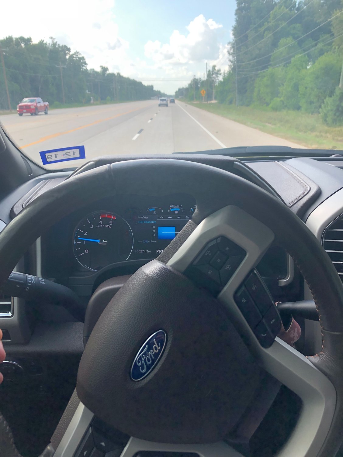

My '19 has 7200 miles and HAD been flawless. Until the adaptive steering started malfunctioning. What happens is: after having been on a longer road trip for a while, the adaptive steering will decide to clock the steering wheel off center in any direction right or left up to 90*. This is extremely un-nerving when this happens running down the road at 80 mph. It can also do it after being stopped for gas or whatever, then re-start and boom there it goes. The adaptive steering alarm icon pops up on the dash and the steering wheel stays tilted one way or the other. The condition will clear itself when the truck sits overnight, then the steering wheel will revert back to correct position and stay good until the next road trip.
The steering wheel has an on-board computer, a gear box comprised of a worm gear drive on a PLASTIC gear and an electric motor to turn the worm drive gear. Feedback for the computer for position sensors are two wires under the column shroud connected to the clockspring which acts as a rheostatic resistance that the computer reads to deduce the rotational position of the steering wheel. The computer compares that to net degrees traveled and adjusts output to the electric motor to advance the steering gear and increase the wheel rotational position which reduces the effort required to put the steering wheel where desired for a given turn.
OK all well and fine except: the computer is intermittently malfunctioning on road trips (i.e. getting too warm?) and inadvertently changing the wheel position using output to the electric motor to drive the wheel position. What I don't exactly understand is why the steering wheel can change position so radically, yet the wheels will stay aimed straight ahead or if a turn is initiated, it will still steer, just the steering wheel is cocked way off one side or the other. Which REALLY SUCKS. Because there is no way to know when or if the steering is going to let go completely.
Anyone else out there had / have this problem with the adaptive steering? I definitely do plan on swapping out the steering wheel if I cannot physically remove the electric motor, gear box, and computer from the existing stock steering wheel. Also will have to de-terminate the two wires going to the clockspring under the steering column shroud. Need to know if possible and how to disable adaptive steering in forscan. With adaptive steering, 100% of the steering control of the truck rides on that cheesy pot metal worm drive gear, and the PLASTIC gear that is the only interface between the steering column / front end and the steering wheel. Period. And obviously the computer that controls the scheme is failure prone intermittently because I am seeing that happen in real time.
So the way I see it, I either have to swap out the steering wheel, or physically eliminate the adaptive steering parts, or trade the truck off and get an XLT which does not have adaptive steering. Then of course I will have to do without factory LED headlamps. This issue is too serious in potential liability if the steering goes out completely driving down the road at highway speed.
I know I can change out the steering wheel and eliminate completely the electric motor, the gear box with worm drive gear, and the plastic gear it acts upon, and the on-board computer. All fine and not hard to do. I will need to disconnect the two wires running under the shroud to the clockspring. I do not know if the control and the resultant alarm status can be disabled in forscan.
I wish I had ordered XLT which does not have the adaptive steering and possibly not the adaptive cruise control. Also would lose the heated and cooled seats, I use all the time. If I have to, I will swap out the steering wheel to get a hard connection between the steering wheel and the steering column, because this is a safety issue and is quite serious. I may have to live with the adaptive steering alarm on the dash. I can only hope that there is no other interaction between adaptive steering and other functionality related to control (throttle / braking etc.) plus the ford dealereship will not change the configuration of the truck from stock so I will have to do this myself. Or trade off the truck to get an XLT which will lose me a lot of money. The dealer says the steering wheel will have to be changed and they are currently on about an 8 week backlog. So apparently my truck is not the only one affected. The parts guy looked up any TSBs on this and said there was none.

This is the adaptive steering with electric motor. I ordered a replacement Lariat steering wheel without adaptive steering or cruise control to replace the one in my truck. Still need to find out how to disable the adaptive steering alarm that will show up permanently on dash when I do this. Any help from forscan gurus def appreciated.

I have had it happen mostly at a new start up after a brief stop. But also while driving down the road. First time that freaked me out completely. I had no idea what the heck was happening.

It’s happened only this time and it was at start up. I was parked with the wheel turned somewhat right, and on an incline. I was at my parents house having Sunday dinner and when I turned the truck on it threw a bunch or faults and steering stayed way off. Drove thru the neighbor and saw that outside of it being way off center, the truck still responded the same way to turns. So I said screw it and drove home. When I got in it just now, it’s back to working fine. go figure... on to the dealer it goes ..
