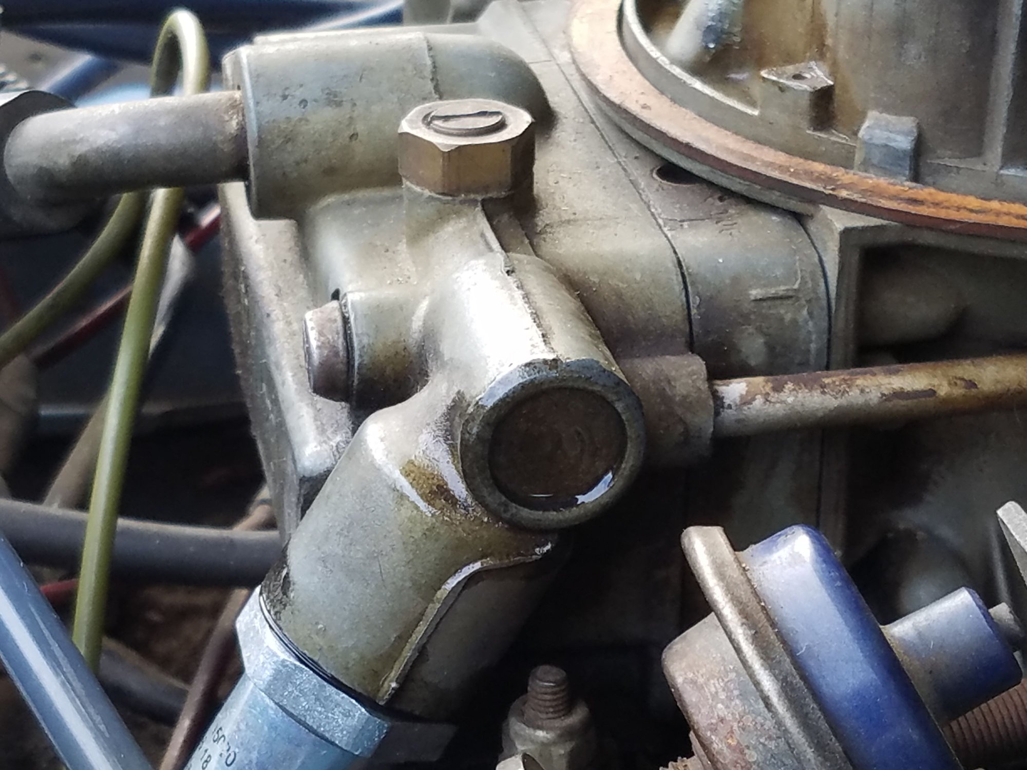

Well found a new leak, this one by the fuel filter. Not sure what this is called a "cap" I guess.
The Holley manual doesn't show it as anything parts wise. So can it be fixed?
Weeps enough to cause a drip on the intake.
Also installed a new wix fuel filter, the old one was leaking at the gasket, well so is this one..
Not as bad but I don't dare tighten it down anymore for fear of cracking the carb.
I'm not sure if I should try and replace it with another gasket or live with it.
It's not as bad as that plug/cap I'm showing in the picture.
If I knew of an epoxy or something gas resistant that actually works I think I'd just smother it with it.
Anyone know of something?

At work we've always used JB weld to seal plugs like that that are inside carburetors that results in the bowls draining into the engine. mainly the soldered plugs on the quadrajunks. You would have to clean it quite well then take and fill the area with some JB weld. You might be able to try some of the two part epoxy, I think JB weld has some that is fuel resistant now. I don't know if the one I got is but I used it for repairing a hairline crack in a obsolete choke thermostat that you cant buy anymore. Set up fairly quick which would work good for you being its vertical.

And if what Rusty posted does not work you will need to replace that float bowl as that is the only way that plug comes.

JB weld is epoxy, I would try it. That is a hole they use at the factory for machining the carb body, and when they are done they permanently plug it with that plug.
This link says it's resistant to gasoline.
https://www.jbweld.com/pages/faqs

P.S. I would fix the plug leak first, and then see how bad your other leak is.

Yep it is, I don't know what to call the other stuff JB weld has, they have the traditional that you mix the paste together then they have the glue like stuff that is in the two part epoxy syringe that you press down on the plunger it gives you proper mix ratio and you mix it and spread it. This stuff is a bit runnier than the old JB weld that is a bit more sticky and paste like.

thank you, didn't really think about going the 4180 replacement, thought about just replacing it completely though.
I forgot I had some quiksteel from blue majic laying around from when my 79 had some pinhole leaks.
It worked for a few months on it but eventually let go. Probably due to user error, didn't get it cleaned enough, still was dripping gas etc.
Anyway I used what I had left and so far it seems good to go.
I don't expect it to last long though because that stuff was a bit crumbly.
